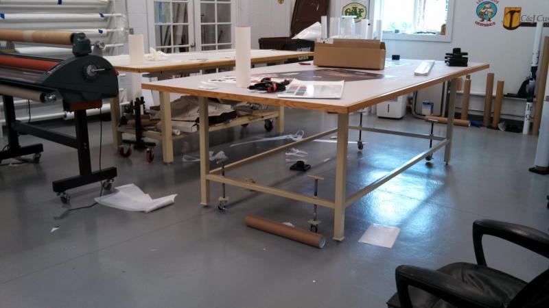

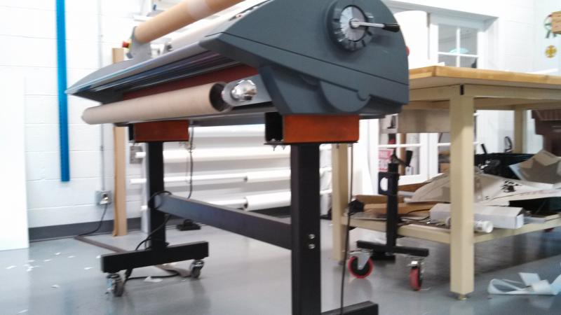

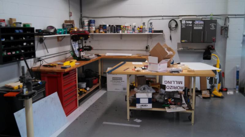

yup overhang is a must i clamp to my tables every day also the self healing mat or something of the like is a good idea here are our tables they are all different as each time we learned sizes are 4x8 5x8 and 5x10 the "dirty" side of the shop has 4x6 and a corner work bench ... i am 6'2" so we built our tables to 39" tall and we raised our laminator with steel tubing... i need to clean the shop lol
