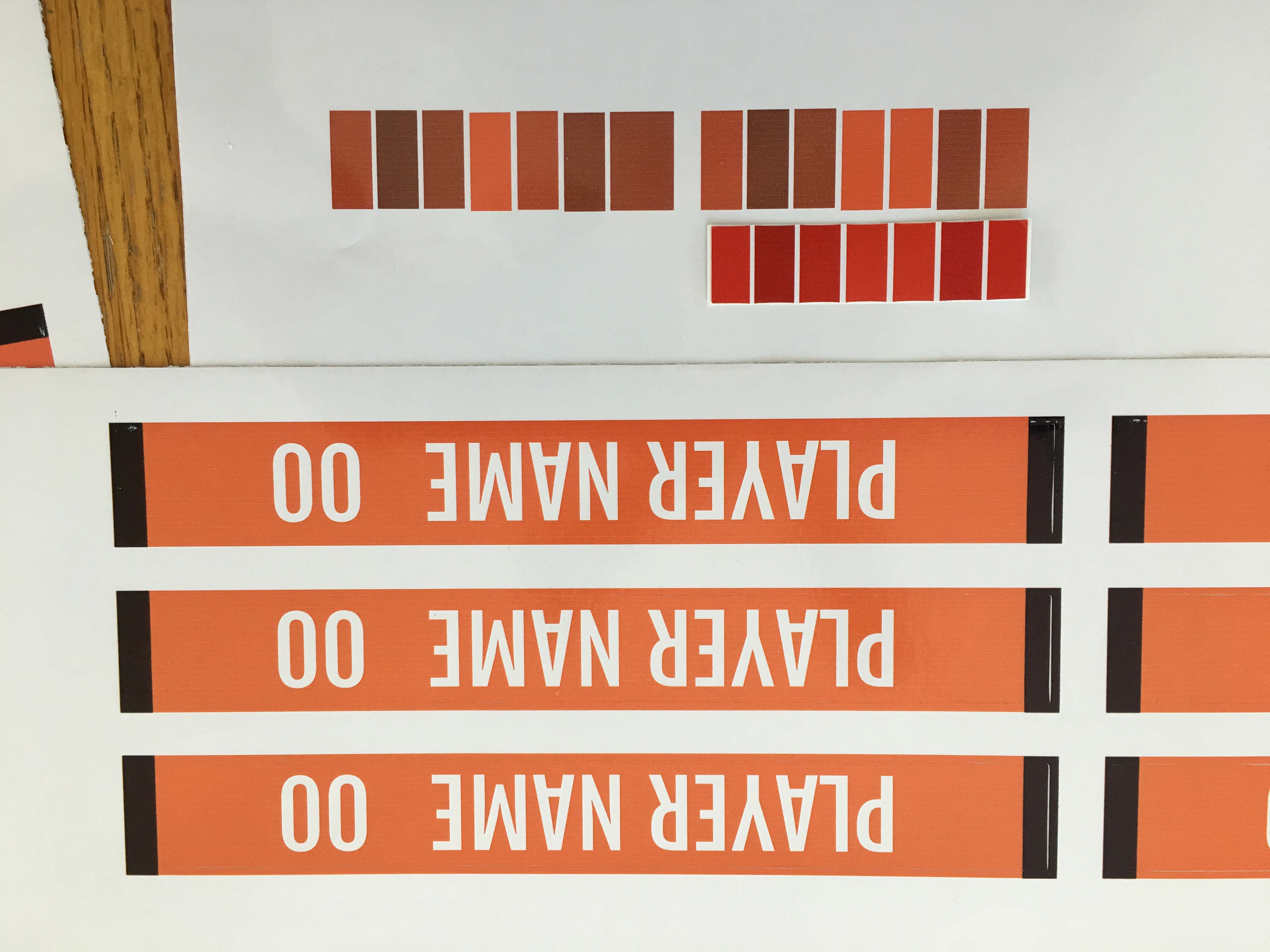

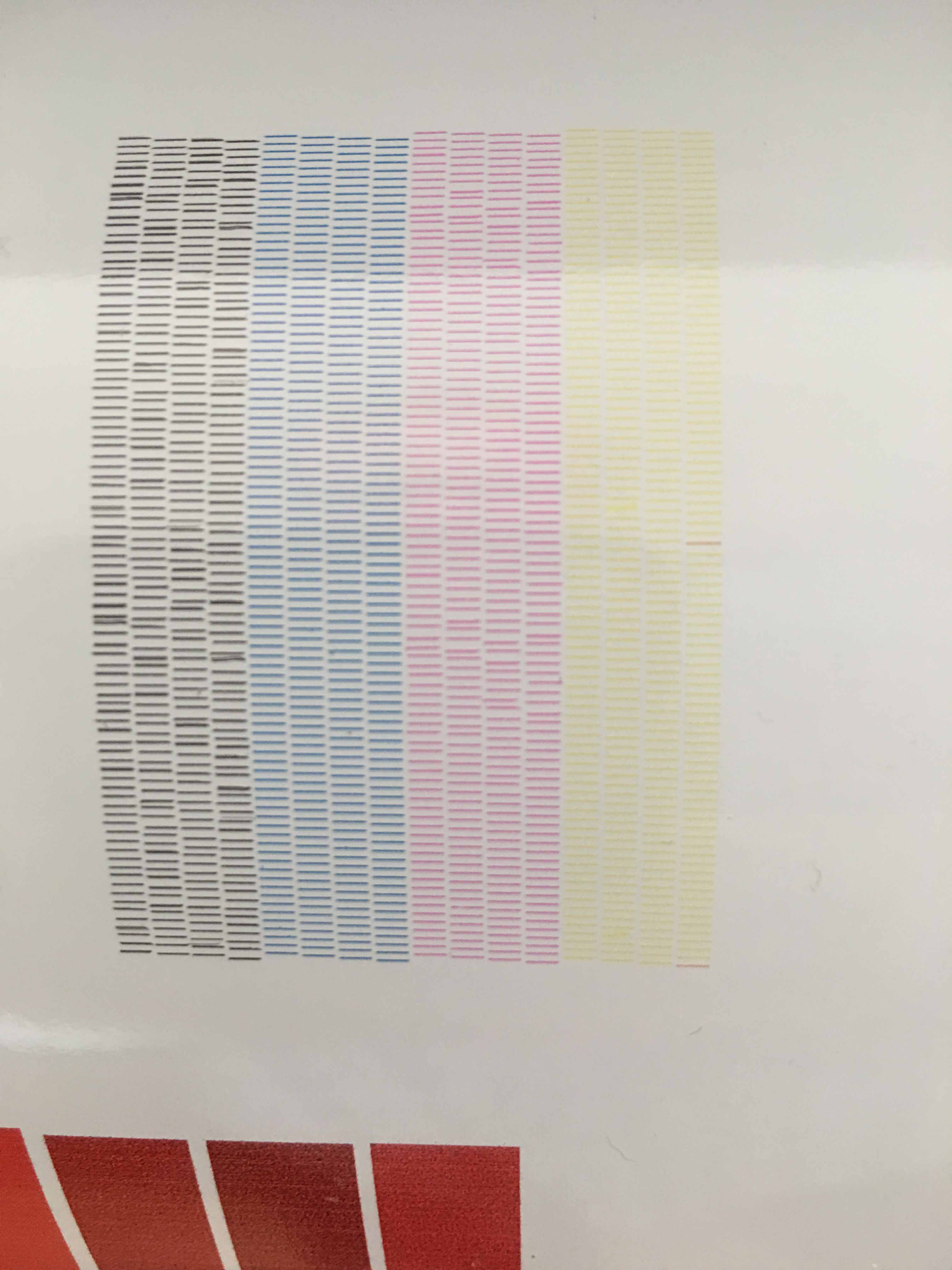

I have done some colour match prints for an upcoming job (this week). however I just went to change some colours and I realized everything is off. I have cleaned machine, switched profiles, switched medias printed same files etc. all of my reds are printing orangish pink browns. test pattern has not changed in months either. also tried switching from sign, prepress, max impact etc. Im at a loss and this is now a rush job for a new client.
Any suggestions would be greatly appreciated

As a quick fix, you can open the file in versaworks and change the output of the color to 0,100,100,0. When I had this issue versaworks was changing the output cmyk mix giving me an orange color.
Since I switched to 3M profiles, this does not happen.

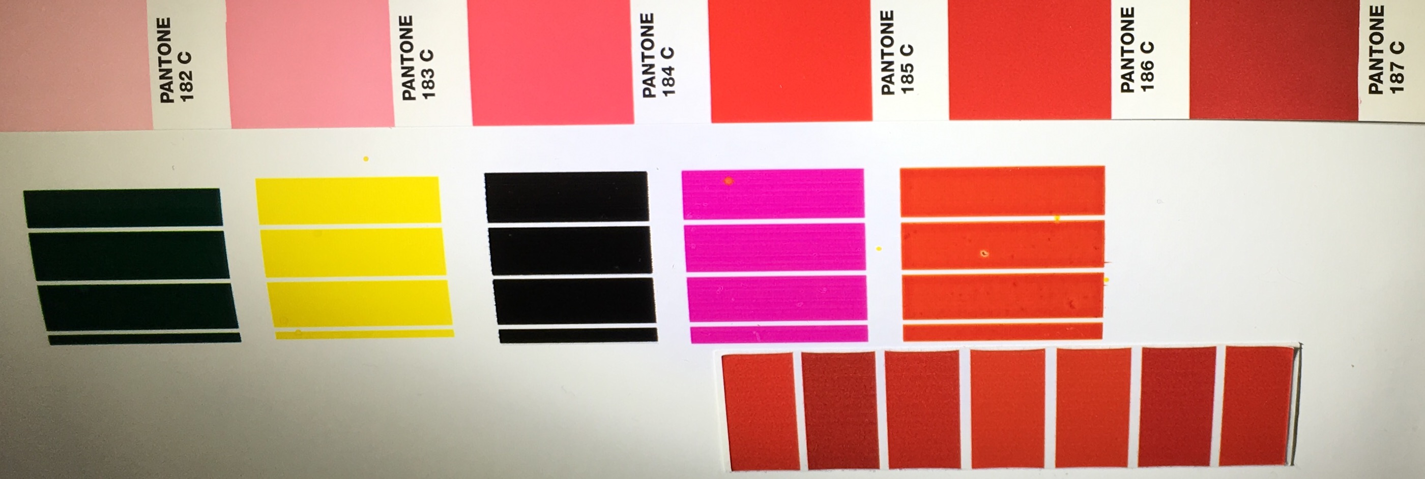

I'm actually trying to use Pantone and cmyk equivalent. However this 7 colour swatch is cmyk. It's the same file, same vinyl etc. even the black is lighter. I will try to enter a special colour but was wondering how to do it. I have printed versa colors but turned away from them because everything was off blues were purple etc. thinking maybe it was something wonky with my printer, possibly!

Actually this was a colour match of swatches I was doing, Pantone 186c it looked way off so we decided to revert to the cmyk swatch I had printed for samples. No change to file, I'm not sure if versa updated in the background it's set to manual. Printer is printing decent pattern and cmyk test print just reds are not popping it's like they are sun faded. I'm thinking it has to be software related because everything else is looking good. I have tried many profiles and switched media too!

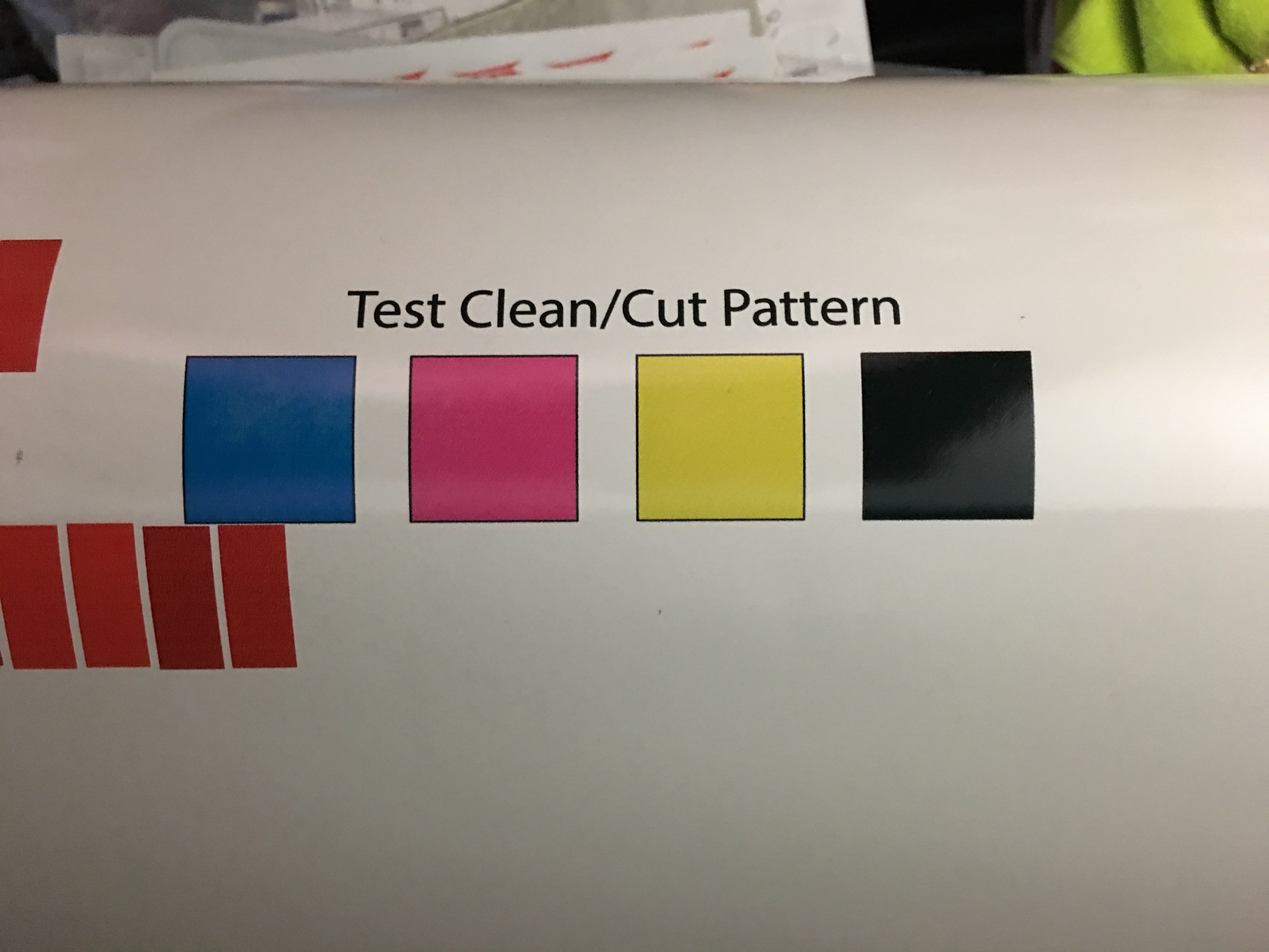

This was a reprint, already ripped and same media printer is printing decent pattern and good cmyk test print.

Here is a print from flexi , red looks better but it's printing white lines like boxes no profiles added

I know what is wrong, i had the same problems with my old sp-540v
First of all you can never leave your printer unplugged, it needs to be plugged at all times so that it can make its cleaning cycles.
What has happend in your case is that colors have been walking up in the wrong channel in the printheads, what you need to do it to try making a few heavy cleanings, this will suck out the ink and if the ink dod not walk to far in the wrong channel this might be enough, if you get your colors back go ahead and print, if the issue comes back or the above dont solve your problem, uou need to change the cap stations and dampers
garleness

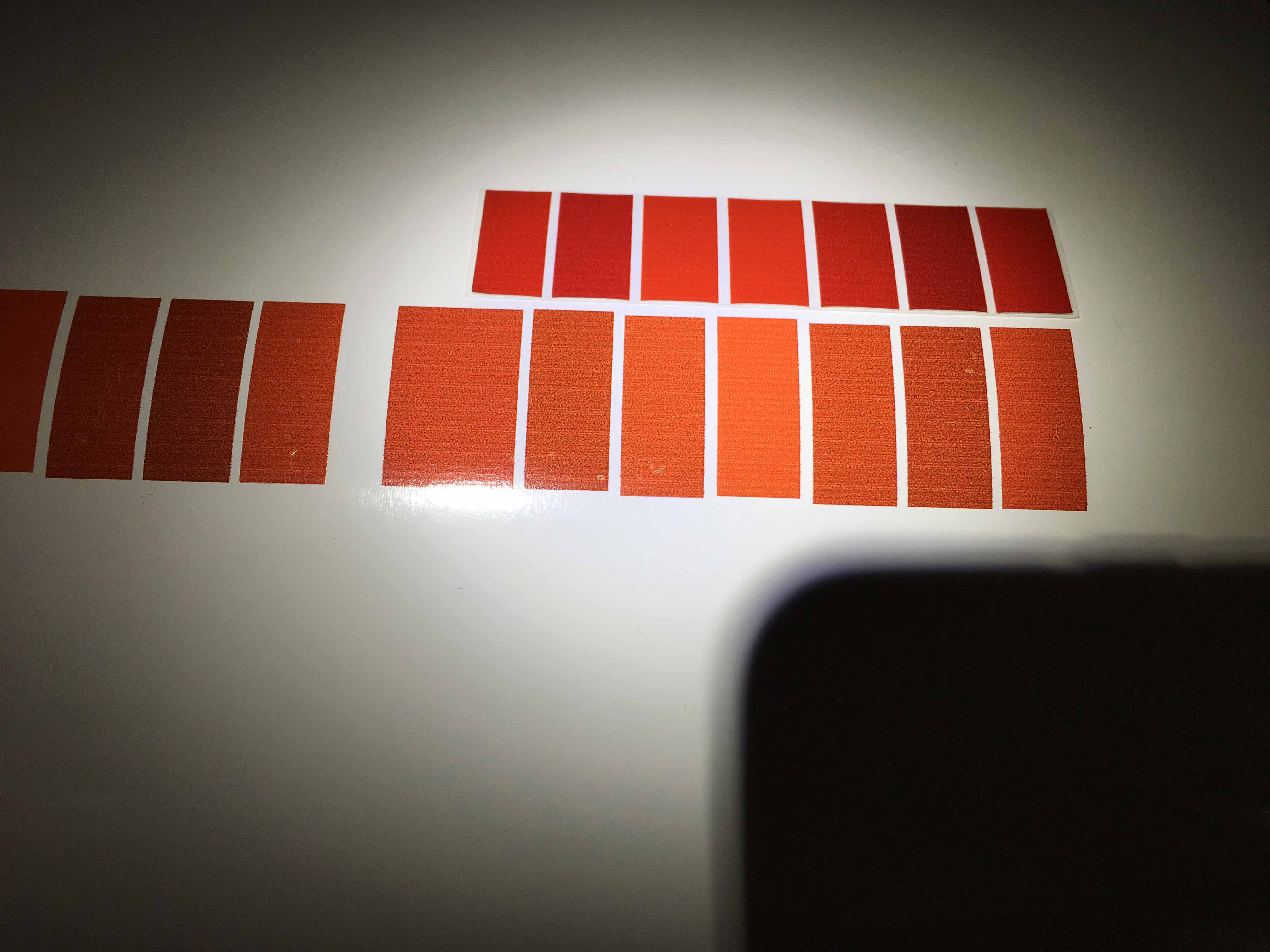

I did do a powerful clean, and then another manual clean. I performed a reprint and I do have cmyk red. Client said it's orange but that's better than brown. This was the second manual clean that I performed that day. After the reprint my magenta cartridge needed to be replaced, thinking maybe it was a combination of things, including possible file corruption. I talked with a rep who had me print a picture. It was good, little dark but still good even the red coat my son was wearing. Job has been held off till Monday. I'm hoping I have a fresh start.
Printer was only unplugged for a few hours to see if it was software glitch, possible power outage when I'm not home. Before you ask, yes it is on a battery back up UPS.
Thanks for the input I will keep my eye on that.
Just continue making heavy cleanings followed by testprint until your colors are good again, if they become good and then the day after its again mixed up you need to change cap tops
