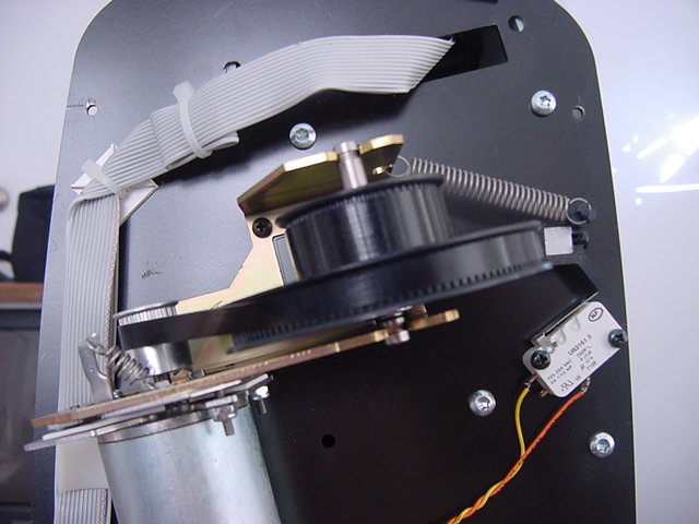

I have finally bought my Summa D60 from a guy on eBay. He said it was Like New, and it does look like it was seldom used. However, under close inspection I noticed that it probably fell off his desk at some point because one of the brackets that hold the media support rollers has a slight bend in it. It seems to be slightly bent to the left, but not bent up or down at all, meaning that it is still level. Do you think this will affect anything? I can straighten it if necessary.
Also the right plastic cover that goes over the motor, has one of the molded in screw mounts broken. I can fix that pretty easy, and you can't see it at all from the outside, but when I took the cover off to look at why it was loose, I noticed that the little belt that is driven by the motor didn't really line up with the other pulley. It seems like the pulley that is mounted on the motor is a little high and needs to be lowered.
Can someone with a D60 let me know if this pulley should be lowered?
Here is a pic...

I gave them a call concerning the things mentioned in the above post, and it turns out that the pulley on the motor is upside down.
