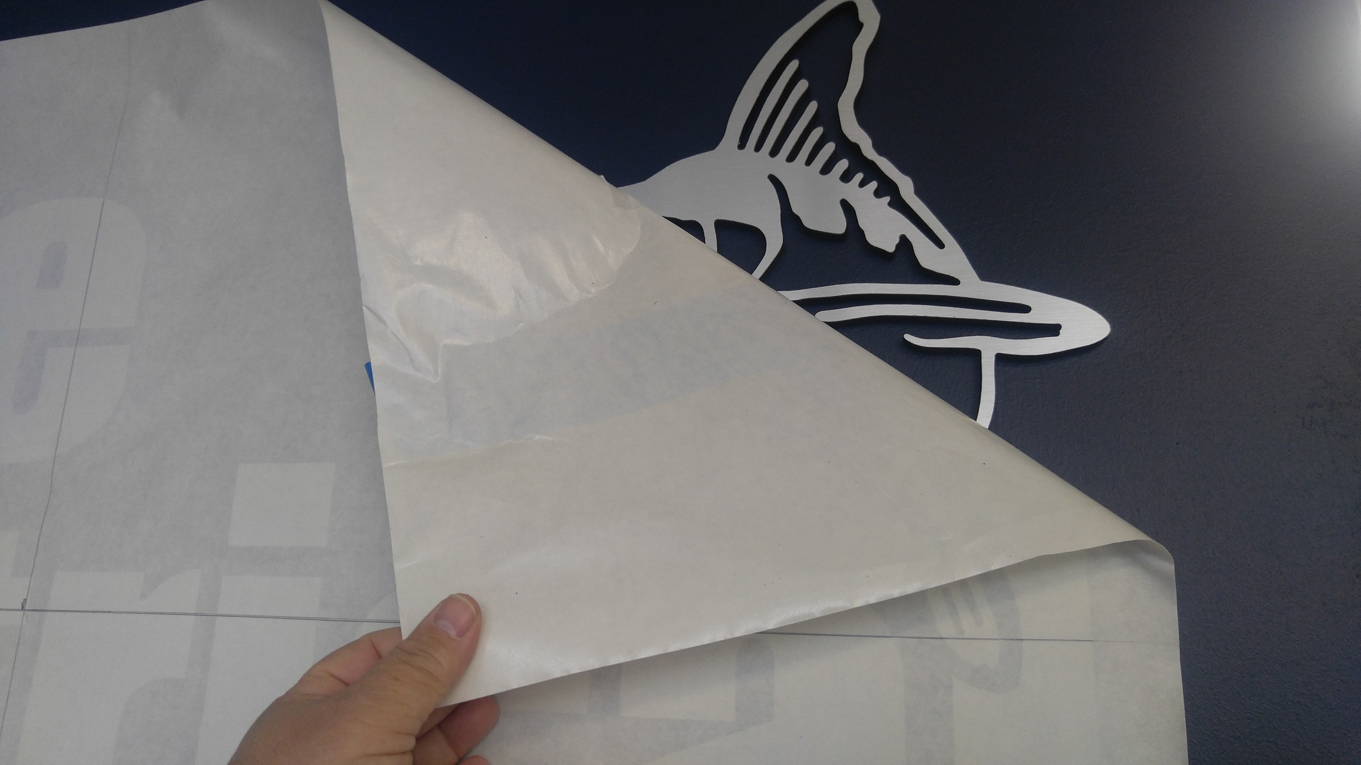

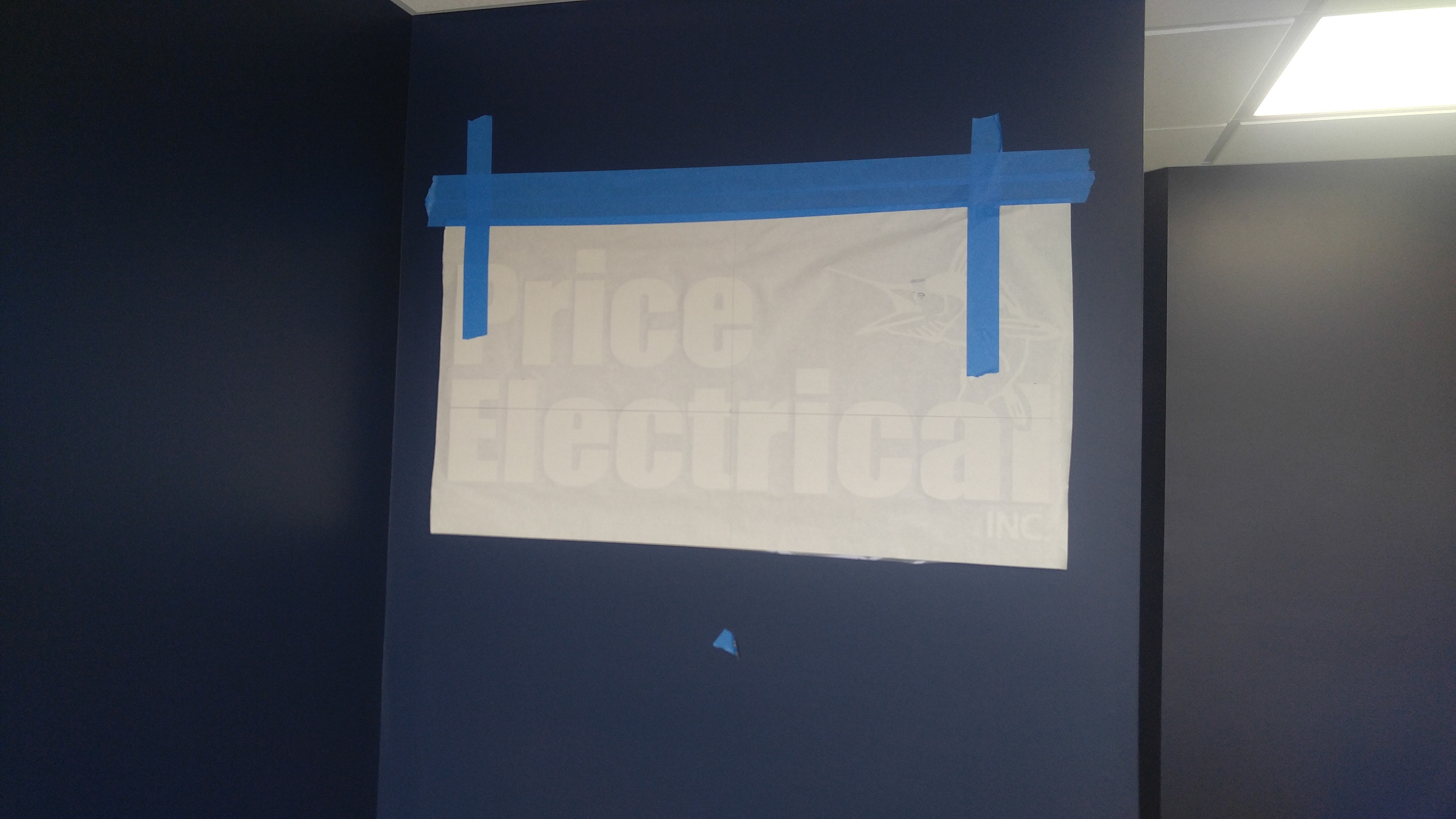

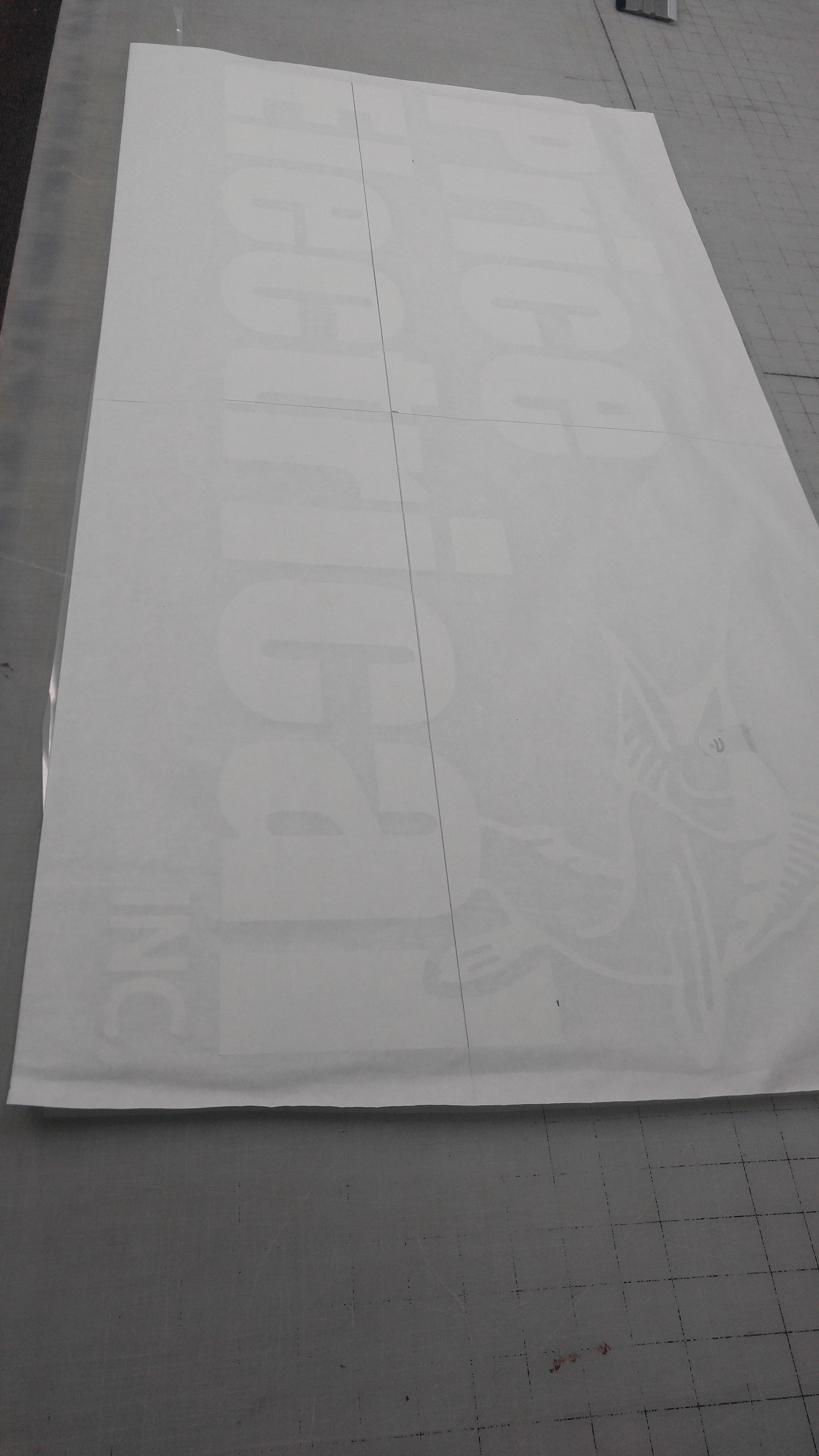

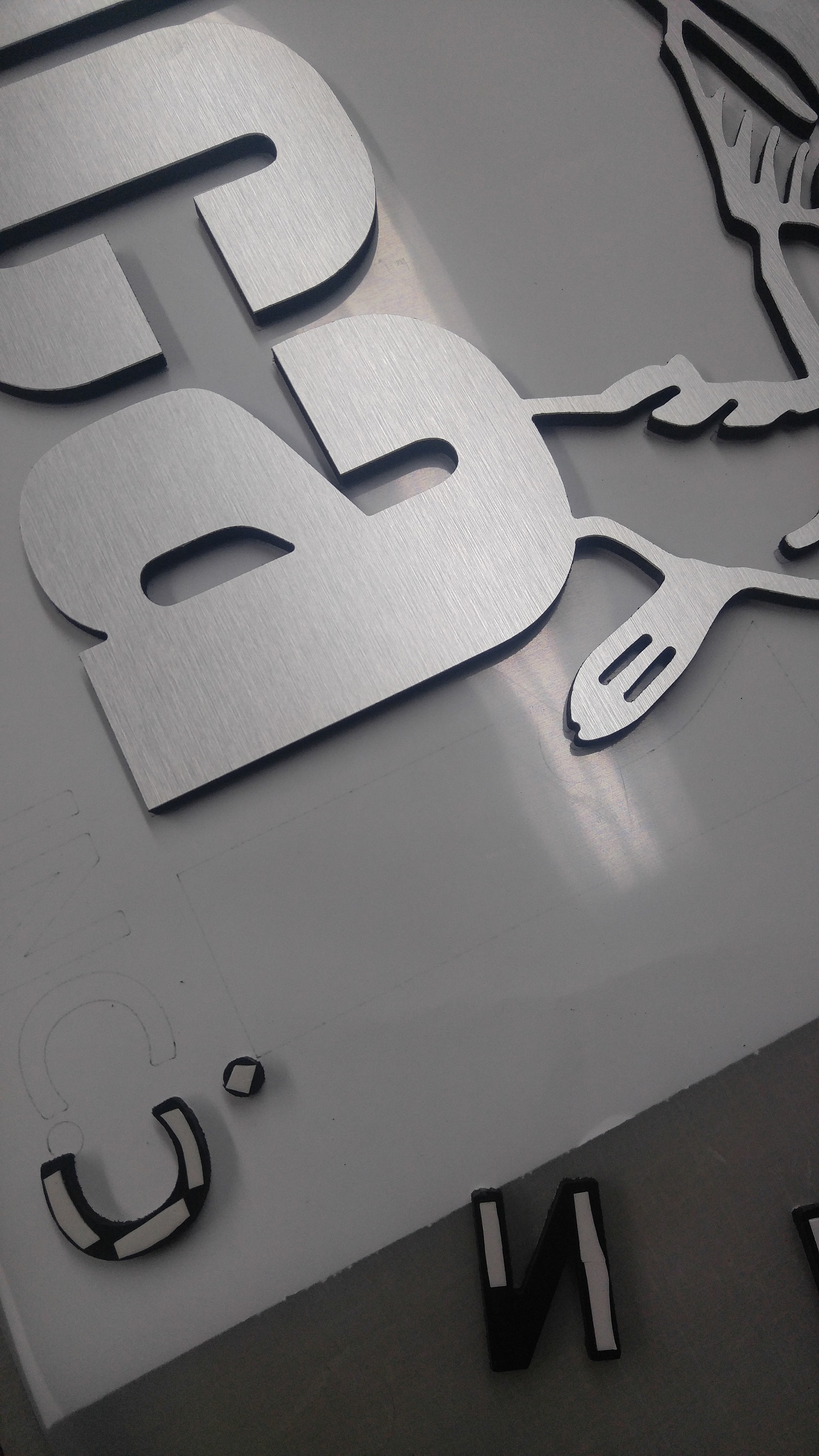

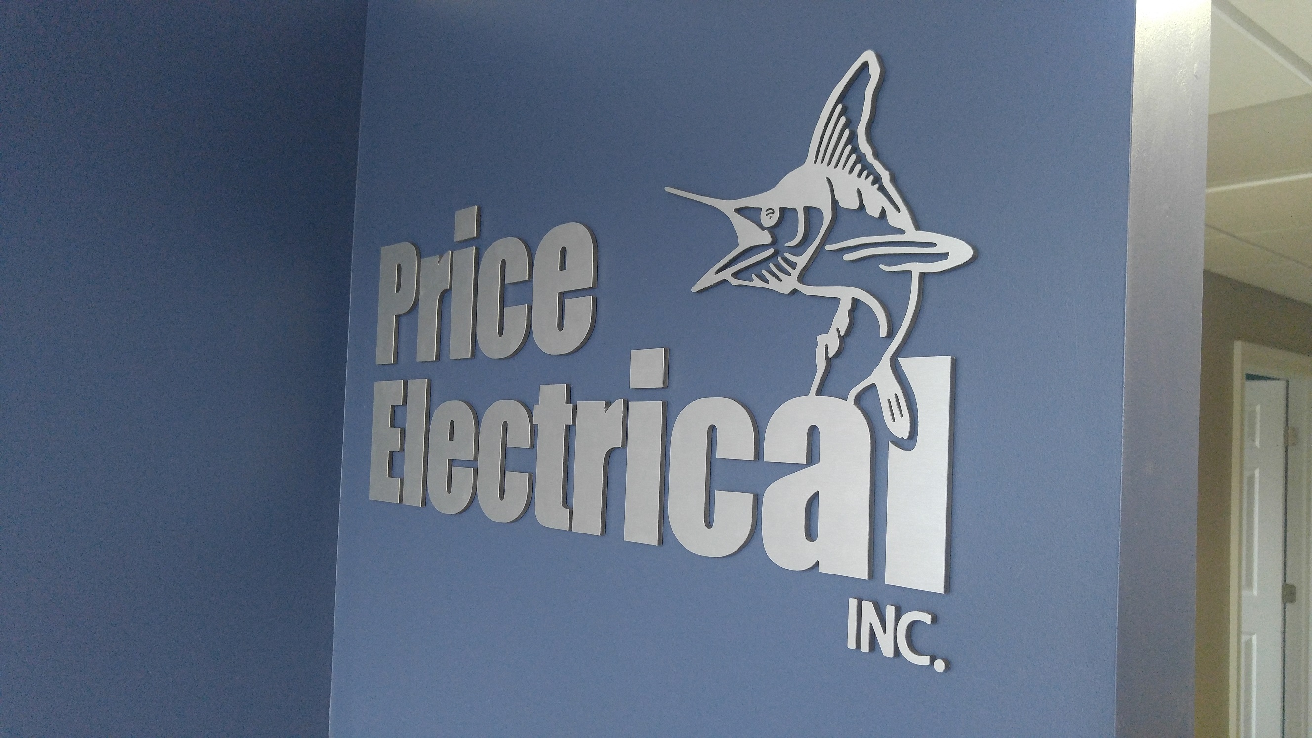

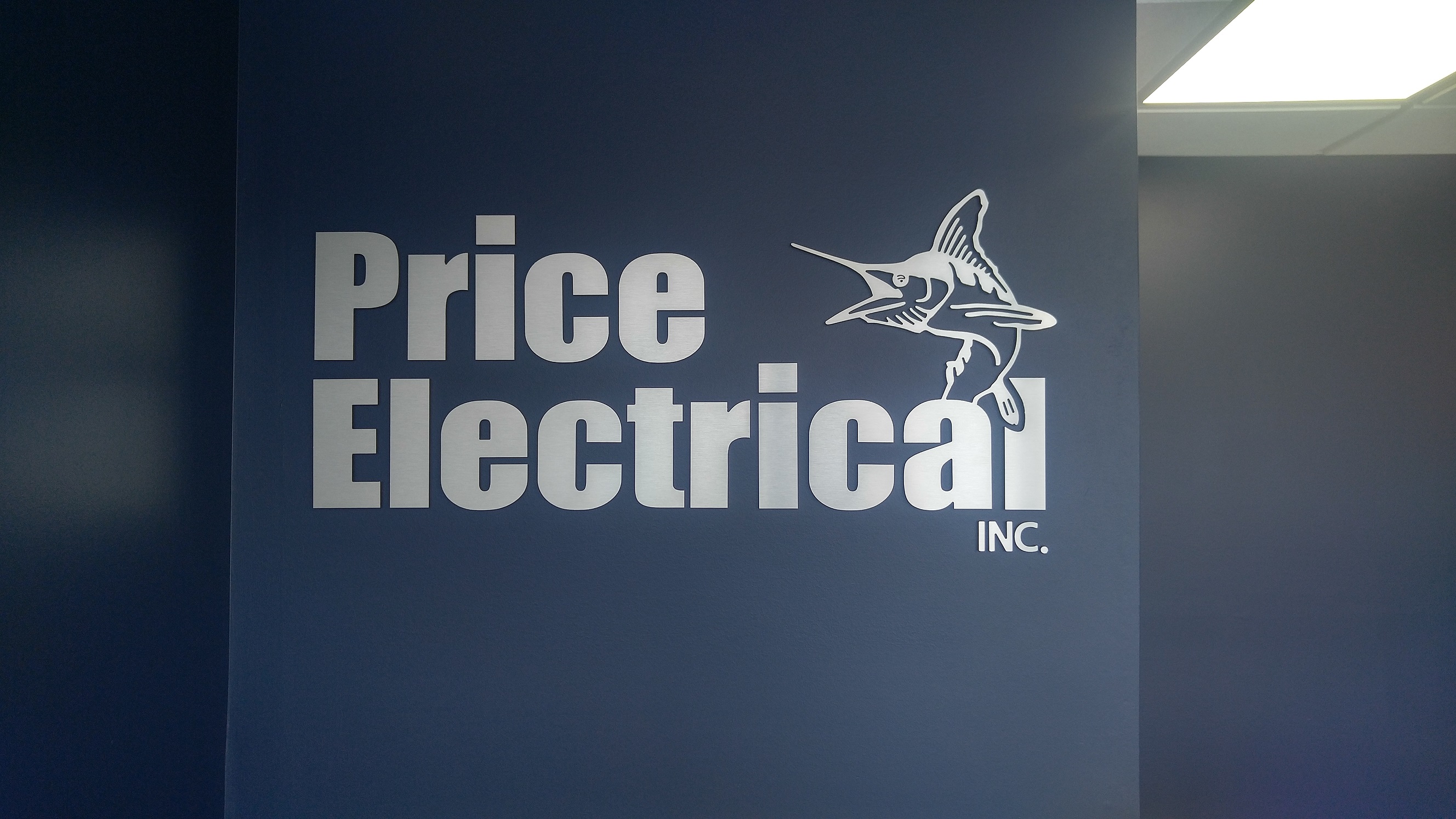

This job was some brushed aluminum on 6mm pvc and router cut. I plot out a paper pattern and tape to table. Then I take some old 8518 liner and place over the paper pattern and tape to table. I then put the VHB tape onto the back of the letters. Now I take the backing off the VHB taped letters and place them on the liner over the pattern. When this step is finished I pull the paper pattern out from under the liner and transfer tape across all the letters. I use 2 layers ( thanks SignBrad ). I put a level line across the job in a easy spot from leveling out at the job. When I get to the location, I just tape on the wall in place, level and center up and then pull the liner from behind the letters. Most all the work is done in the shop saving time on the location.
I have used this method for letters 3mm up to 12mm. I have used this method for 12mm x 12''tall letters that run out 8 feet.
I thought maybe some people could use this trick and its super easy. I have a few accounts that like 6mm copper letters and logos that are smaller then 36'' and I just provide it to them put together like this and they can do it on their own.
