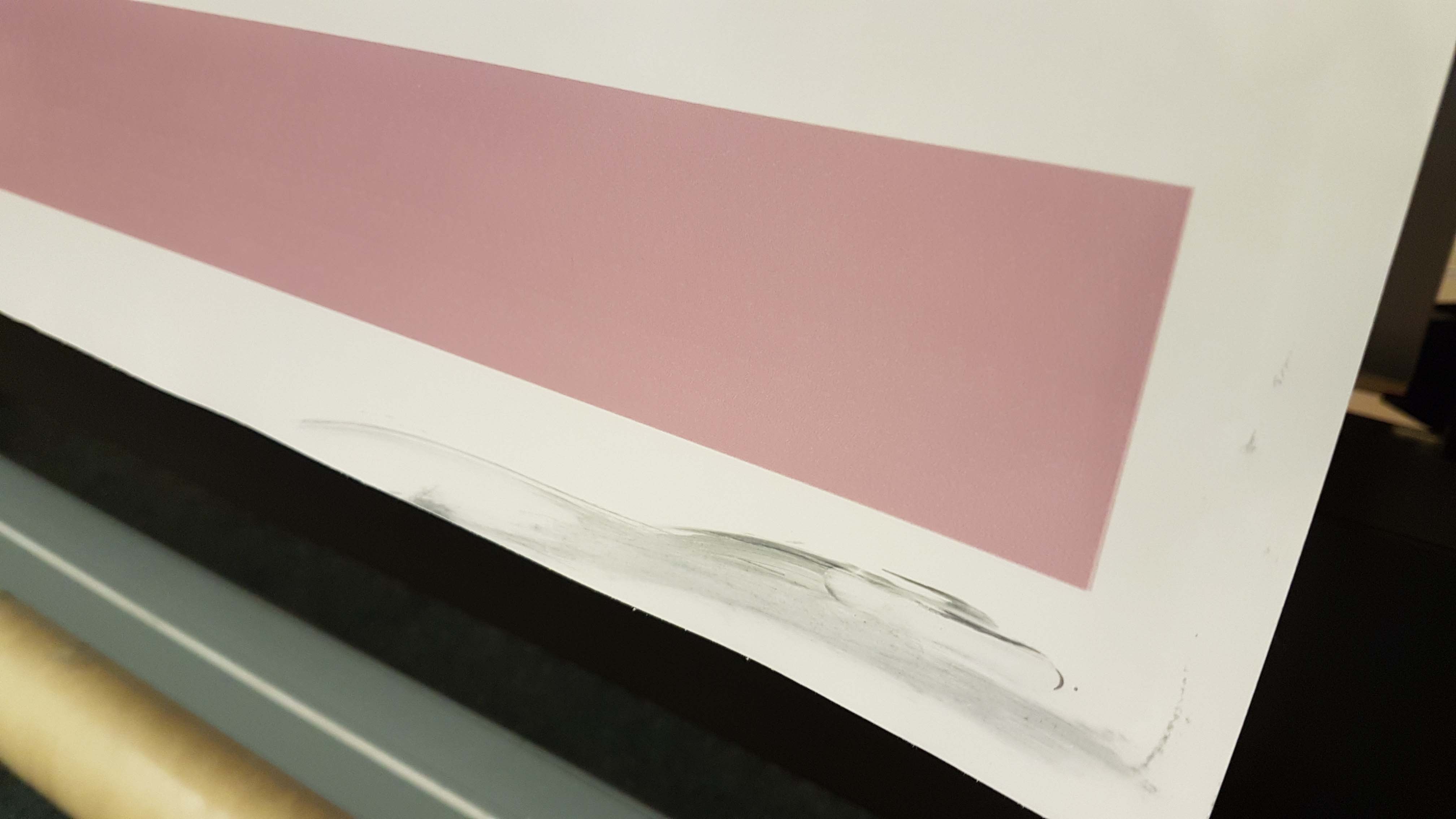

After fitting a new damper we then tested by printing pure metallic and it just comes out in a light purple colour (just like it always ever has). The colour of the prior leak notified us that what WE THOUGHT was metallic WASNT!

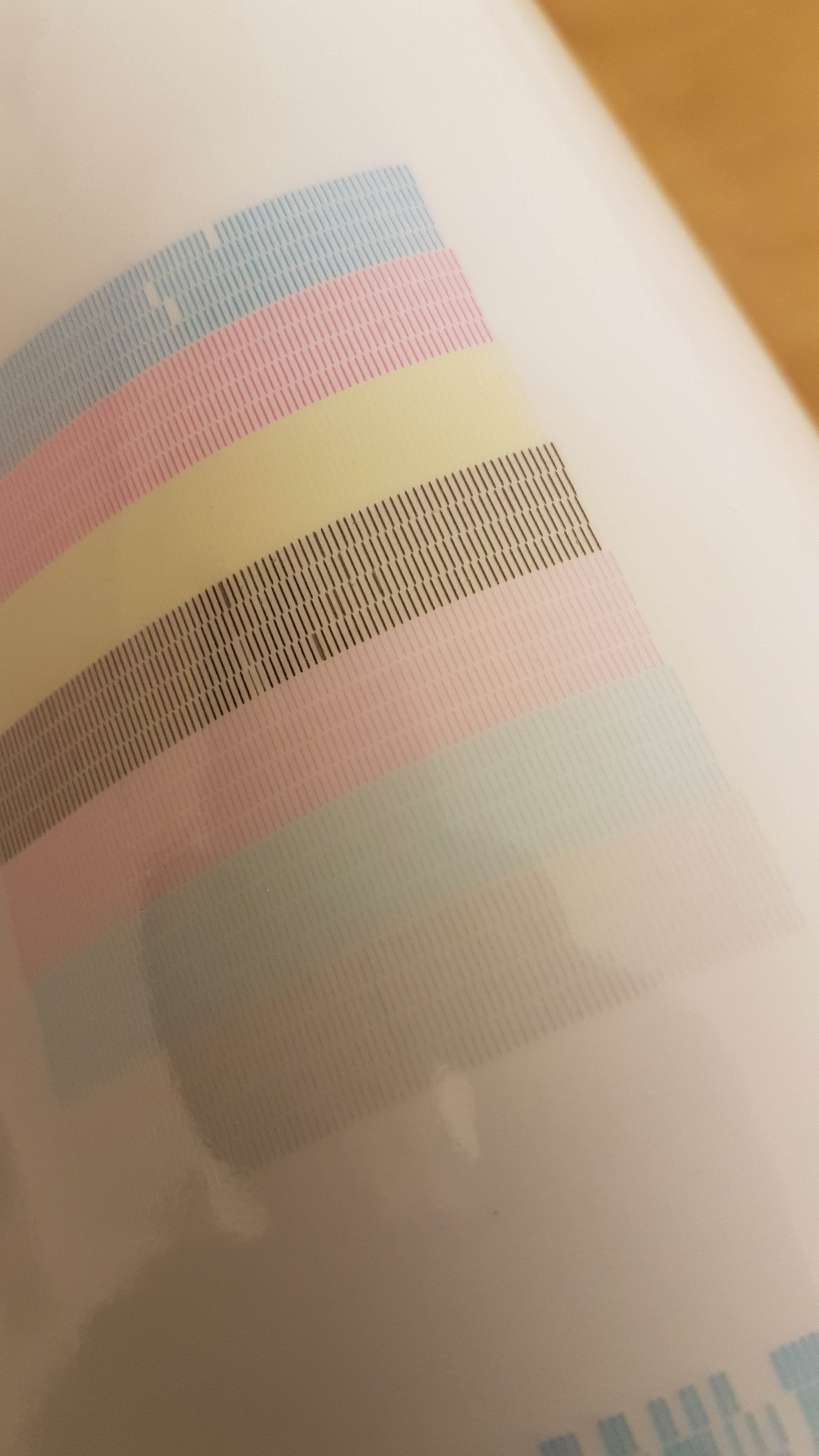

When we do a test print it prints metallic great...

Pictures attached of what is a strip of metallic and also a head test showing that metallic is working.

When you change to metallic only in Versaworks, what do you see in the preview? Does the metallic ink icon show up in the center panel (where your normal cut icon would normally show up?)
