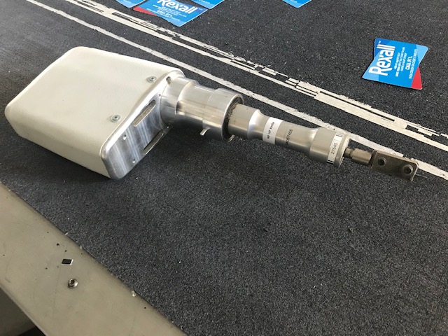

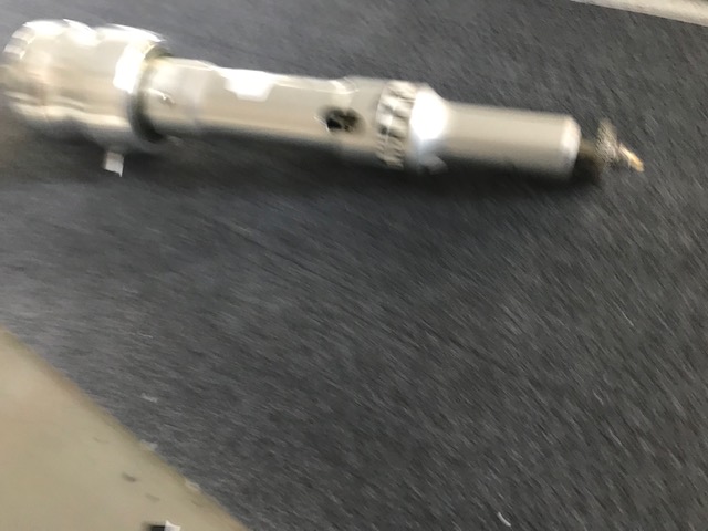

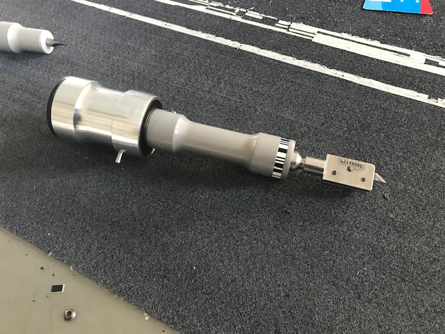

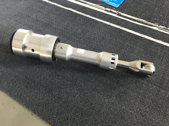

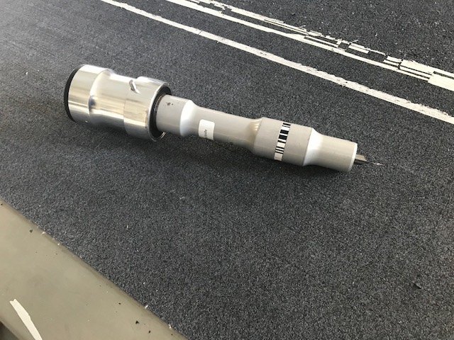

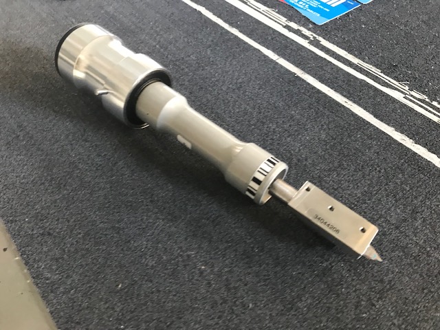

Very small shop (father and son shop) just bought a used I-XL24 with a 3kw router on it and some static tools and one oscillating tool.
The question I have is what tool / blades / bits do you guys recommend I buy to go with it?
I have zero experience on this type of equipment.
What bit should I buy to route: Plexy, ACP, Aluminium from .040 to .080.
We will be cutting quite a bit of Sinta, coroplast, kiss cutting vinyl and full cutting (pop out decals).
All recommendation are immensely appreciated.
I will have a basic training on it by Esko, but I would like to have most tools ready for them to explain the best practices for them.
Kindest regards.
P.S. see pictures for the included tools, sorry for the ugly picture ¯\_(ツ)_/¯
IMG_4127.jpg IMG_4125.jpg IMG_4130.jpg IMG_4126.jpg IMG_4128.jpg IMG_4129.jpg
