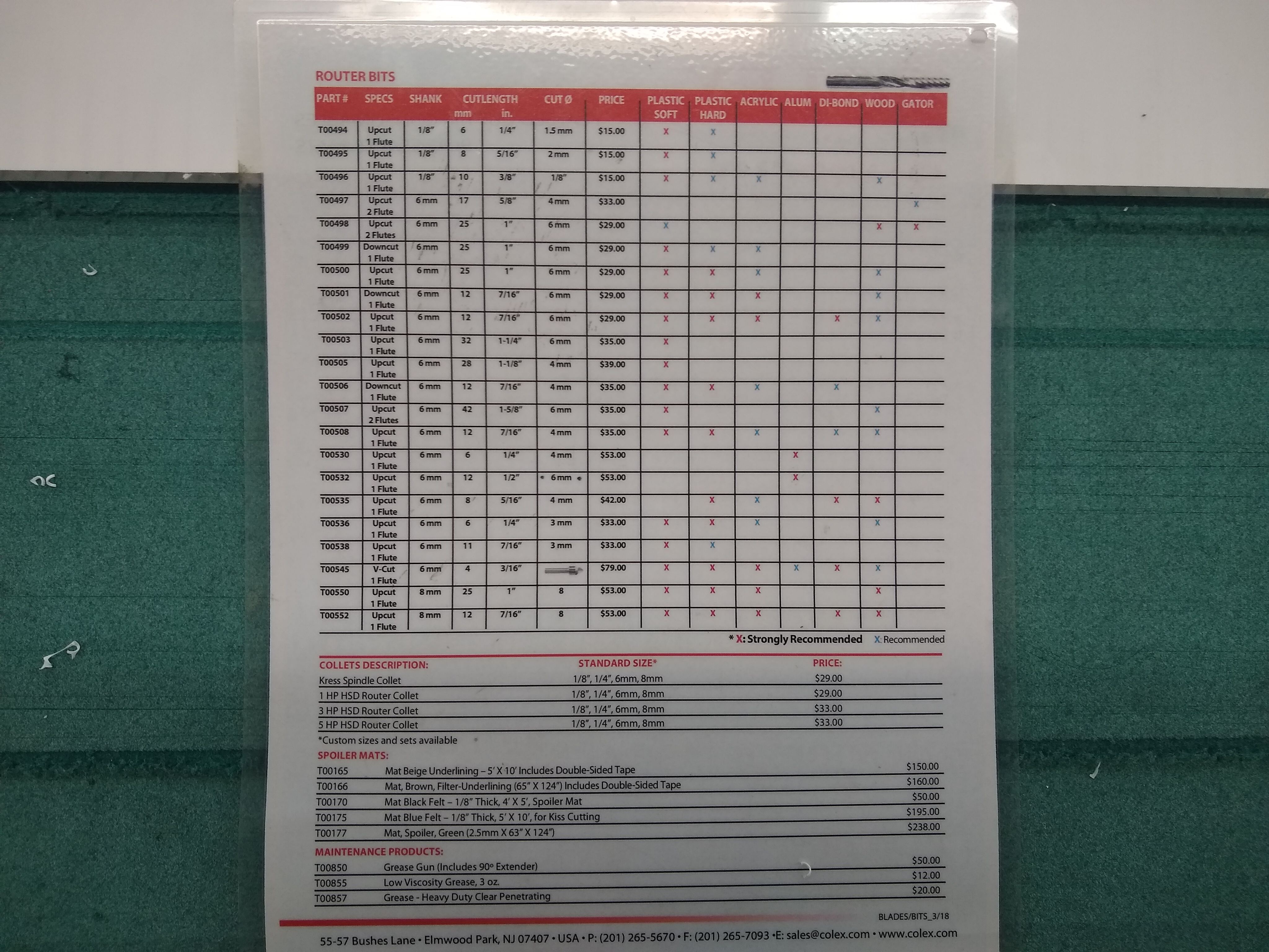

Do you guys not have a cheat sheet? All I did is go down the list and find the first bit that was "strongly recommended" for hard and soft plastic. Then I messed with the setting until I got a good cut. There are a few bits that will probably work just as well. I'll go ahead and post it so you can reference it if you need it.
Also, I went ahead and cut a tiny bit off a scrap sheet of 10mm corro I had laying around so you can see they type/quality of cut you should expect. You can see it beneath the cheat sheet.
