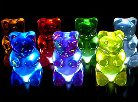

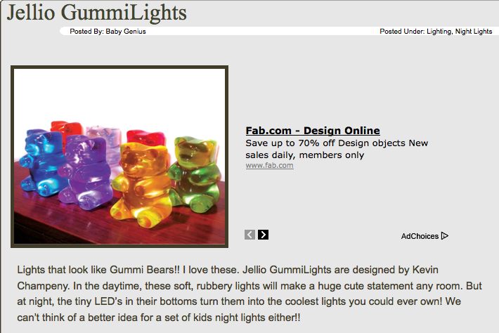

gummi bear lights
otherwise maybe inquire at the head shops ("tobacco pipe" store) and try to contract a glass blower to make it for you? i'm sure if your client is hellbent on illuminated bears, a price markup won't be taken as insult.
