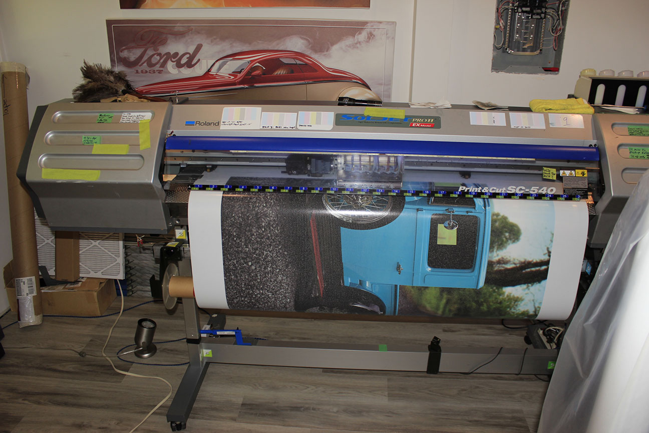

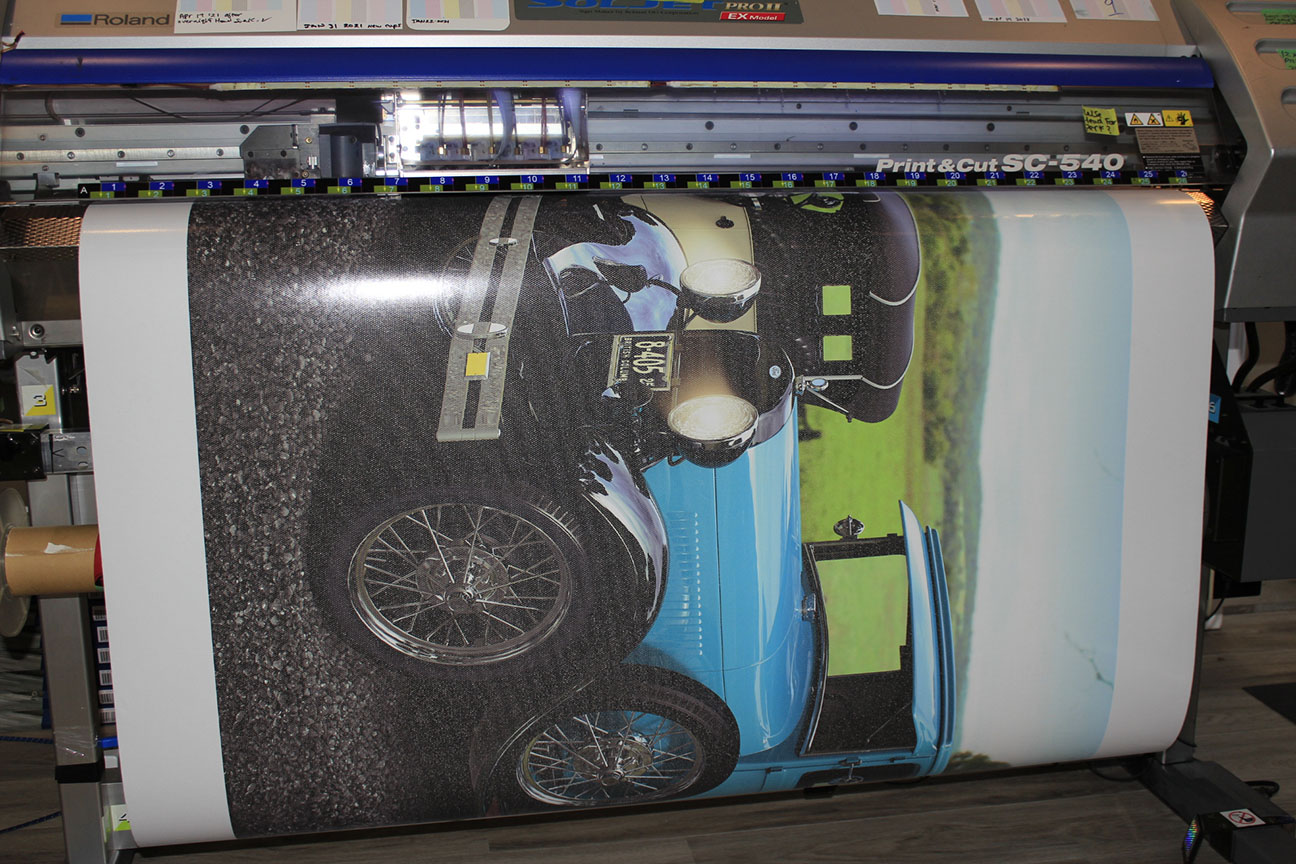

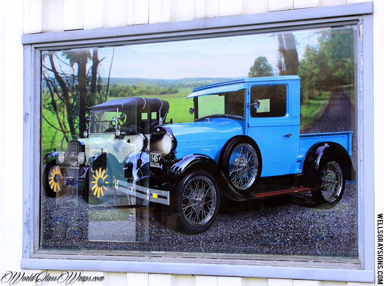

96XP
Processing went very well.
Supplier recommended not using a laminate and doing a dry install, however, would it not be easier wet?

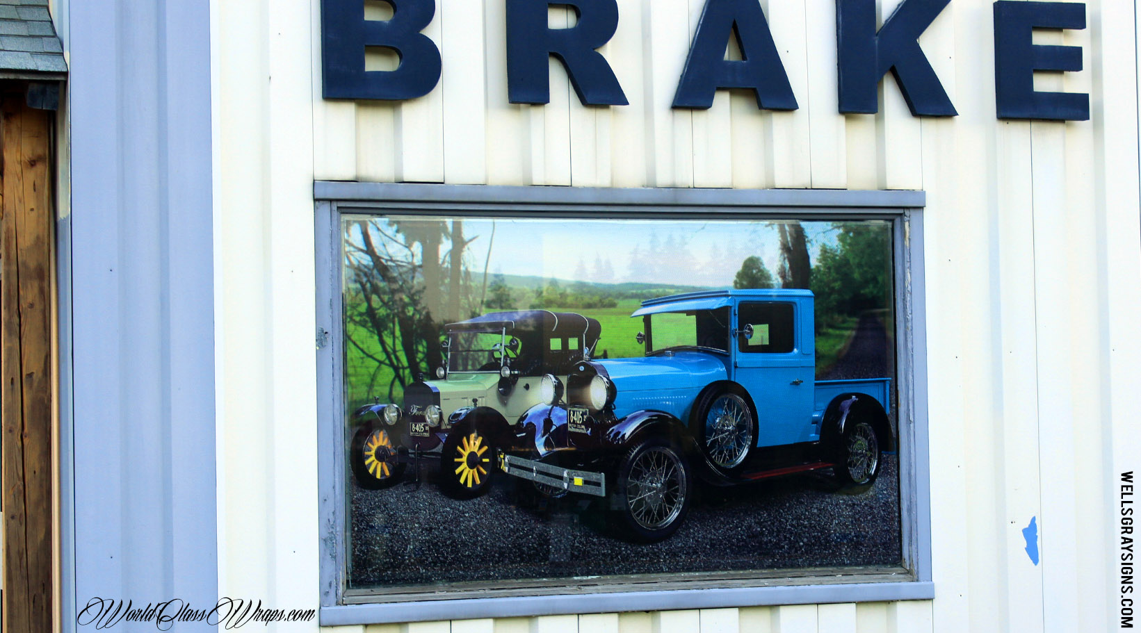

Joseph, we've been rained-out for days. Haven't installed yet, though will at first opportunity, then share images.
96XP
Finally - a good dry stable day for install.
My first experience with window perf and so glad I did it in the shady portion of the day.
A lot easier than I anticipated too.
However, I was eaten alive by swarms of mosquitos - have the welts to prove. Lol

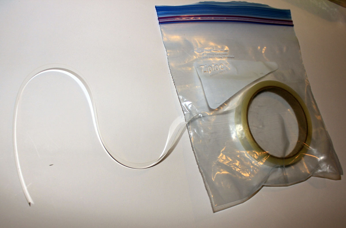

Last photo is the edge-seal in ziplock baggy. I put a slit in the side of it to control feed the tape through.
Two more custom windows left to design for the customer.
