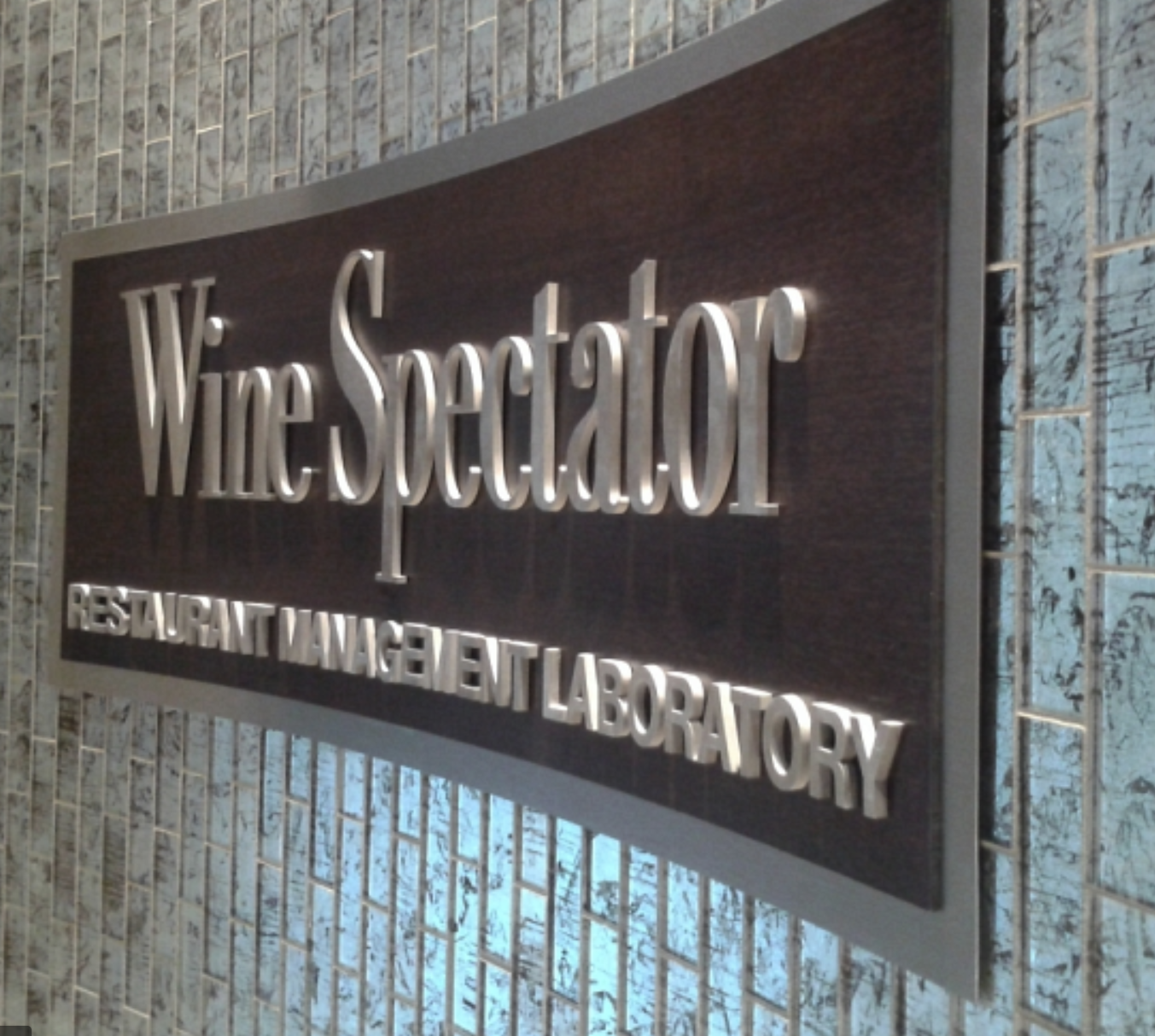

Hi All:
My customer is looking for a sign like below, how can we bend the aluminum and wood panel perfectly like below and mount to the wall?
Many thanks!
Martin Denton
if you make it out of aluminium composite eg Dibond, it has enough give in it to bend it to that curve within the wall, just screw one side in and then tack along it every 600 (2ft) or so.
