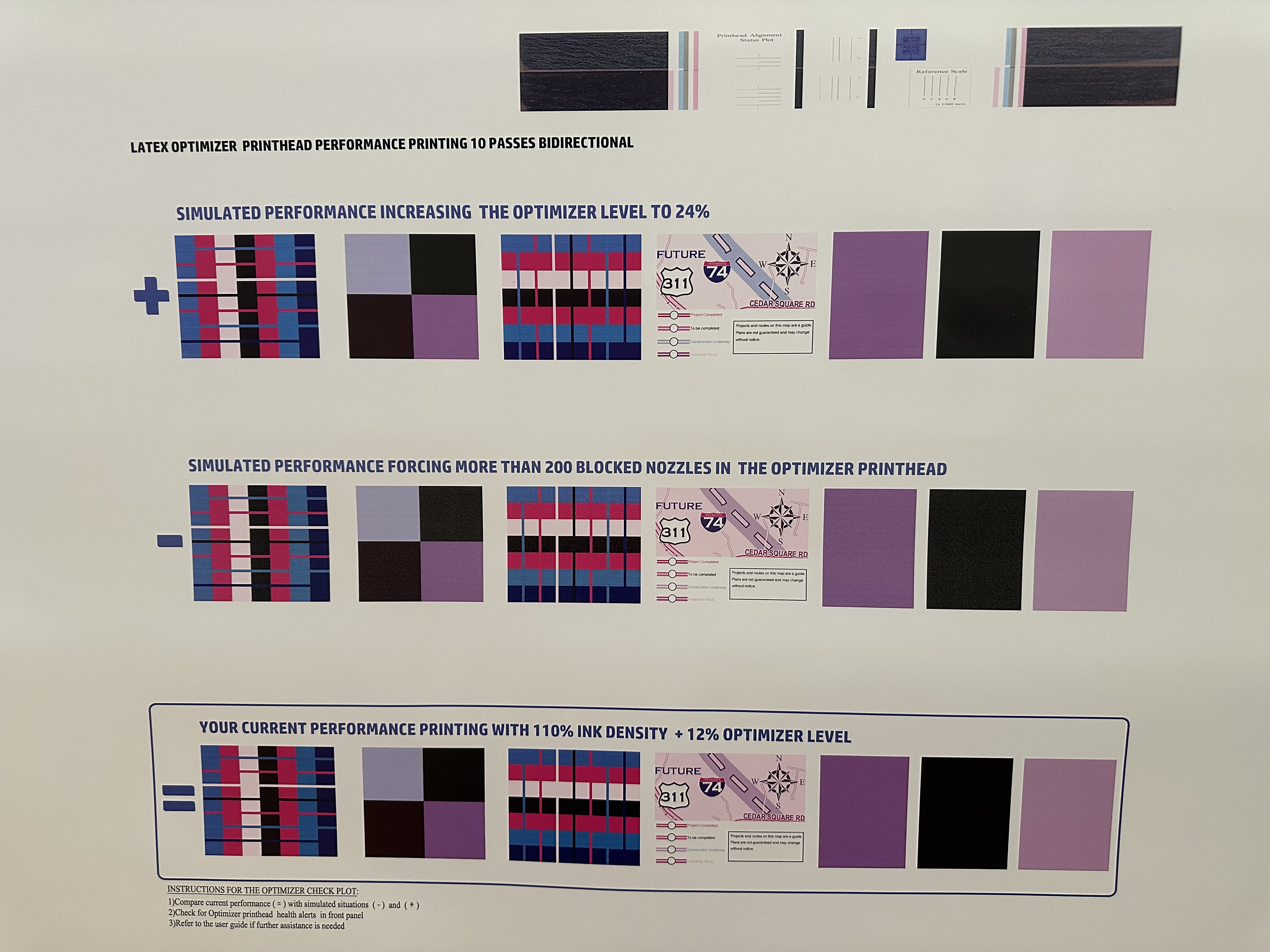

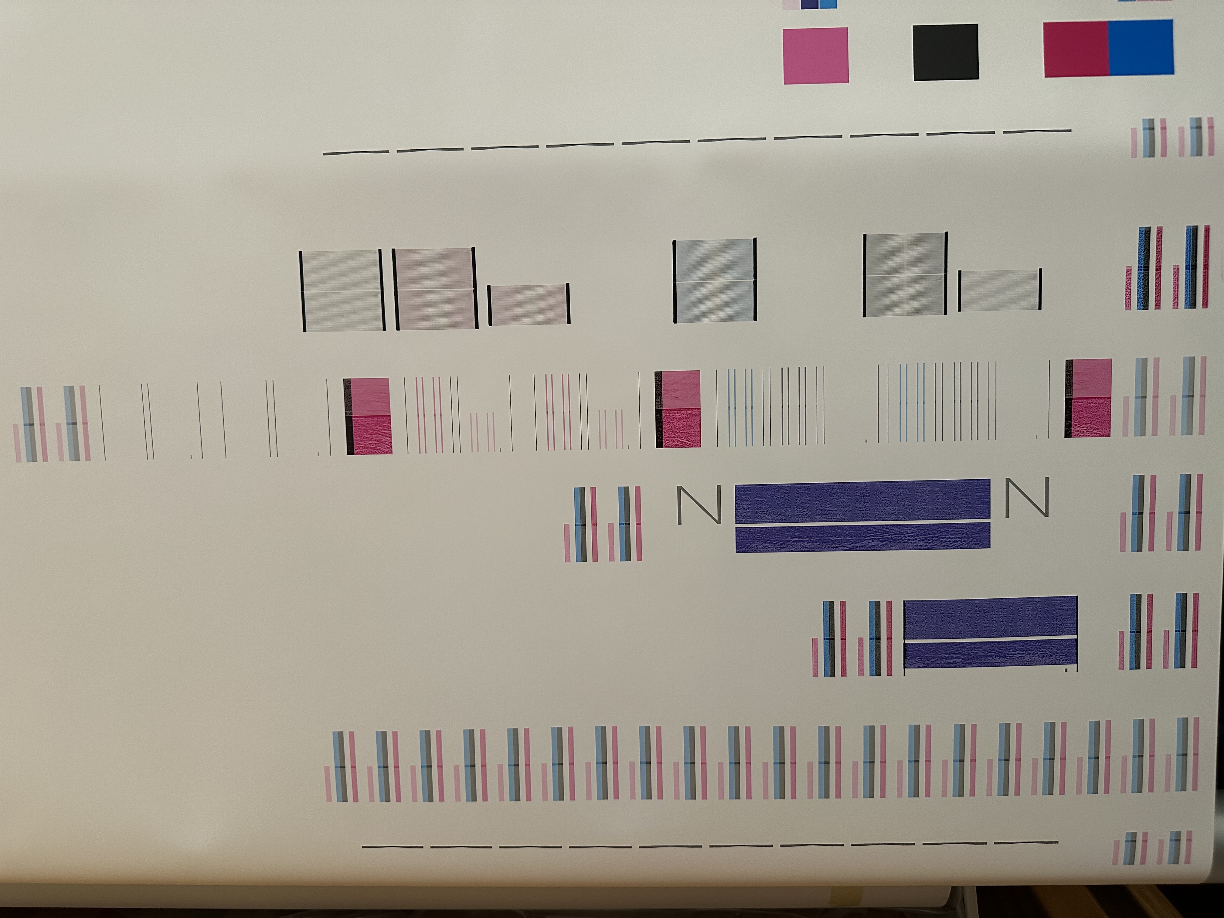

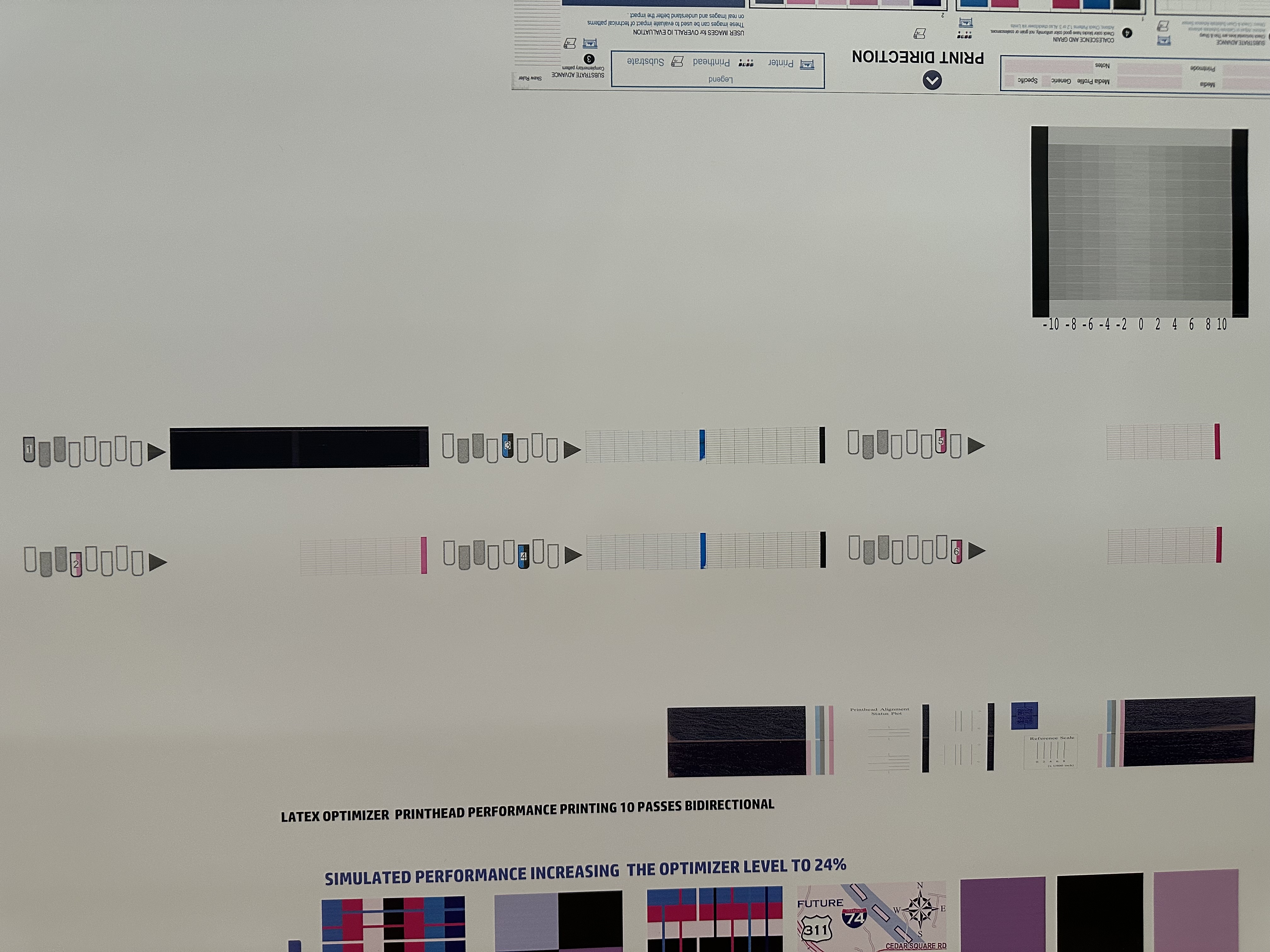

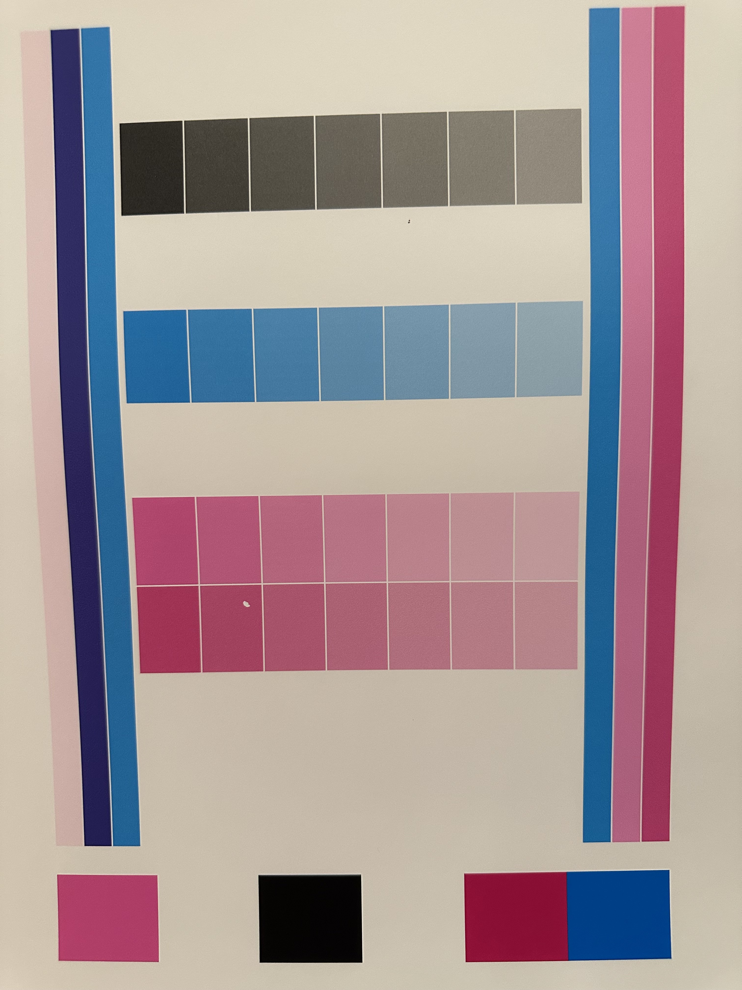

I haven’t used my HP Latex 365 in over 6 months—it was powered off and unplugged during that time. I recently started it back up and noticed yellow isn’t printing, and possibly other colors as well.
The ink cartridges are expired, and I plan to replace them all. I’ve already cleaned the printheads and ran some image quality checks. I also printed some test plots (see attached), and I’m getting error 98:03 about a potential print quality issue. It recommends checking the printheads via the Printhead Status Plot.
Could someone help me diagnose what’s wrong? Do I need to replace any printheads—and if so, which ones? Any recommended steps would be greatly appreciated.

I'd take out your yellow print heads, get a plate and fill it with water... Just enough to cover the bottom of your head, not enough to wet the back electronics rhkugh. Let it sit for a few mins in the water, pull it out and gently wipe it a couple times with a lint free cloth.... Throw it in and do another nozzle check, see if the yellow comes back.
Looks like you need head 2, 5 and 6... I'd try soaking all 3 first and do another cleaning then print the test, see if there's any improvement.
