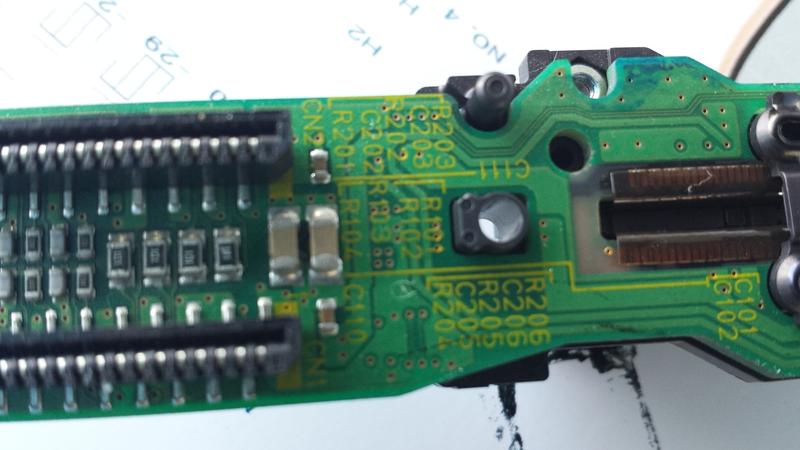

how do you install rank number in sp300v and which number is used? had to reboot board through service mode now print is off, did bi- directional and all the mechanical settings, can someone help please, attach picture of numbers on head

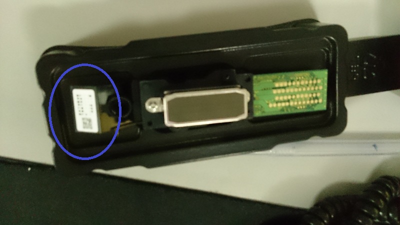

There is a label on the printer manifold end.
Please find the picture in attachment, there is mark of it.
This is a new DX4 solvent head I just received.
Brent

head has white label but its blank,is there some sort of generic number that can be used? haven't removed other one yet
