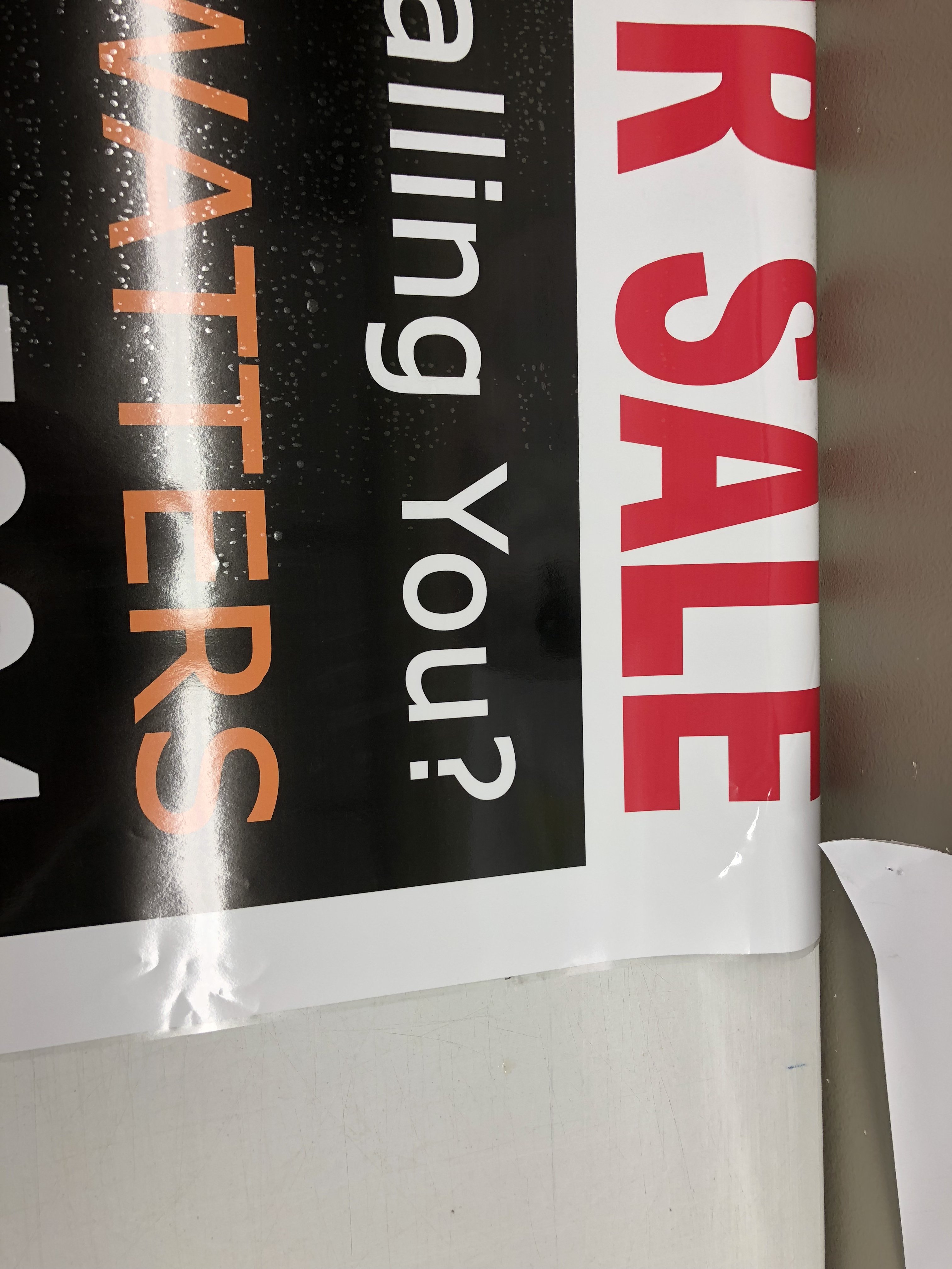

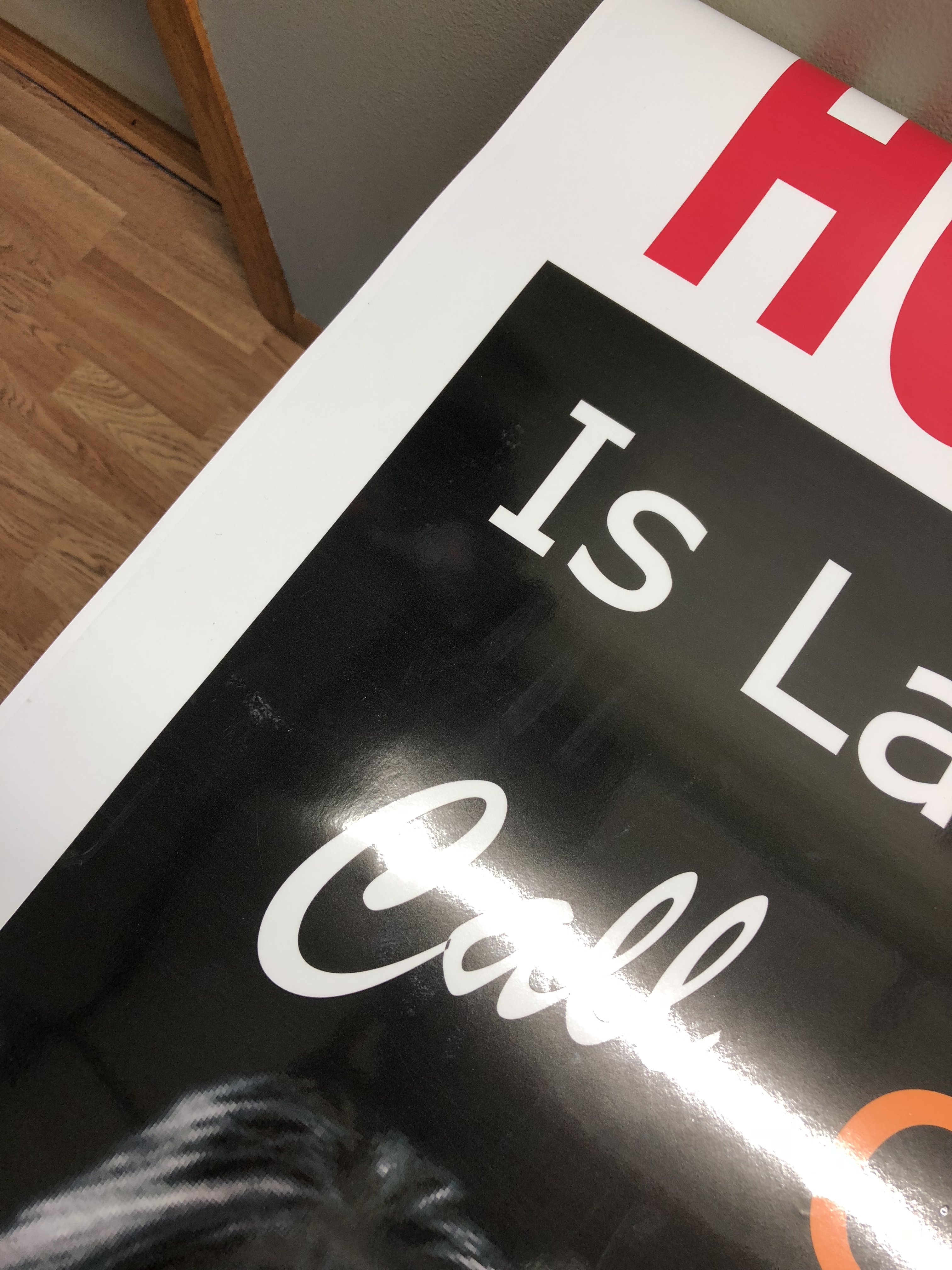

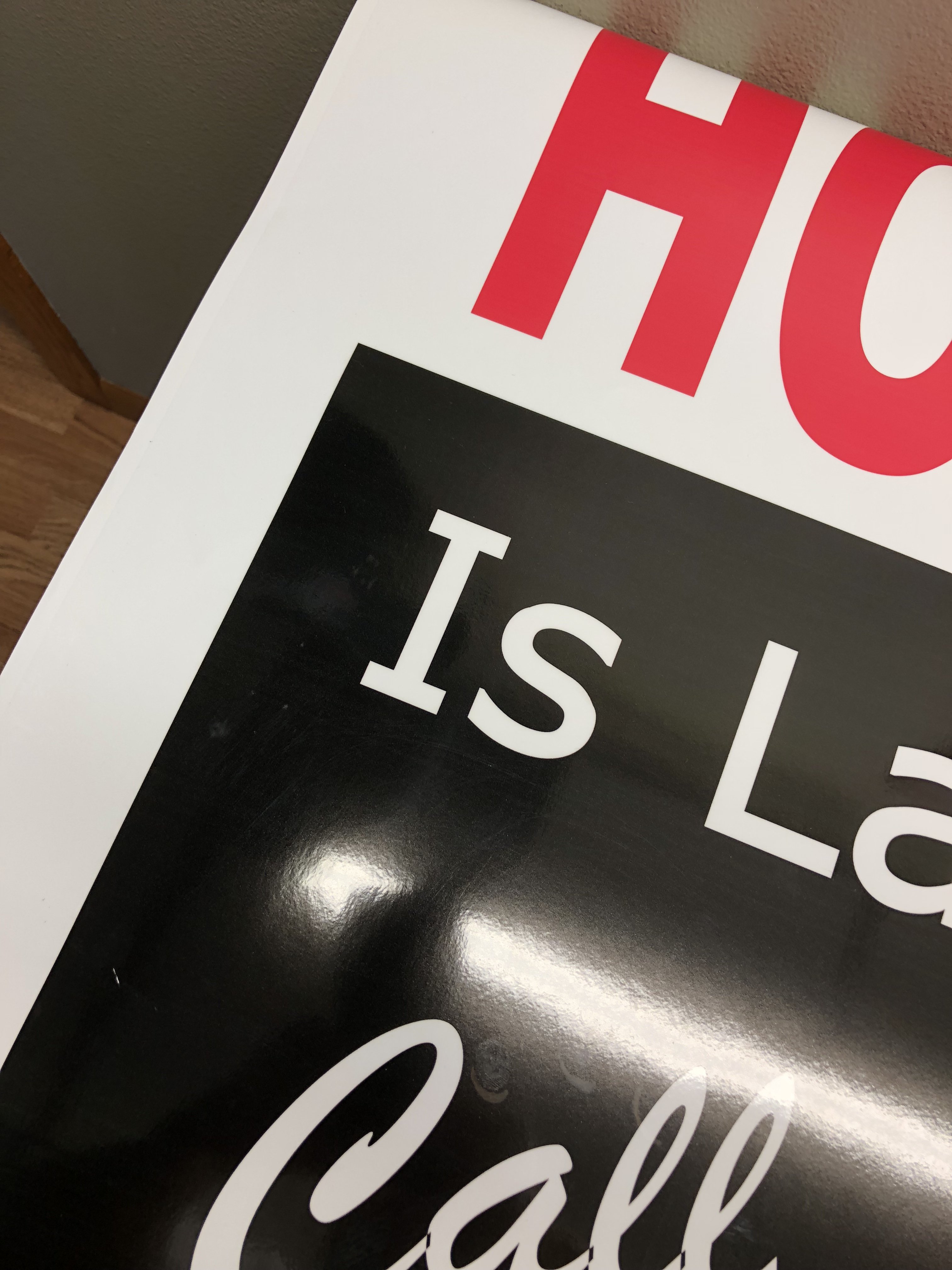

idealsigns
Chaplin
One of the attempts at it. We don’t have any bubbles anymore, but still perfect on sides and center of print no enough pressure. You press down in the middle after laminating and it lays down harder.

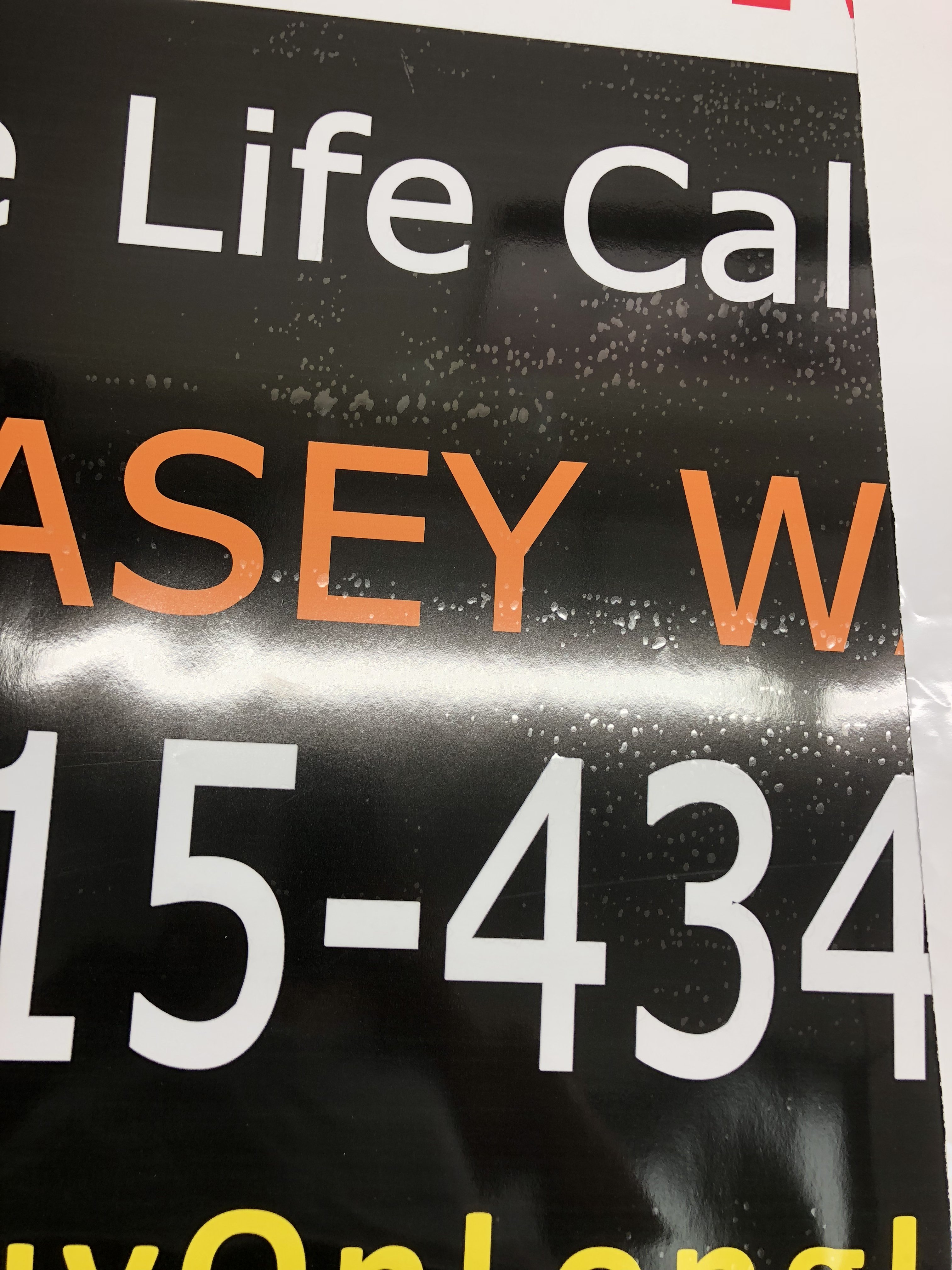

idealsigns
Chaplin

ams
Sounds like your rollers are messed up. Since upgrading to a better laminator probably isn't going to happen , try tightening as much pressure as possible so that the middle touches.
Also try playing with your pressure knob or tightening any loose screws.

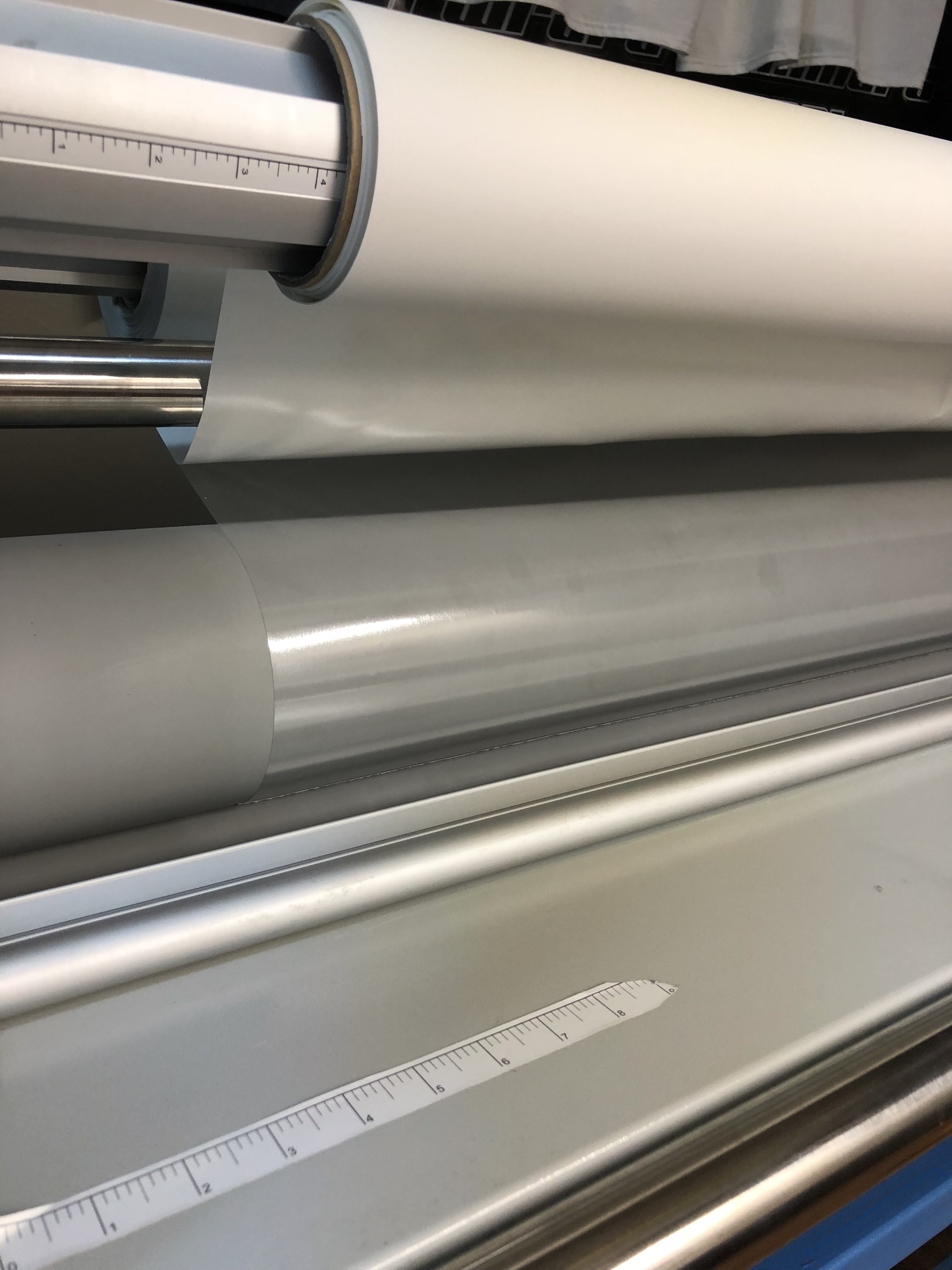

AKwrapguy
Try taking a better image of the laminator, use landscape, and try to take it straight on. The photo you posted doesn't show much.
