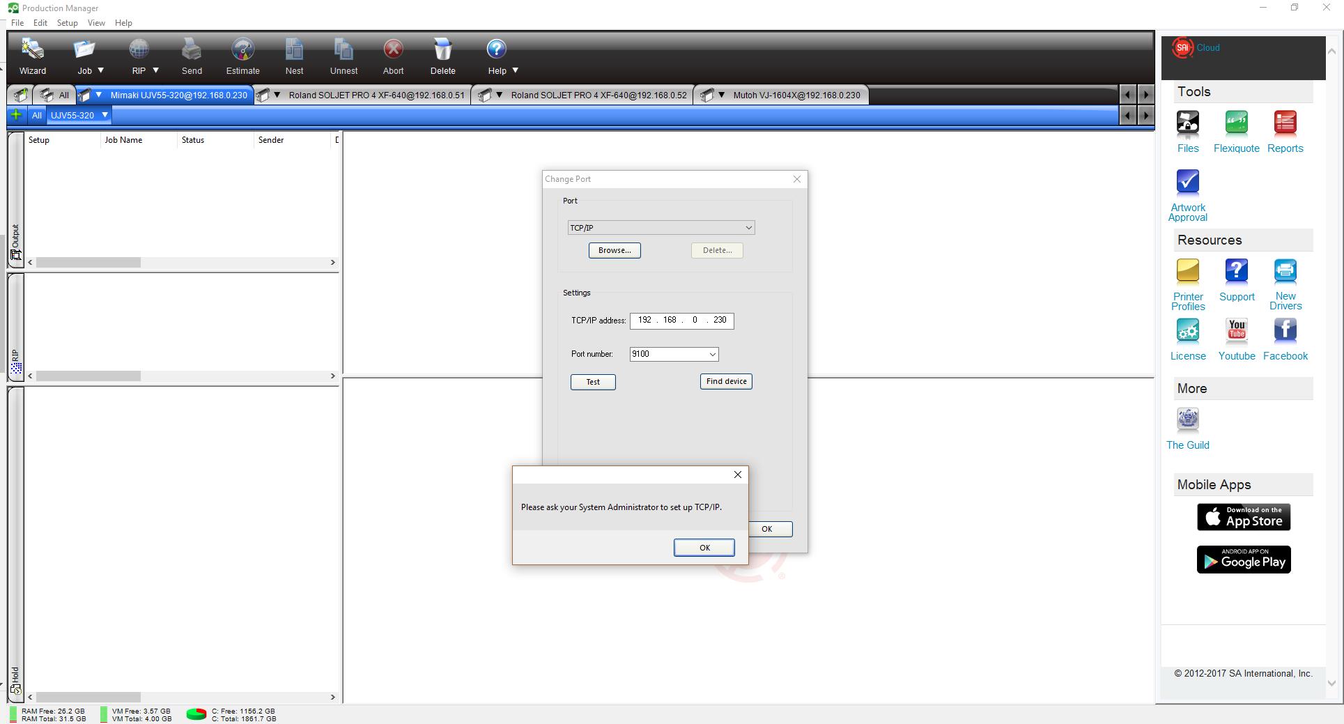

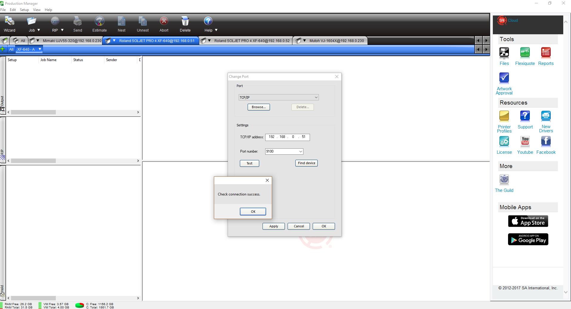

i just key in my printer ip address in Flexi port setting window, when i do the connection test it failed on UJV55 but pass on my Roland. see attached images.

my PC can communicate with the printer over the network as well as Rasterlink, only Flexi cannot but it can dectect all other printers in the network except UJV55.

Thanks to all who trying to help me solve the problem, finally got the problem fixed with the help from those good guys from SAi, I just need to set the printer port to 11110 and very importantly a proper ICC profile for the printer need to be install in Production Manger in the first place.
