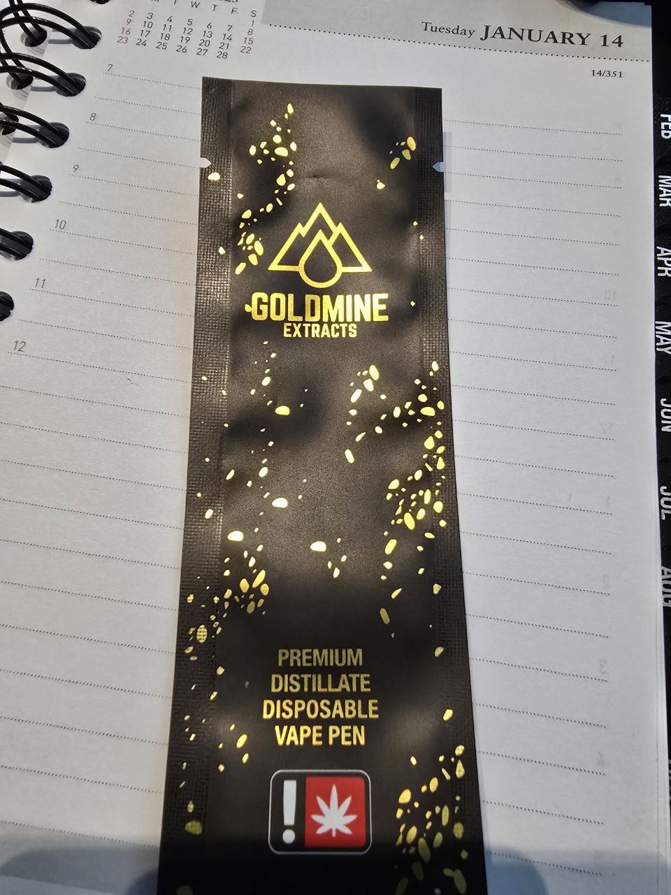

Hey guys I have an Epson s80600L and Graphtec FC9000 and lately I been getting a lot of work doing labels for people. Today a client came in and wanted labels made for their brand and the sample that he gave me has a metallic look, it's a print on mylar on this sample....see attached. My question is since I have a solvent printer is this achievable without a huge headache? Any recommendations on a calendared vinyl that would work for this? I have found cast vinyl but not sure if that would be to thin for a label or not. I figure if I can't get this done without having to purchase a UV printer then maybe I can find a regular gold vinyl and print black over it.....any advice helps THX

I would use RTAPE VinylFX, try printing just black if that doesn't work back with white.
when you say back with white you are refering to that if you see gold through the black ink then print white first then print black over it? Thank you

My bad these guys aren't looking for mylar bags and I don't do mylar bags because they're a pain in the ass. They want a 3"x 3" square label for their product line to put on jars and a circle label for the top of the lid.
I would just try printing black on the gold. IF the black isn't opaque enough which it should be I'd print white behind the black. I saw you had an Epson 80600, so I assumed you had white available.
I do have white available, haven't had it long enough to figure out how to print white first then black over it tho...lol
Bxtr
Unfortunately I don't do enough of the printing to tell you how. It's either over print or under print... It may be a profile thing. I'm sure someone on here would know for sure.
