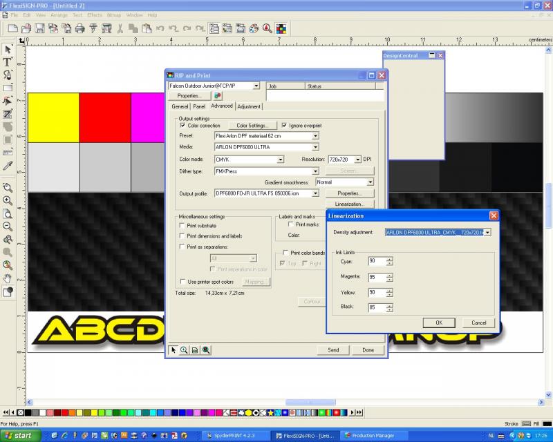

Screenshot from Flexi 8.1 do not know if 8,5 is the same.
In the rips advanced tab Check Color mode is not greyscale but CYMK.

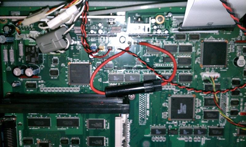

update on my problem, was that the sensor went bad. so i replaced them with a parts printer i had laying around. while disconnecting things to try to fix the problem i blow the fuse on the color head. i replace my fuse with a home made kind and solder it in place ( i used a 1.5 amp fuse ) . look at the pic. know im in need of a color print head so i can be back running.
