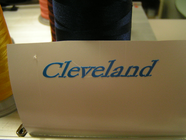

My Roland GX-24 is acting crazy, when i cut using LXI software cut the normal text with curves in the corners, end the straight edges with tips, but when i cut with CutStudio works perfect; Any idea what is causing this ??? Thank You

Check you blade off-set.......How old is your blade.........If its old then you might need a new one, when the blade dulls it will affect the off-set.......
Do a test cut from the keypad on the cutter.....If it does the same thing then you know what to do.......
