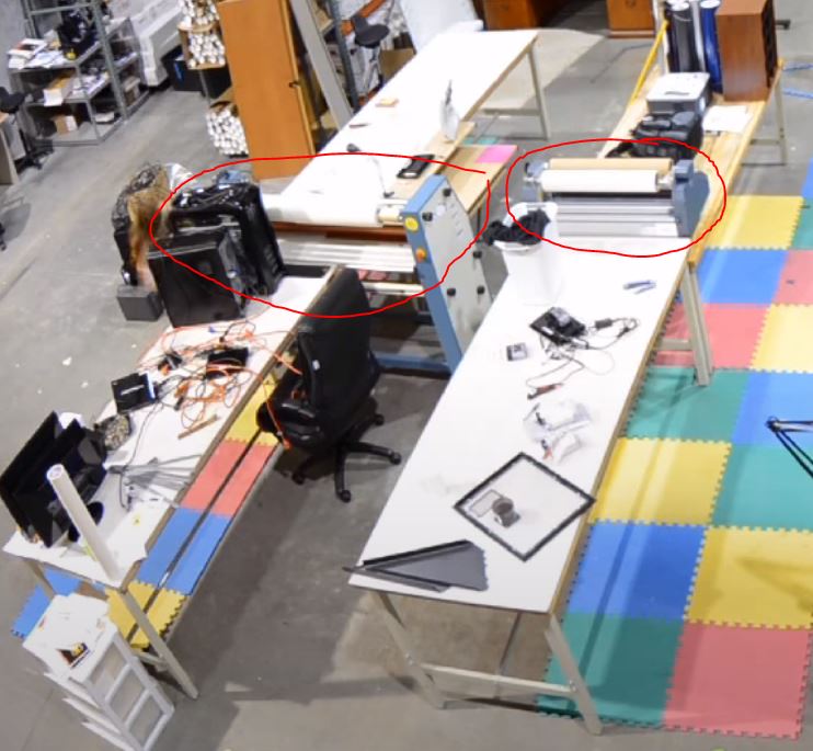

I could keep everything rolled up, need to figure out how I would do it though with a graphtec fc9000 and then how to weed and roll up again? The decals are mostly Oracal 631 with perfect tear (nekoosa) 775, not printed on a roll to roll.
I saw another shop post a time lapse video and they are doing sheets without problem it seems through a laminator. I'm including an image of what their setup is, although can't see the details as video is time lapse. Anyone have experience with a set up like this?
As far as squaring up sheets , what about doing a raised lip running length wise on the table feeding the laminator?

I don't know why in the world anyone would cut up a full roll and do it in individual sheets. If you did, it should be faster and easier to have a tape holder on the table and use a big squeegee as opposed to screwing with a laminator for 10 feet.
I'd be looking at how you're trimming because masking that, even individually, shouldn't take all that long, maybe an hour or less? You're saying 4-5 hours.

Putting individual sheets on the laminator shouldn’t be all that difficult, just get an old roll of backing paper, run that through the laminator then tape the individual jobs to the backing paper.
Shouldn’t have any issues with bunching up etc as long as you tape the whole edge down

Well when you offer 60+ colors, have 250+ designs with each requiring 4-5 colors of vinyl, doing full rolls is not an option. We do 300+ yards of vinyl this way per day. Cut, weed, apply transfer tape, trim, roll up and ship.
We do it manually now with some application being done on the flatbed, but the flatbed is slower than manually.
After 10 years of doing this I can maybe do 50yds in an hour, transfer tape and trim but it is physically exhausting and I need to free my self up to do other stuff. Finding other people to go at that pace is impossible, went through 5 people last few months
I see competitors doing sheets using a laminator and it looks like it work pretty good for them with long tables on each side of laminator.
