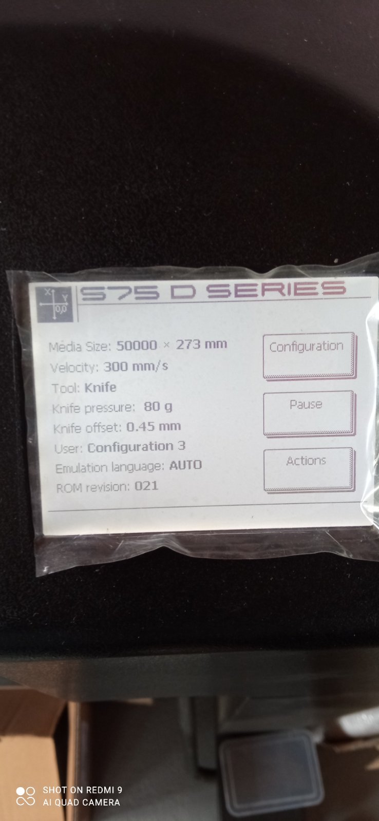

The cutting head hits the side, pulls back, jerks in place, and snaps into position. The maximum that I can cut is 10 centimeters wide

Look at the display, your plotter thinks it's an S75D, and since the S75D only has two pinch rollers it stops at the second one.

Kornelius
I can't get into the service menu. I press under s75 does not respond. I click in the left corner enters set origen and nothing more IMG-f2a23d3df3f84ddaea3eabeae4316551-V.jpg
