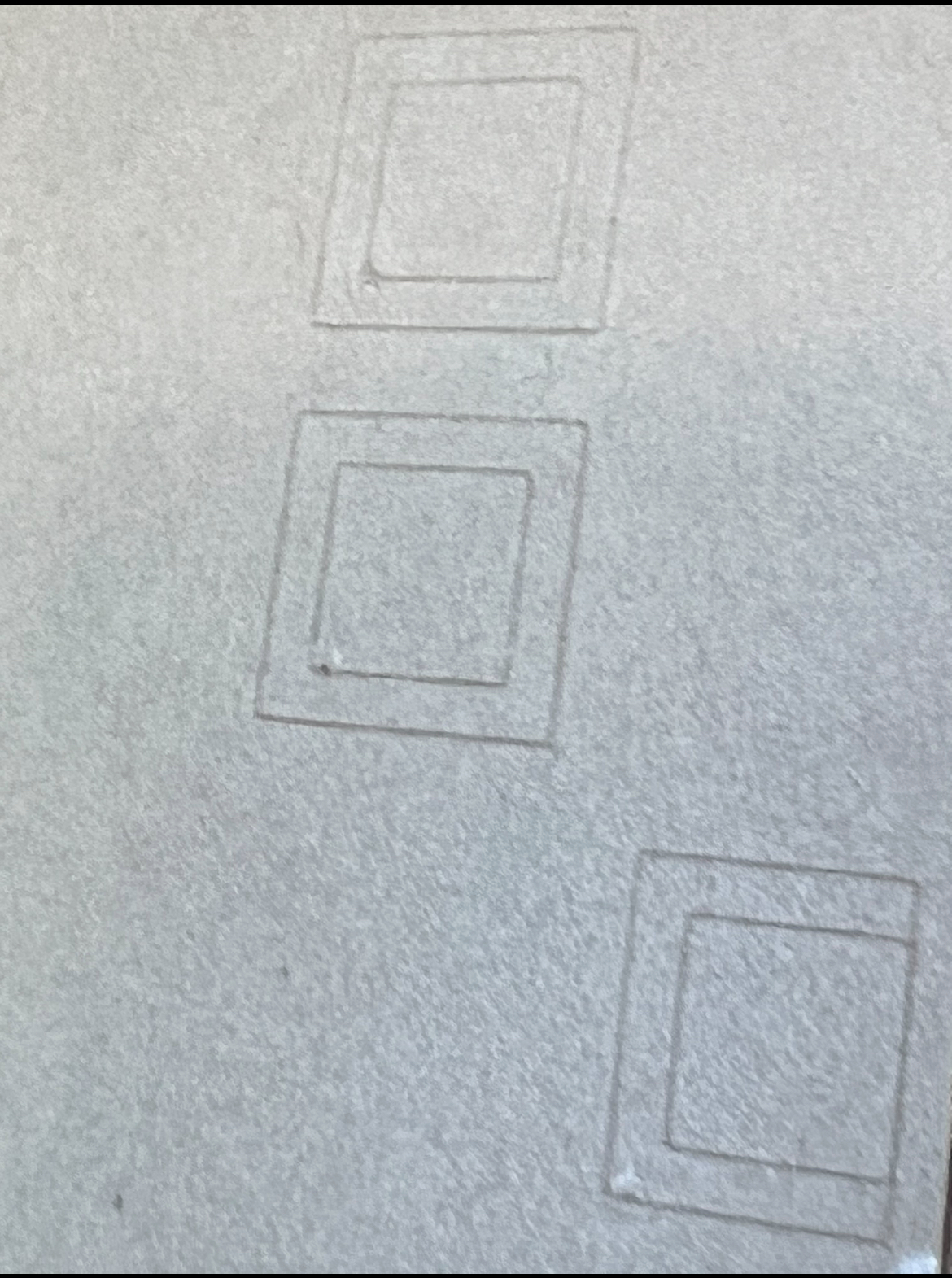

- I wanted to test if the cutting was working so loaded up some media and proceeded to do a test cut.
- Everything seemed normal, except the box seemed slightly off-center in the feed direction
- Tried several test cuts, and each were the same
