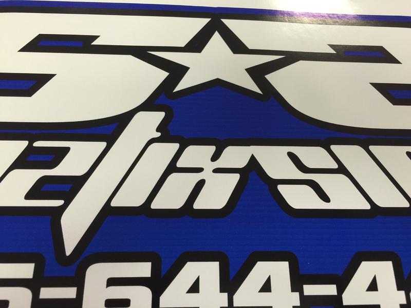

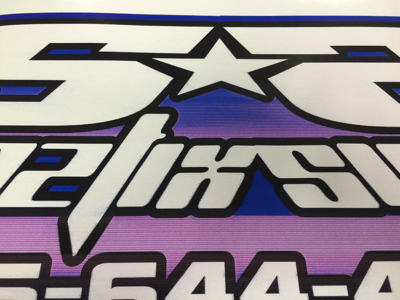

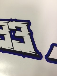

seems like it only does this on the black, replaced 3 out of the 4 inks, the yellow is still 3/4 full. replaced wipers and both captops and a manual cleaning.
posted pic of the blue logo that is printed on the same sheet that was printed fine.
any help appreciated

maybe a static issue, looks like it is spraying. also do another manual cleaning and look in at the print heads with a flash light sometimes you can get a hair or a piece of fuzz stuck in there that you can see or is stuck and doesn't come out with the swabs. that can cause this effect also
player
Again I say you need new ROLAND dampers. Another clue is when the test print is good, but once you start printing it gets dry. There is a micro fine filter in the damper that can get clogged. It allows some small amounts of ink through, but when you print large areas there is not enough ink getting through, resulting in banding and static-y spray.
SpazSigns
dampers are brand new.

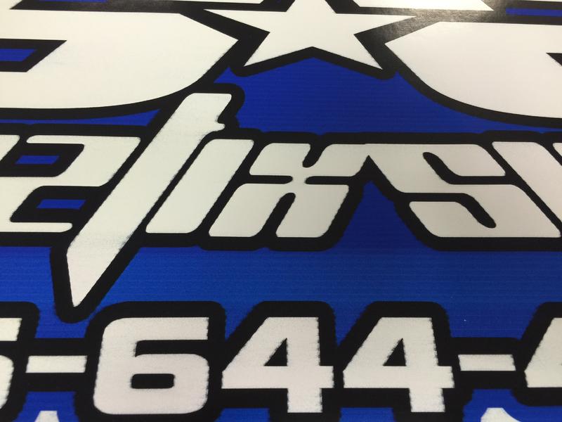

2nd pic is after done a manual cleaning, printed fine, 1st pic i resized and sent to print again & turned out fuzzy.
what is the easiest way to get rid of static asap?

player
Static tips:
Check the humidity in the room. Use a humidifier to get 50% humidity.
If you have a solid floor wetting it down will help tons.
Use anti static sheets and wipe everything down, lightly tack wipe vinyl at the back.

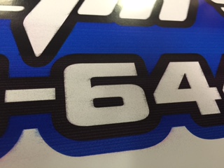

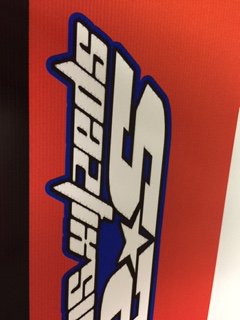

Got the encoder cleaned. printed a different logo, now the contout cuts through half the sticker. pic posted below.

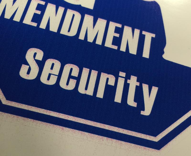

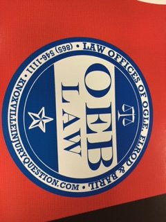

SpazSigns
Printed a blue logo , looks to spray some redish over into the white. pic posted.

player
I am not sure what to try next...
You might want to do a print cut alignment for the other cutting issue.

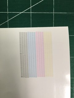

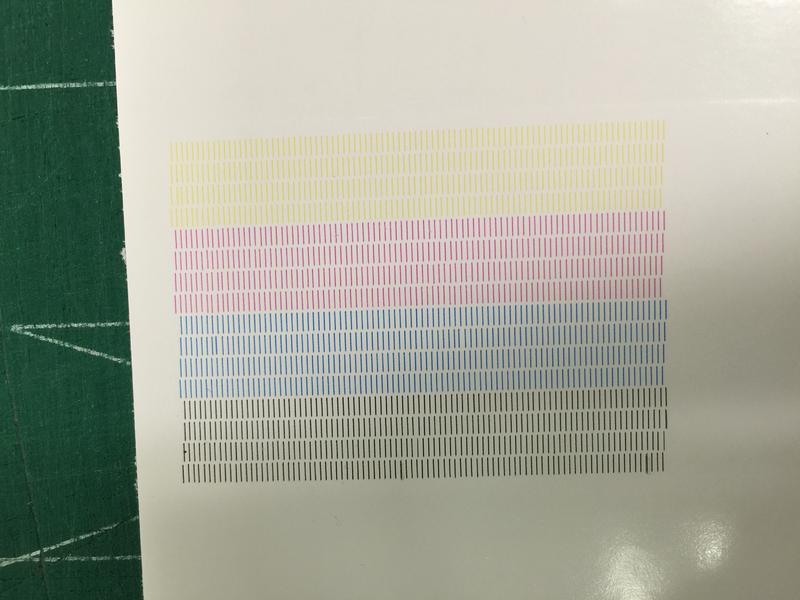

What does your test print look like now? posting photo now

Nevermind the cuts being off for now, that should be looked at separately.
answered the questions above & posted test print pic.

klingsdesigns
I have problems like this and they were .. Head height was up and had to lower it, humidity is my biggest problem. Also had a hair stuck to one of my heads and it was dragging across. Also i had one or two lines off in the print test and that little bit threw mine off. i have a vp-540
