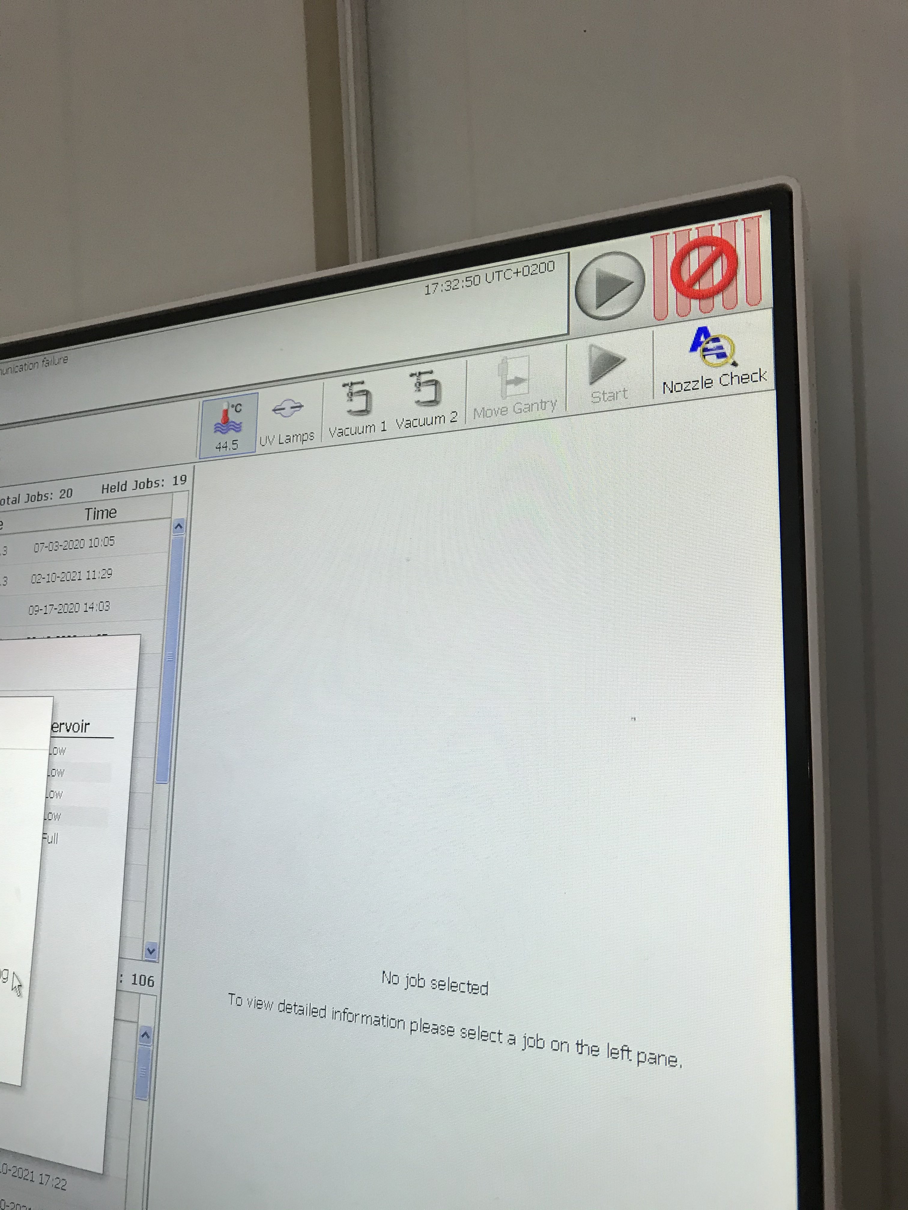

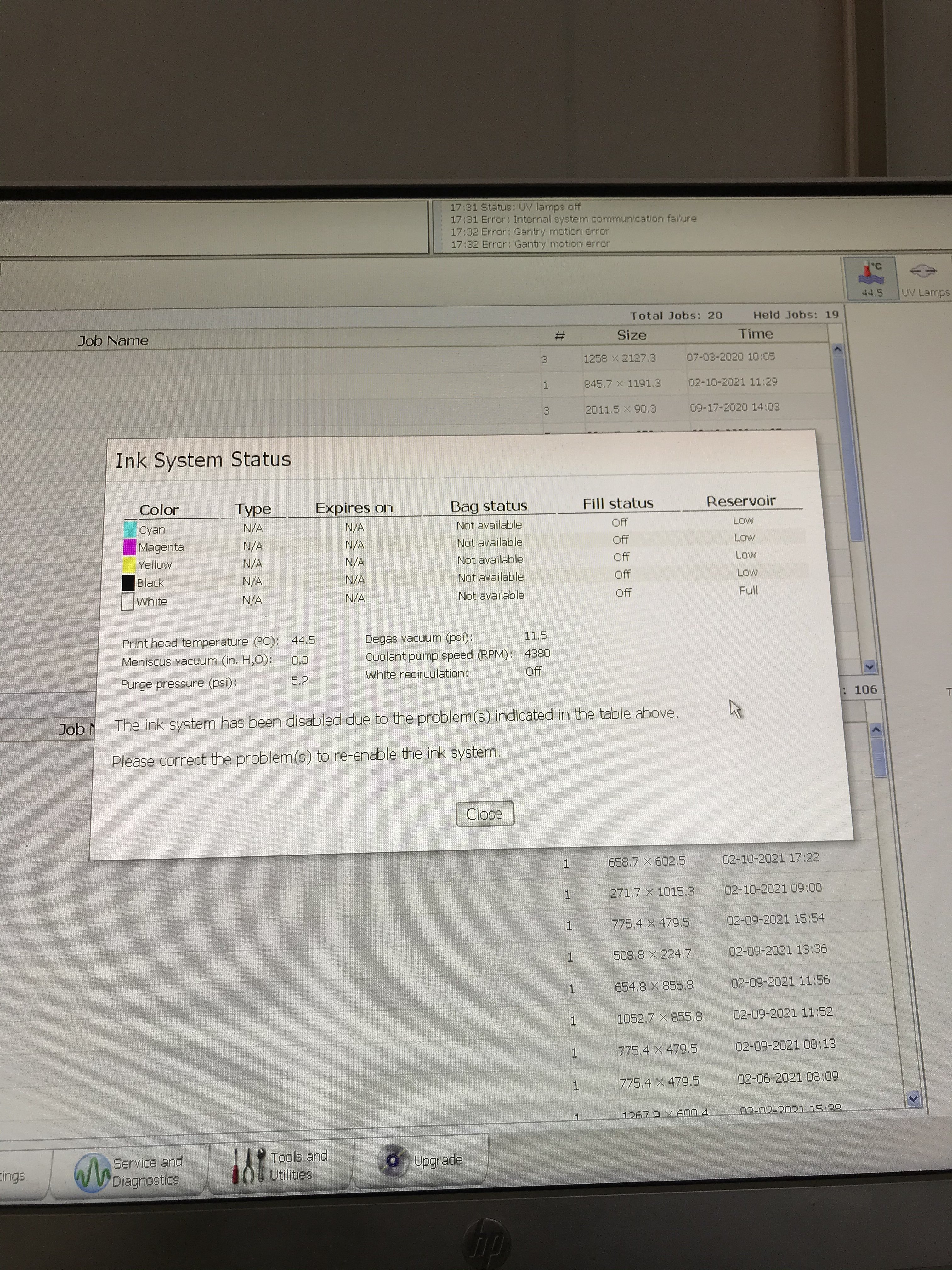

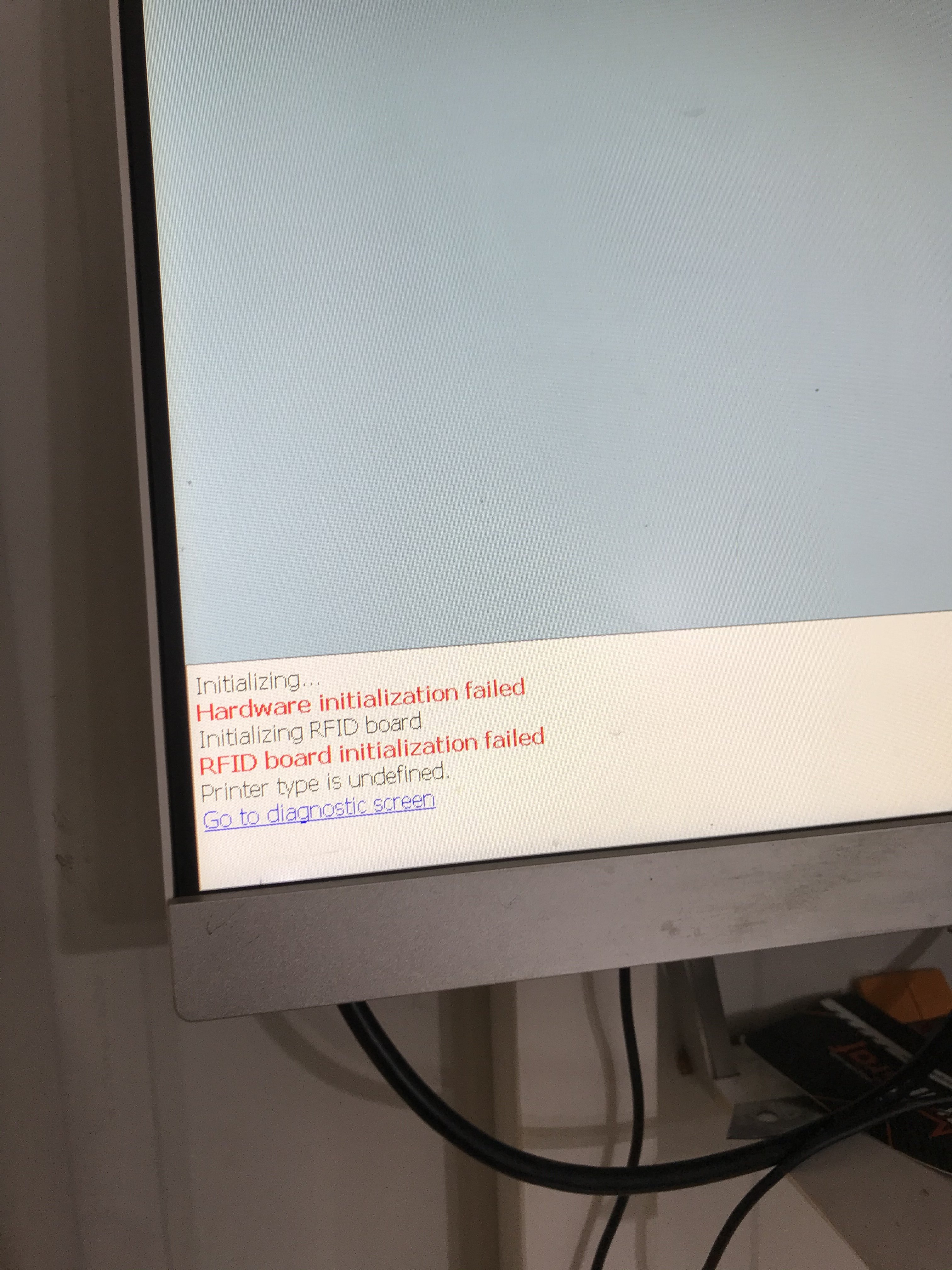

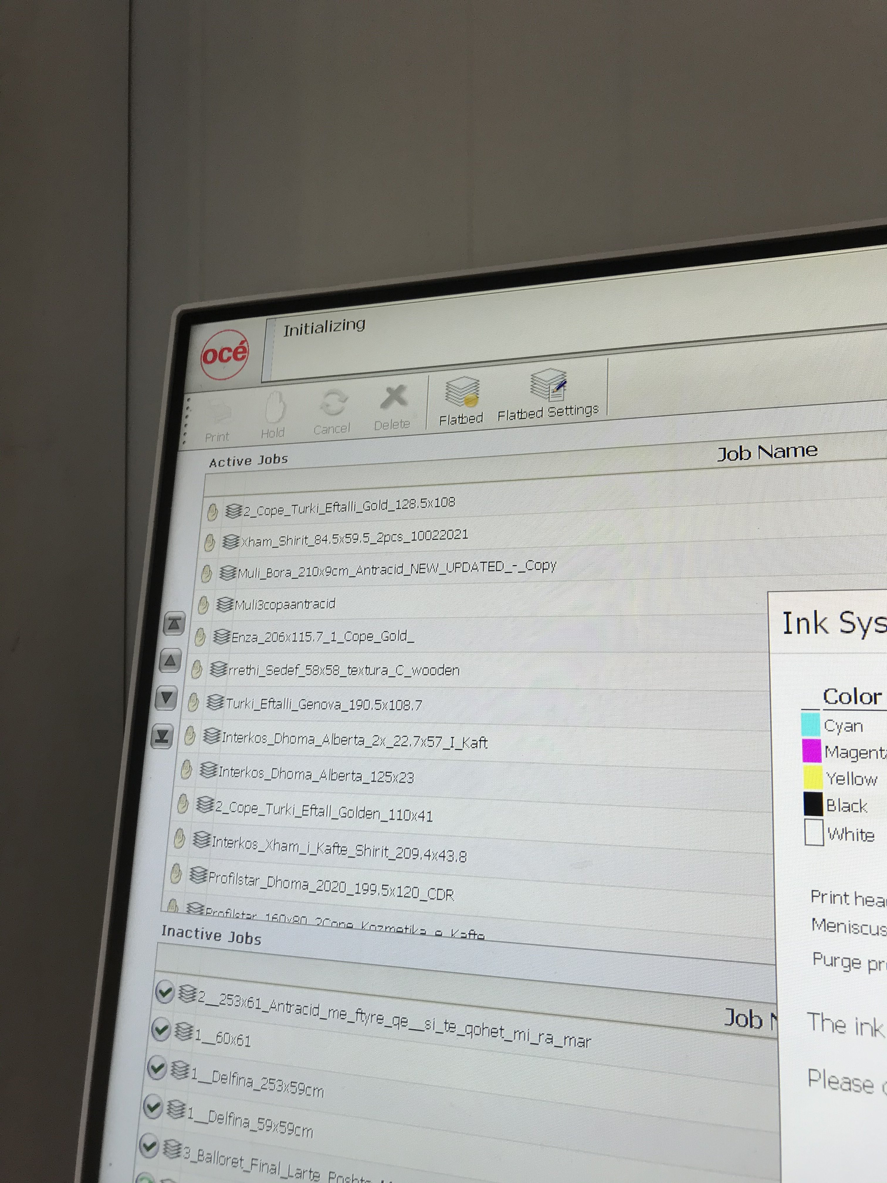

Hello everyone, we have an OCE ARIZONA PRINTER 550 and recently we are having an issue with RFID BOARD INITIALISATION. We tried to switch internet cables and some stuff but didn't work out.

Seems that your printer has a problem with internal communication. RFID board initialization is the first step of the printer initialization process after the restart and your board fails this test. It's difficult to diagnose this problem remotely, but if you could generate the log and send me this log in the private message here, maybe I could tell you more. Otherwise, you have to call the service and ask a technician to come, check the whole printer and search for the clues.
