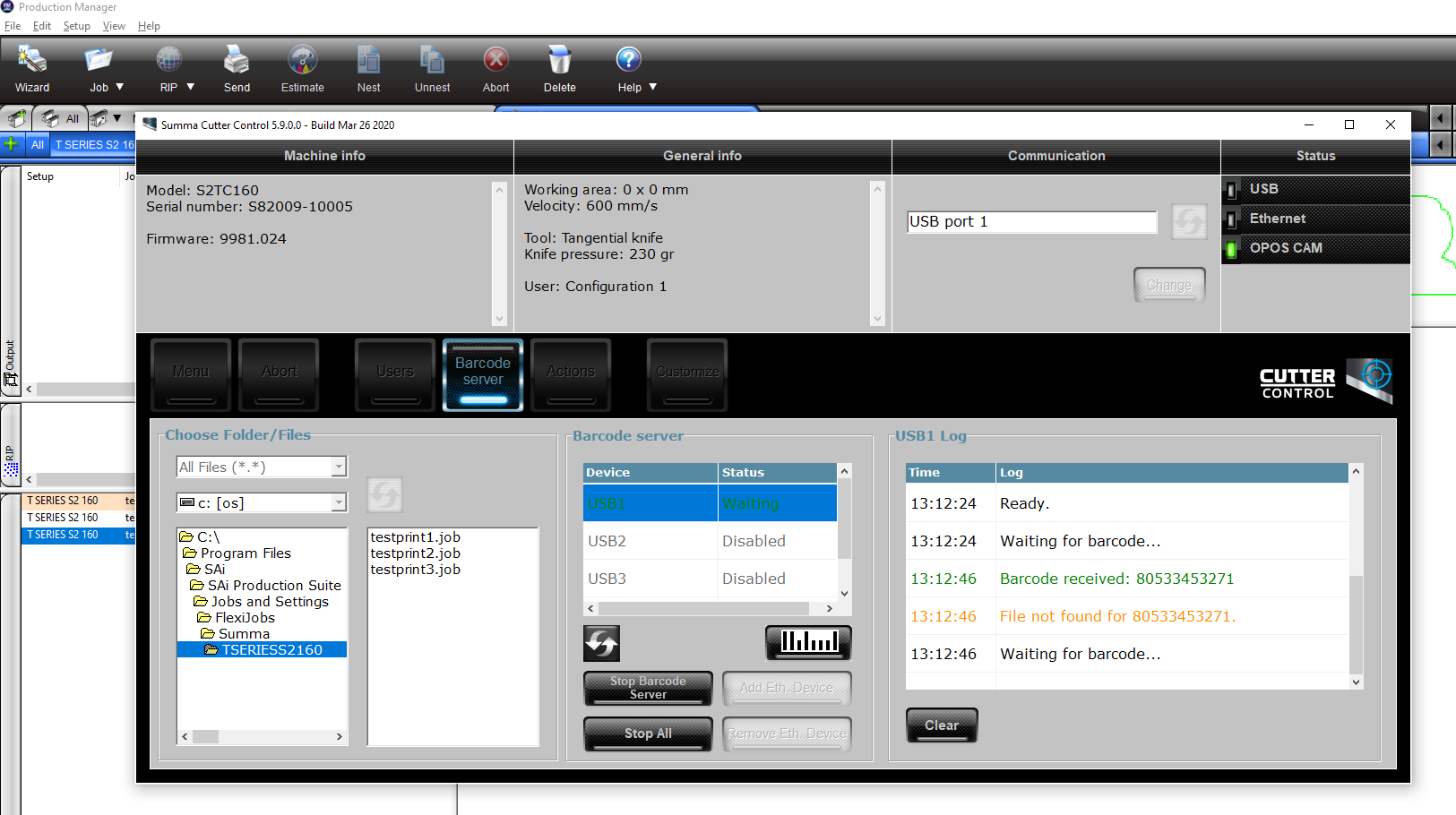

I need some help in getting Summa automatic barcode cutting with Flexi. We use the Summa S2 T160 OPOS Cam. In Summa Cutter Control, I am getting "File Not Found xxxxxxxxxxx" this is the barcode ID. Here are my settings and what I'm doing:
1. In Flexi I have OPOS Option as OPOS XY and Use Barcode checked
2. I print my file and the registration mark shows up just fine.
3. I am running Summa Cutter Control and select "Barcode Server" and Start Barcode Server
4. The file is pointing to the Flexjobs -> Summa -> TSERIESS2160 Folder. I see the files labeled as Filename.job
5. The cut files are in PM in the "Hold" Section
6. I click on the barcode Icon in Summa Cutter Control under Barcode Server.
7. The Log File window says "Waiting for barcode" and on the Summa screen it says "Set Tool Under Barcode"
8. I set the tool under the barcode and click apply
9. The cutter head moves and scans the barcode and then goes back to place.
10. In Summa Cutter Control, the Log Window says "File Not Found for 80533453271"
11. When I look in PM at the files sitting in hold, the barcode ID matches. There is a 80533453271 Barcode ID.
So what am I doing wrong here? Any help would be appreciated.

I verified the files are indeed located in: C:\Program Files\SAi\SAi Production Suite 21\Jobs and Settings\FlexiJobs\Summa\TSERIESS2160
This is the folder Summa cutter control is pointing to.

It is currently set to Summa USB. I created a new cutter pointing it to the new folder it created. Same outcome.
I get "Barcode Received: 80539625380
File not found for 80539625380.
