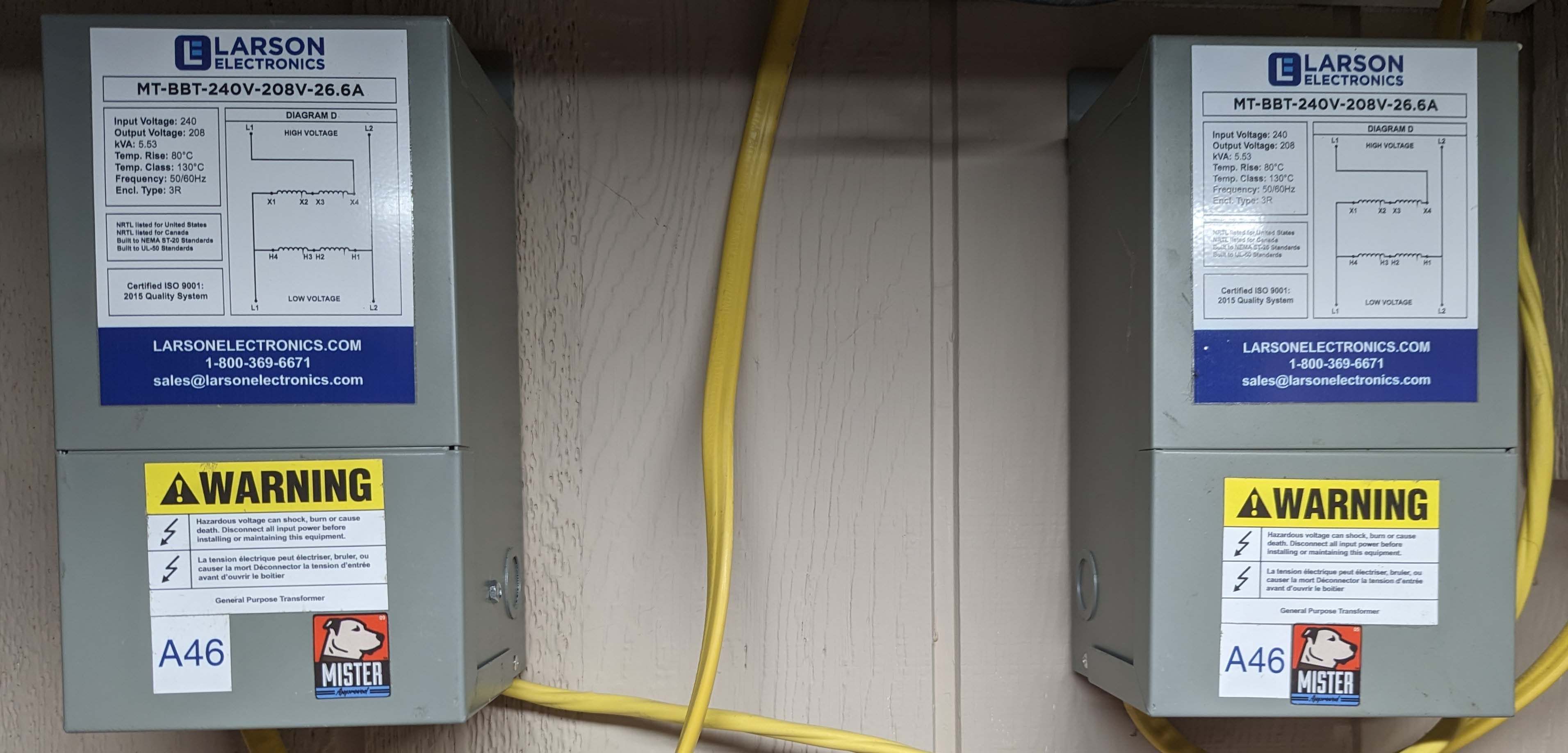

I am working on setting up my printer and have my voltage at 246 at the moment, HP allows range from 200v-240v (cannot exeed 240v). Was hoping to get any other people who have had this issue and see what you guys used to get the voltage down. HP has suggested getting a Buck & Boost transformer, but wanted to get any other options that would allow me to get this down easier than running the whole transformer route.
