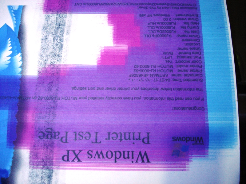

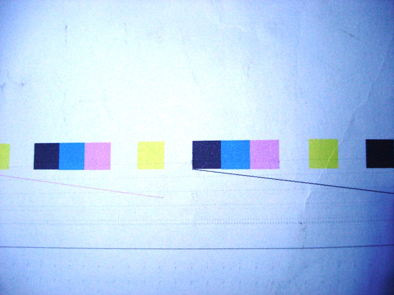

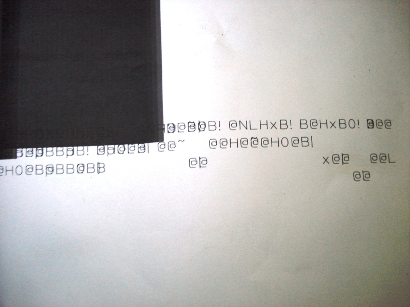

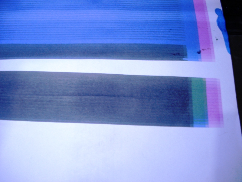

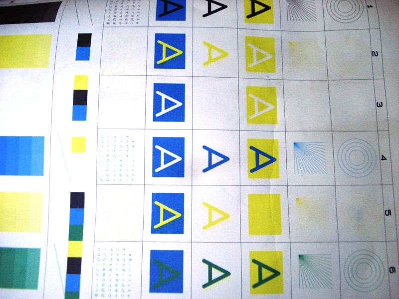

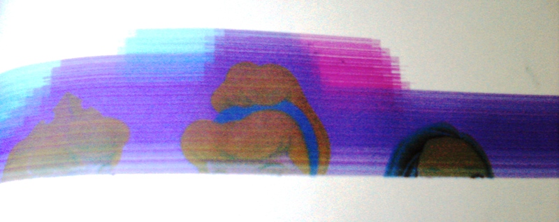

the print head are firing, and firing all the time all colors.
now all the print heads are firing, and firing all the time all colors.
all what you get after printing order is a nice 6 colors solid square
henryp
Could be blown fuses on mainboard or the mainboard itself, also CR Cables, Head Driver Board, or CR Sub Board.
astro8
post some pics
