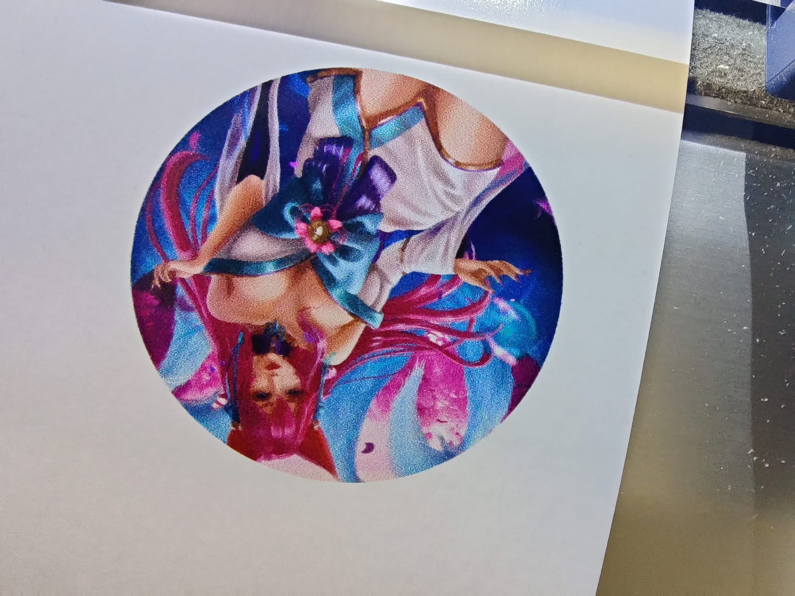

I need to print small round images of a designer's artwork for an artist. She uses them to make buttons. The images are 4x4 cm in size and are not vector files but very large pixel graphics. However, I can't achieve a good print quality; it always turns out very blurry despite being set to 4000 dpi and printed at 4x4 cm. I'm using a brand-new Epson 40600 printer. Does anyone have any tips for me?

The print was done with 16-pass uni directly over Epson Edge Print. I tried different profiles, but it looks the same every time. I generally get a grainy result with the S40 for too bright designs. The media is calibrated. nozzle 100% fine
what media is that? It almost looks like the results one gets when trying to use uncoated media with incompatible ink.
SLShop
This is a blueback paper film from Emblem. I tried printing the design larger as a test, and it looks significantly better, but it is still grainy, especially on the face and dress. Is this simply the maximum that a 4-color printer can achieve?

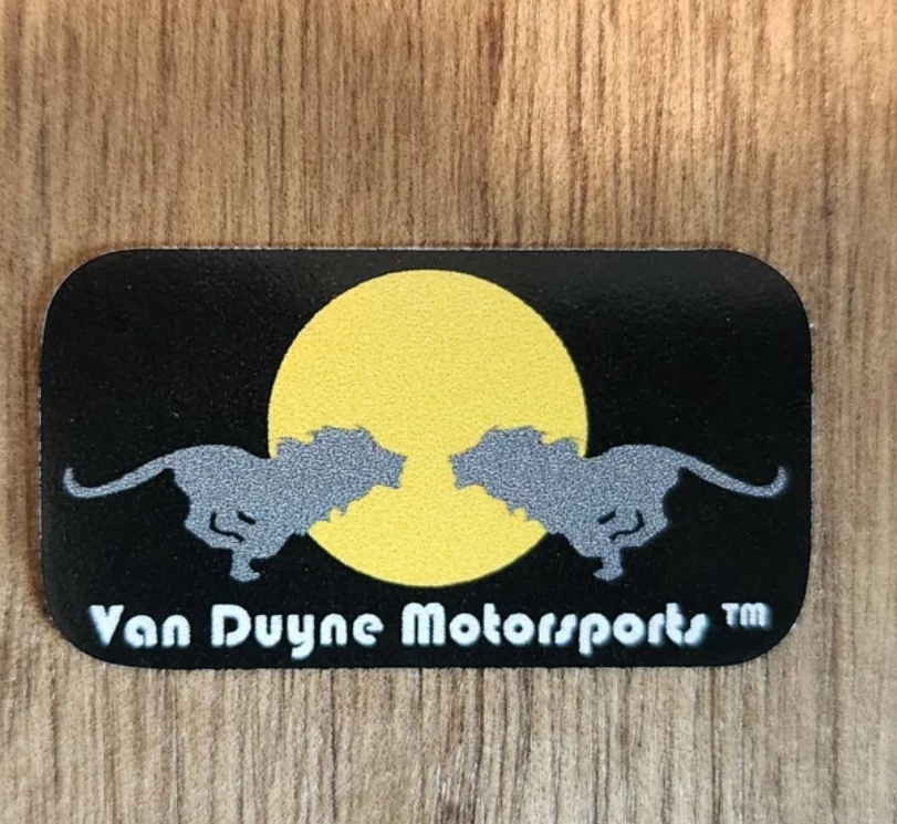

Here is how a small sticker looks printed on my Colorado, this is is 1" x 2" , photos make it look worse than it is and from normal viewing distance the sticker looks great and customer is happy. but the lighter colors are grainy
I have had customers in the past not happy because before they were ordering stickers printed on 9+ color printers such as the 80600 or Rolands and the 4 color looks horrible (grainy) in comparison
Light blue / pink small stickers I print on Epson R5070 because the LC and LM inks really make those colors less grainy.
