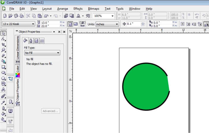

in coreldraw, can the cutline be filled? if not then it is not a closed path...there is a hole in it somewhere...
This is not true, you can fill an open shape, if it was set in the options. See attached screen shot!
