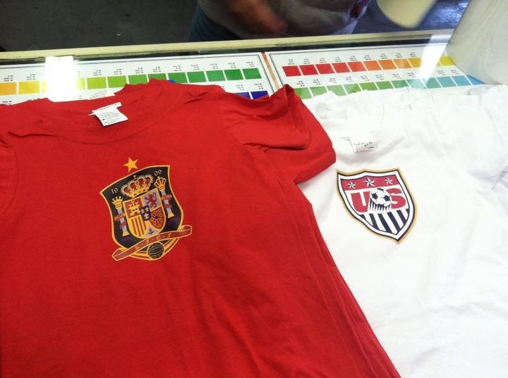

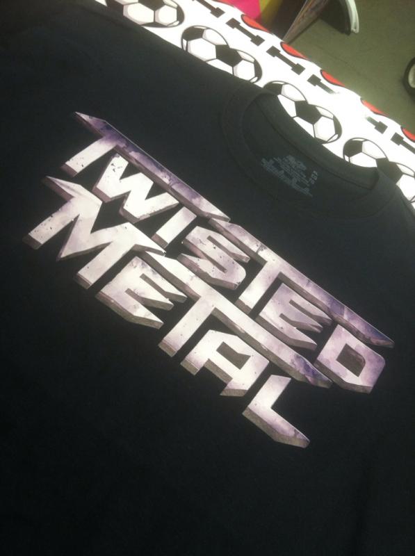

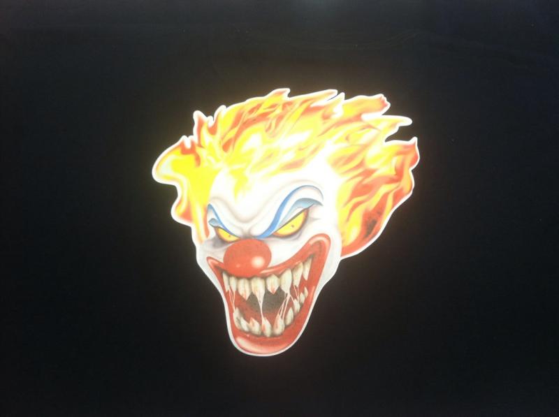

At first I hated using heat transfer and my roland but now i love it!
I got a "play" roll from Fellers. Its the rtape flexprint Tatto. The stuff is great.
Prints great and transfers great.
I tried it on pretty much everything I had
Made 30 shirts for a afterschool program I teach and they looked great!

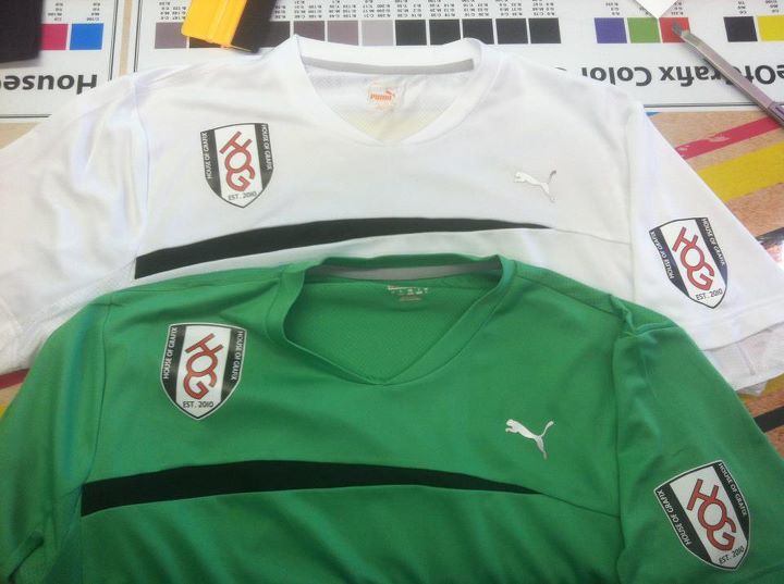

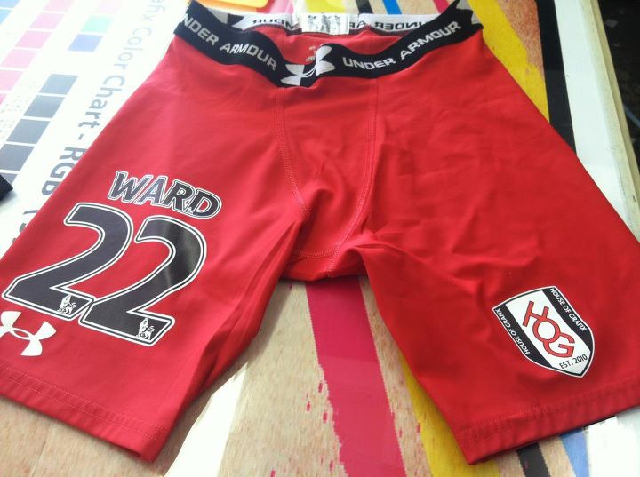

Works very good on jerseys.. thin and you really cant even tell its there
Made this for a buddy to test

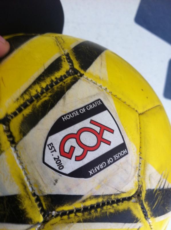

Even tried it on a ball
It has lasted for a long time already!
