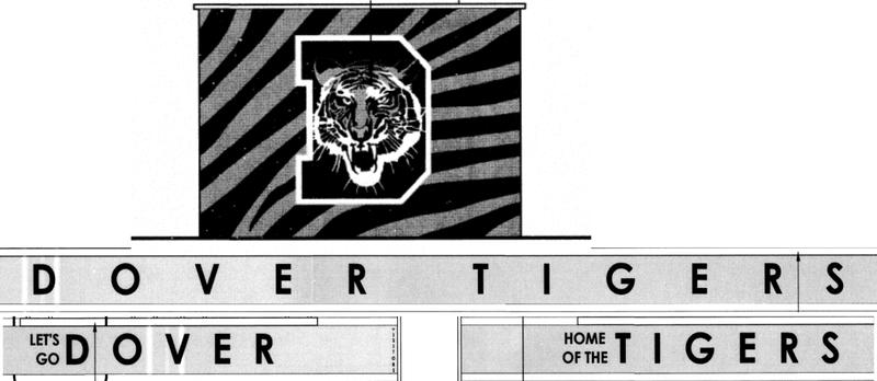

I am being asked to quote a 12ftx17ft mural on masonry. i only have a black and white image, but it looks likes its going to be about 5 or 6 colors. We will also have to paint upper case, block font letters, qty 22, 19" tall and qty 15 8" tall letters (actual area is 19" by about 70ft) that are white with a black outline, also on masonry. The letters are going to be waist-high, so no ladders are needed. The big mural is ground level, so we only need scaffolding for the top half.
We will pounce the letters and paint with an appropriate brush, I'm not sure if we will need to pounce the outline or if we'll be able to free-hand it. I'm going to assume it will also be pounced.
My question is, how many hours do you think this will take? We've never painted anything this large outdoors. I'd say we are average speed at painting.
I'm guessing at least 4 or 5 days for the mural , and another 5 days for the lettering. So about 80 man-hours to complete the job. What do you think?
That sounds like too much time, based upon what you've explained. Can you post a picture of it. Afterall, we are a visual bunch.

Something like that, I'd pounce the copy and just paint it on. For all that copy about 2 hours to hang it, another 1/2 hour to pounce it and about 2 to 3 hours to letter it and another 2 hours or so to outline it.
Then later, the cat's head and surrounding area.... is it possible to use an opaque project and draw it on ?? If so, looks like it might take an hour to shine it up and draw it in. Next day, come back and I would imagine a long day or 2 short days and that would be painted in also.
All-in-all about 25 to 30 man-hours max for the entire thing, other than your creating the pounce pattern in the shop, which might be about an hour, cause we use ours at a snail's pace when pouncing.

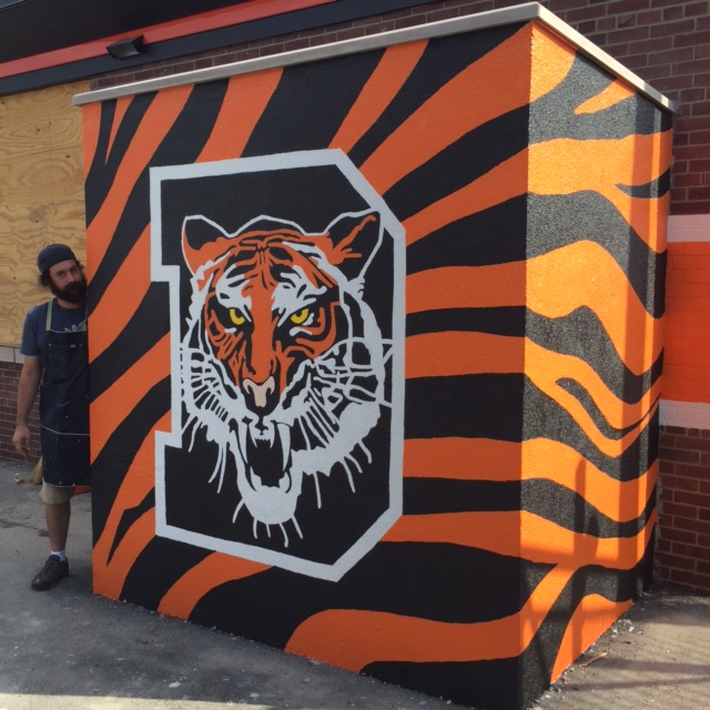

Pounced the tiger, free handed the stripes. For some reason I don't have a completed picture of the rest of the lettering, but that was pounced too. The client was happy, and my original time estimate was a bit high, but still longer than a few people suggested. This part of the project took about 20 hours onsite and the lettering was close to 16 hours on site. We spent close to two days prepping everything in the shop.
