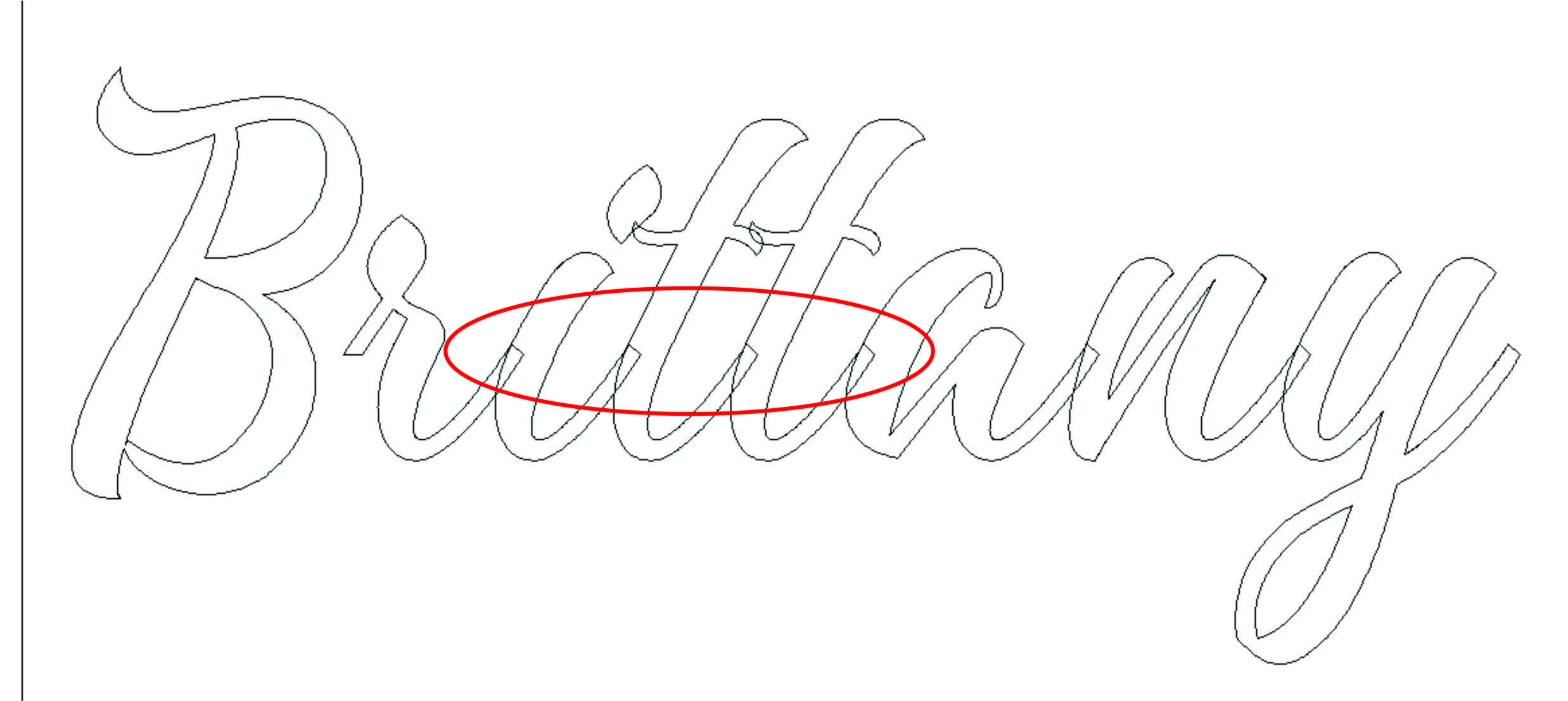

I'm doing some vinyl cut lettering with my Summa Cutter. I'm using CorelDraw software.
I'm trying to cut some script lettering. However, the letters overlap and one letter cuts into the next letter. See attached photo. I'm just wondering is there a way around this?

you need to unite, merge, combine the paths together. There are many names, not sure what Corel calls it - probably "weld" as said above.

I tried them all and it didn't work. I tried Combine, Weld, Trim, Intersect, Simplify. I get the same result when I pull it up on the Summa Winplot window.
After typing out the name, I had to convert the font into curves. This allows me to get to the Combine, weld, trim, intersect functions. Am I doing this wrong?
Been a long time, but is there a command after welding called 'expand' or something similar ?? Make sure the width is set to 'hairline'.

First you need to "Break Artistic Text" from the "Arrange" drop down menu. Grab all of the text using the Pick Took. Then you need to "Convert to Curves" which is also in the "Arrange" drop down menu. Grab all of the text again and then click weld.

I'm using CoreDraw X8. It was under Object for me. However, the Weld feature did not work for me. I got the same result as before.

Are you selecting all of the artwork? Try the direct selection tool, and select just the areas that over lap, then combine (weld)

Select text > object menu > break artistic text
Select all of that > object menu > shaping flyout > weld

This worked! Thanks for everyones' help.
'Notarealsignguy' solution did not require that I convert the fonts to curves. When I tried it before, I had to convert the font to curves before I got the Weld option. Since I did not convert the fonts to curves, the welding option worked.
