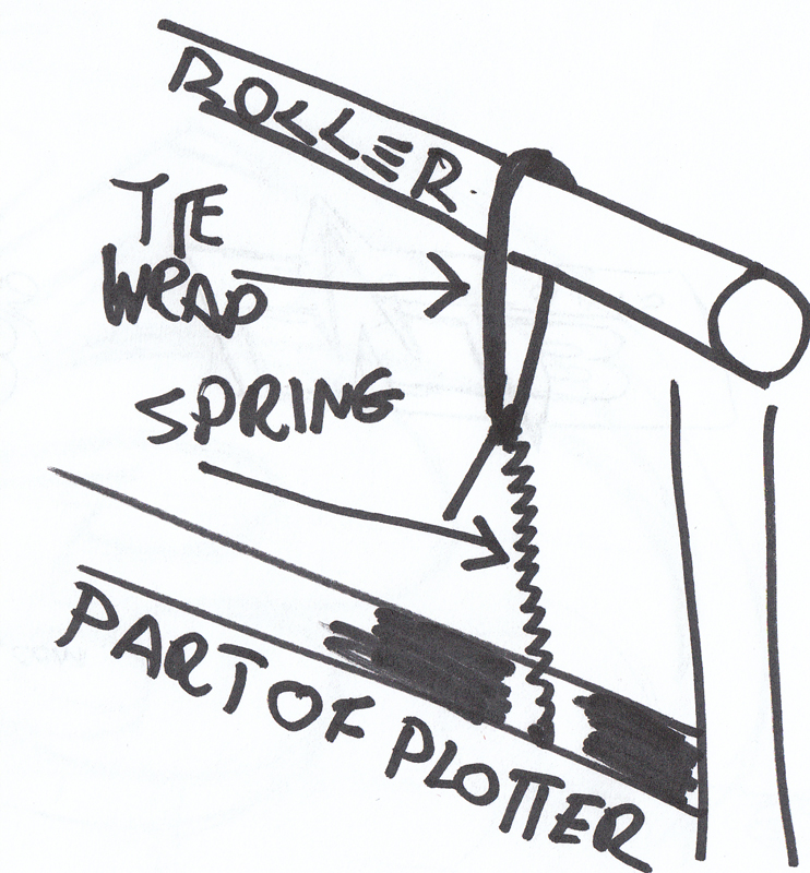

i assume you mean the vinyl is "unrolling itself" while your cutting ...i had that problem with halographic stuff before .anyways heres a simple clutch to keep the roller a bit loaded with tension ....go to one end and put a tie wrap loosly around one of the rollers ...get a long spring at the car parts store ..light duty ,nuthing real big ,,,find a place on the plotter to hook it, i had to drill a small hole in one of the legs...just make it a "light tension",,doesnt take bit i little bit ....itll work ..done it on 2 of my plotters and all my buddies too.
please no bashing on the quick sketch with a sharpie here ..just trying to help this cat while watching baseball.
