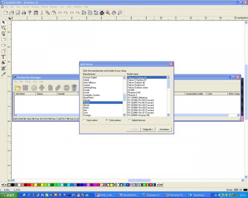

Screen shot from Flexi 8
In manager go to ADD SETUP (cntrl+N).
Go to Mutoh and select your printer and follow the steps.
does it print?
If not let us know your steps until your blocked.
Paco
Graphics2u
Have Flexi 8.1....can't get it to run the Falcon. I have been running a SC 540 for about 8 years with Wasatch. I am new to the Falcon, the Wasatch I have doesn't support the Falcon. Does anyone have a used rip I can buy?
What version of Flexi 8.1 do you have? Sign, Designer, PRO? If it doesn't have a RIP it won't run it, it's only meant for cutting.
