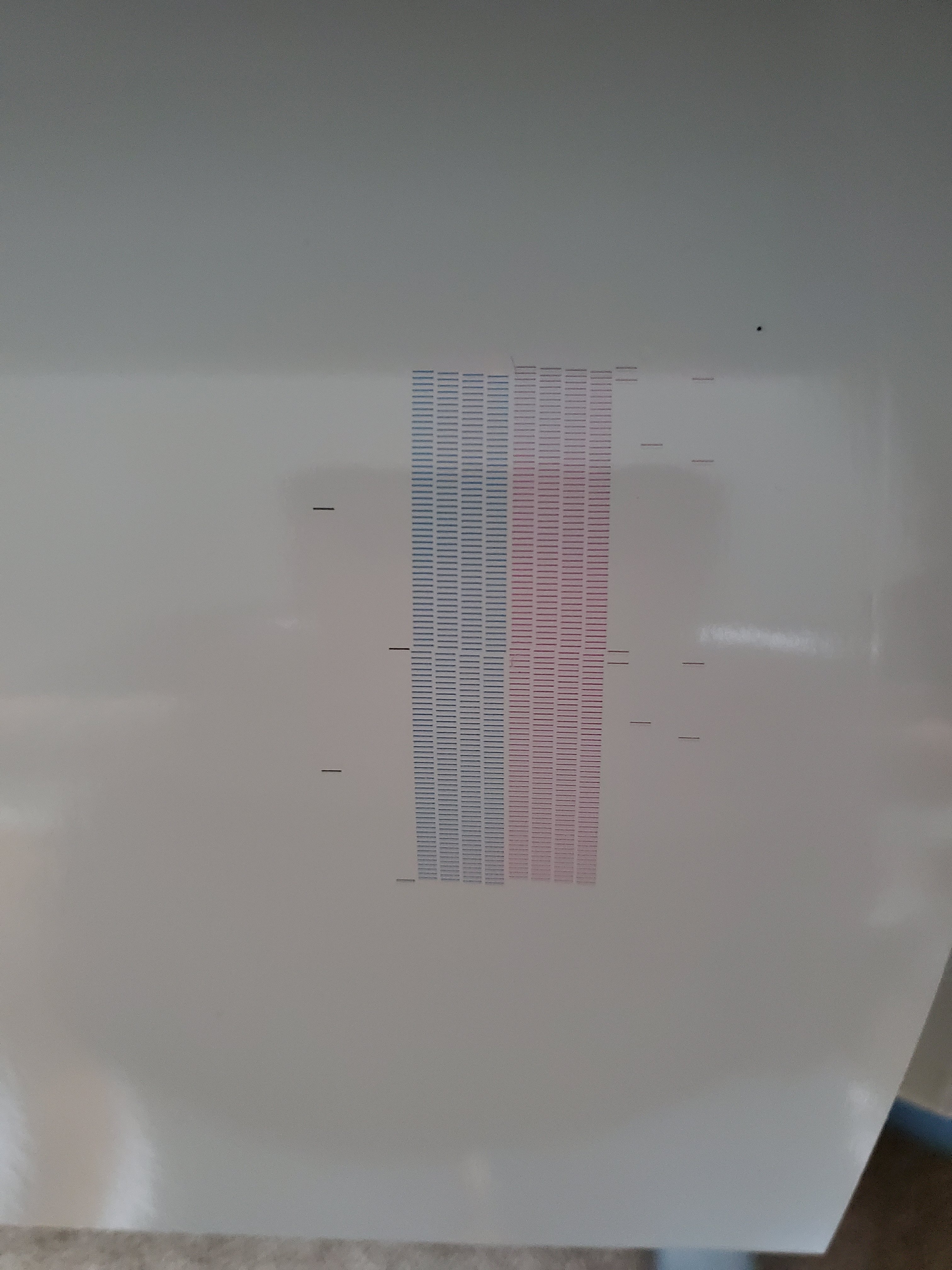

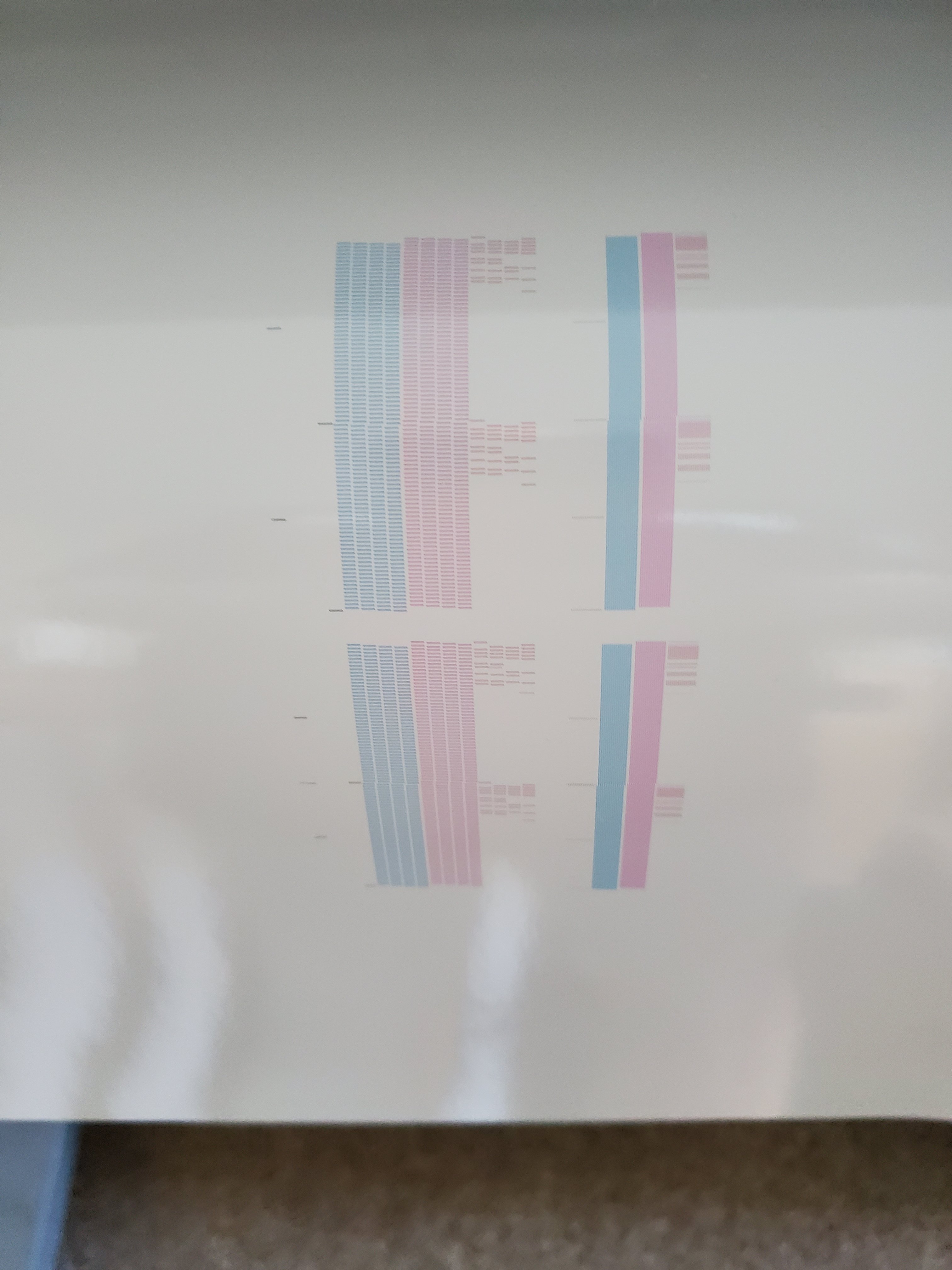

So, I got the printhead in, then my tech said he couldn't install it until next week. This is the same tech who taught me how to fix all the parts in my machine that I have throughout the years. I asked him do you think its something I could do - I saw a video online? He said absolutely and if you have any issues just text me. So, I manage to get it installed, following the video - but when I went through the steps - this is what I got. Of course now he doesn't answer my texts and I NEED HELP! Anyone have any ideas? Sorry if the pics are bad, the lighting in here sucks.
Just to confirm, after you installed the new heads, you changed the serial numbers? Also I assume you did a powerful cleaning after you filled the heads with ink? One thing I can suggest if you've done all that is connect a syringe to the cap top line and pull ink through the heads then do a regular cleaning and then a test print to see if it helps.
yes, that is exactly what I was in the process of doing, and guess what - I went back to check the damper to make sure it was sitting right and it snapped the stem right off in the damper. Now I'm trying to figure out how to take that part from the old one and put it on the new one. I have had such bad luck this week it just isn't funny anymore.
