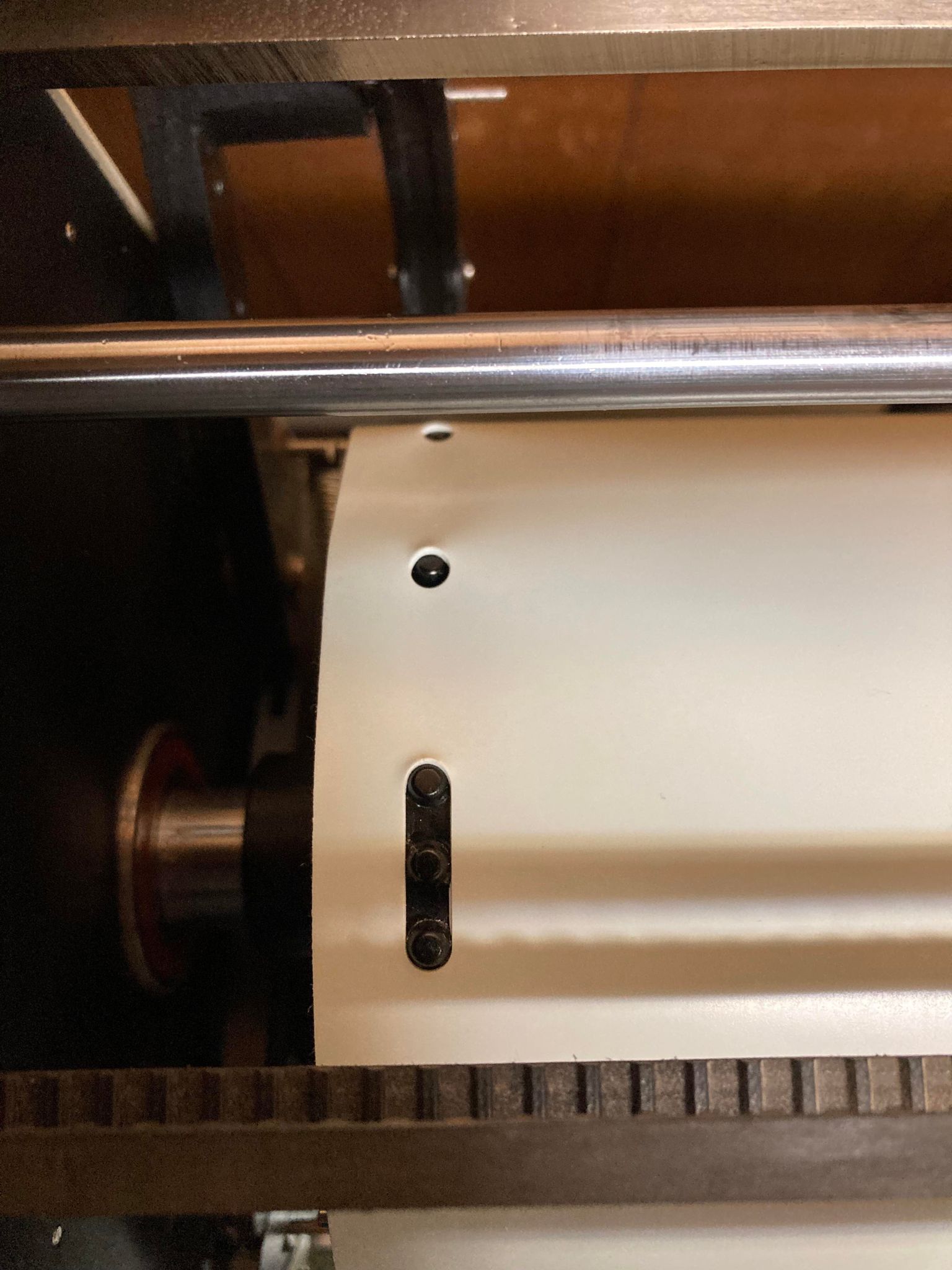

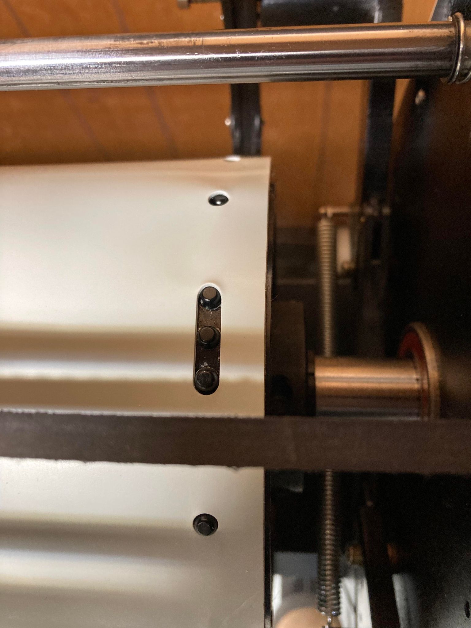

Hartco is now making a double liner sandblast stencil. We are currently using it and it works pretty well for our needs. There is an issue with the blade depth on our GS750plus plotters. I am having to put the depth at 7 on blades that are just a couple weeks old. If this keeps up, we will be going thru a lot of blades. Anyone having the same issues? And it still doesn't cut like the 3M. Sure miss that quality. Also, the Hartco gerber punch isn't quite accurate. On a couple rolls, some holes towards the end of the roll have been too small just enough to make the roll come off the machine. Anyone else having this issue? I will be contacting Hartco about the gerber punches hole issue

To me, your hole problem appears to be more of an alignment issue rather that hole size itself. I'm guessing the tension is set too high on their equipment, and it is springing back after punching. Hartco definitely needs to be notified of this issue. It also might be that the material continues to shrink after punching...but that wild guess seems to be way out there and doesn't explain why most of your material is good.
One more thing....there should be ABSOLUTELY no way that you would want to be on a #7 setting on your plotter. That's setting yourself up for some real damage to the drum should the knife inevitably hit a soft spot. I've rarely gone over # 4 with a dull blade and Anchor material.

Thanks you James Burke for your insights. We have some Anchor on back order, who knows when that'll show up. Have heard the U-Blast is crap so we will probably stick with HARTCO unless several roll give us the same issue. And we are going to look to see if there are other blade brands that might work better... fingers crossed! Have been able to back the blade (to 6) on the machines slightly.
