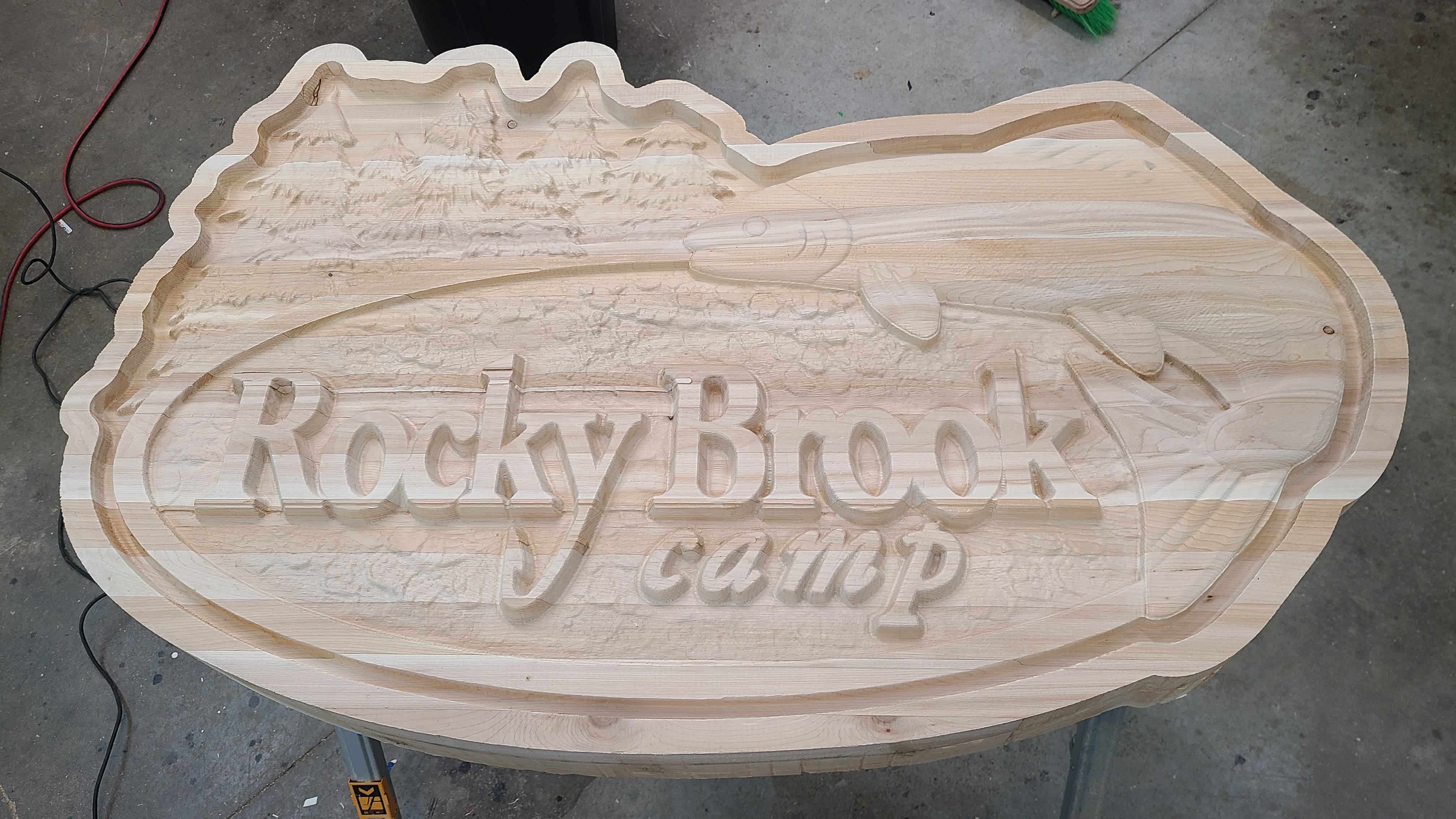

Okay, maybe this will jog your memory.
The two grey areas are some kinda patch job and any kinda staining or home brew, will show up totally different in those two areas. The mauve area, I don't know what is happening there, but it doesn't look good from what I see.
To create the effects your customer wants is easy. First, no torching it, unless you really are familiar and good with that technique. You can ruin it in seconds, otherwise. For the trees and other similar areas, just use a 2" or 3" nap roller. Not foam. Just roll your roller on your palette slightly. Don't saturate it. Roll ever so lightly over the desired areas. If it needs more, do it again, until you get the depth you want. I've done that many times. The other easier method would be to use a rag, like a wash cloth and dab it in whatever you're using for coloring and again, don't saturate it. Now, stipple the areas. This works better, but takes longer.
Do not seal the wood before doing this or the stain will sit on top of the sealer and not penetrate into the wood.
Again, those areas I pointed out are gonna stick out like a sore thumb.
Only thing that can save it would to be a paint job.
