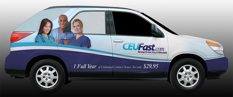

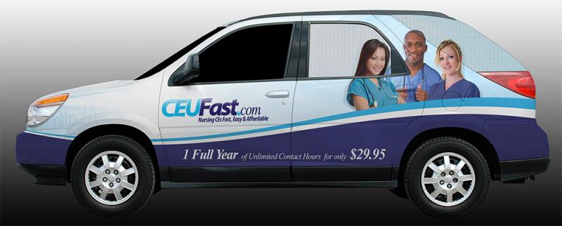

We just finished a full wrap on a 2003 Buick Rendezvous. We are in Lake City, Florida and need an experienced vendor to print and apply the wrap.
Any suggestions?

I would change the front bumper layout for the installers sake. That pin stripe around the grill and such is pretty much a nightmare.
briankb
If it is printed, why is it any more difficult than the dark blue lines?
I don't expect them to use actual pin stripes.
Do it with a differant peace of cut vinyl.
If I was driving that I would roll down the back window all the time so it would look like her head was cut off...
SlightlyChilled
Do to the fact now you are trying to keep 2 line striate not just 1 line. and keeping them lined up on the sides around the bend

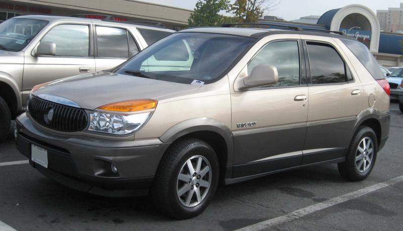

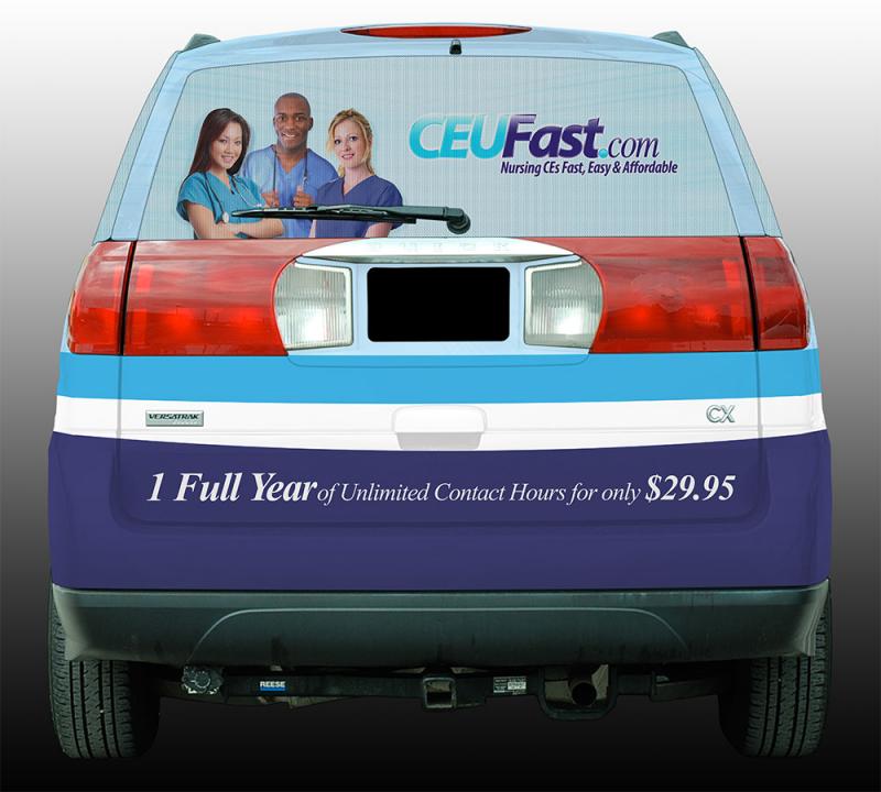

Do you have a picture of the vehicle so I can see the curves? There is more to print here than just the square area. That back bumper is going to have to print in a piece separate from the tailgate to keep it all covered and I can't see how curvy those rear sides are, but it can distort a lot on install...

Ever try to wrap compound curves with lines and trying to keep them straight? Just because it is "printed" doesn't mean it is just magically going to look like the picture.
The rear bumper is not as bad how you have it but even then the picture and the template you are using gives a false image of how a wrap like that would actually take place. That is a 2D picture..You have to consider 3D of installation when designing. Or if you are like most designers and do not care about the installer then your design is great!
Thanks for your input, I've attached the photo your requested.

My experience has not been good with wrapping the black plastic pebbly parts of this type of vehicle. I've not seen this one up close, so I don't know where exactly those lines fall. Maybe prowraps can chime in - it just may be we don't have his experience - but I avoid those when I lay out my design. What parts of the vehicle aren't smooth?
The other thing I'd look at is the curve out around the wheel well - you may see some distortion in your dark swoosh edge... it looks like it lays over the top of it a little bit.
The other thing I might do is loose the fade on the top and just do printed, contour cut vinyl instead. Would save money and the breaks from the top to the sides is clear enough I don't think anyone would even notice (unless the blue is a lot darker than shows on my screen)
Just some thoughts from the designer/printer end

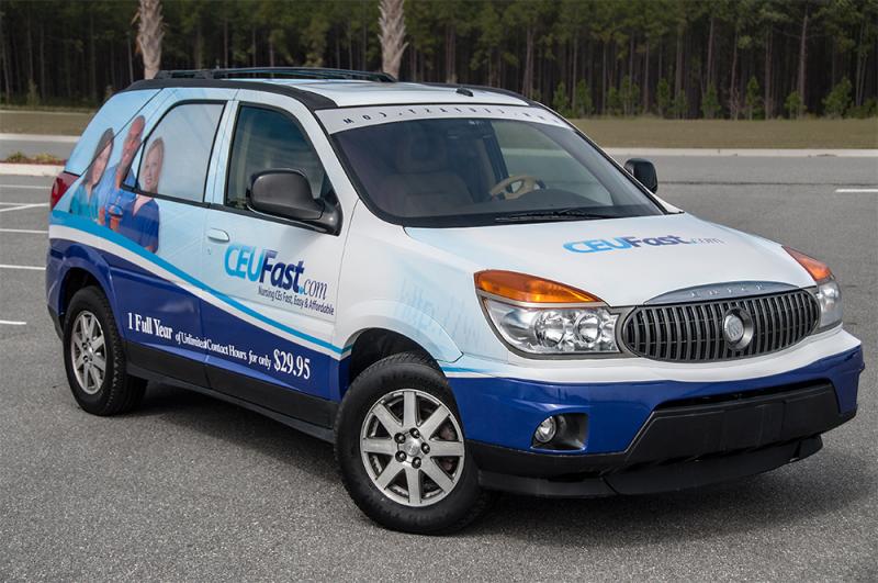

We picked up the completed wrap late last week. I'm fairly happy with it but there were a few issues with the printing and a few corners were not wrapped properly. We will wrap another one in a few weeks for the same client's business partner.
