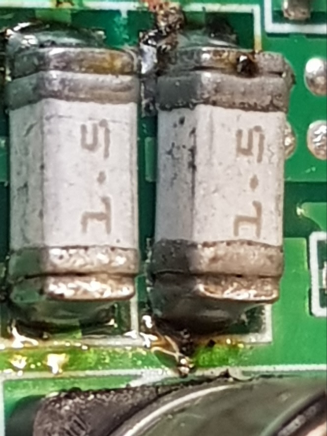

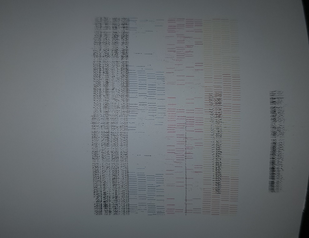

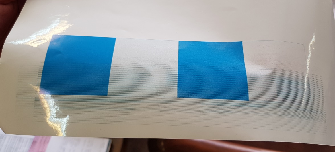

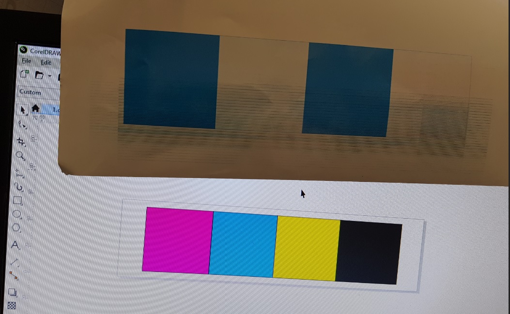

Hi, my device got into trouble after a long time, it did not print at all at first, after I searched the Internet, I replaced the 4 Ribbon cable , and also had two fuses on the main board (shown in the attached image), the head They are perfectly clean and all the components are supposedly normal, but the printing is not done properly. (Image samples are included in the printout). Please help me

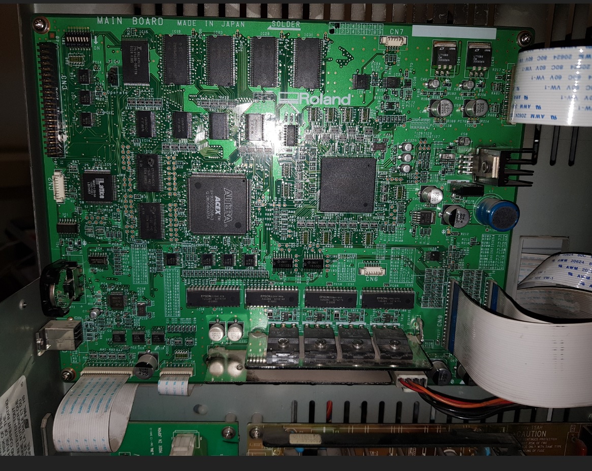

Images of check nozzles, 4 cables and 2 fuses were replaced, each of the 2 heads was cleaned with a special wash solution. The nozzle colors of the check are very pale.

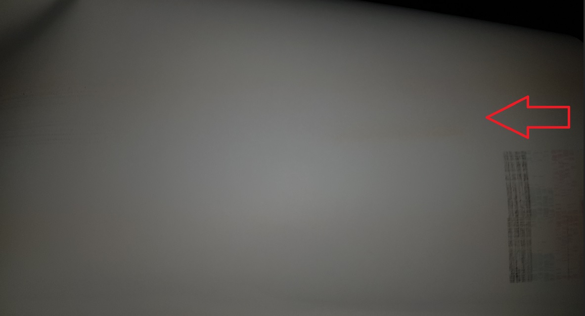

Also, in photo 5, after a checkout nozzle, a print sample is sent that is very poor quality (with the specified arrow)

The fuses are checked. They are healthy
Is it possible to fuse? The factory fuse is 1.6 amps, but replaced with a 1.5-amp model last week.

I duno what to make of that test print. Kinda looks like magenta is bleeding into yellow and half of the nozzles are not firing...then again you got all the black with that digital static looking thing so ... I duno.

You need new heads. replace heads, dampers, cap and pump. Start with pump first see if it gats any better. The magenta damper is bad (leaking).

no it is the heads. The main board is working or you would not get any ink jetting. It's the heads.
