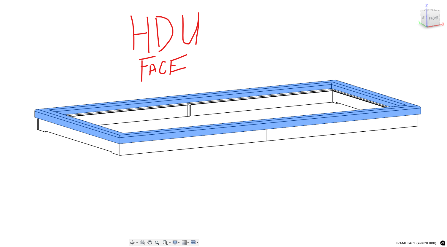

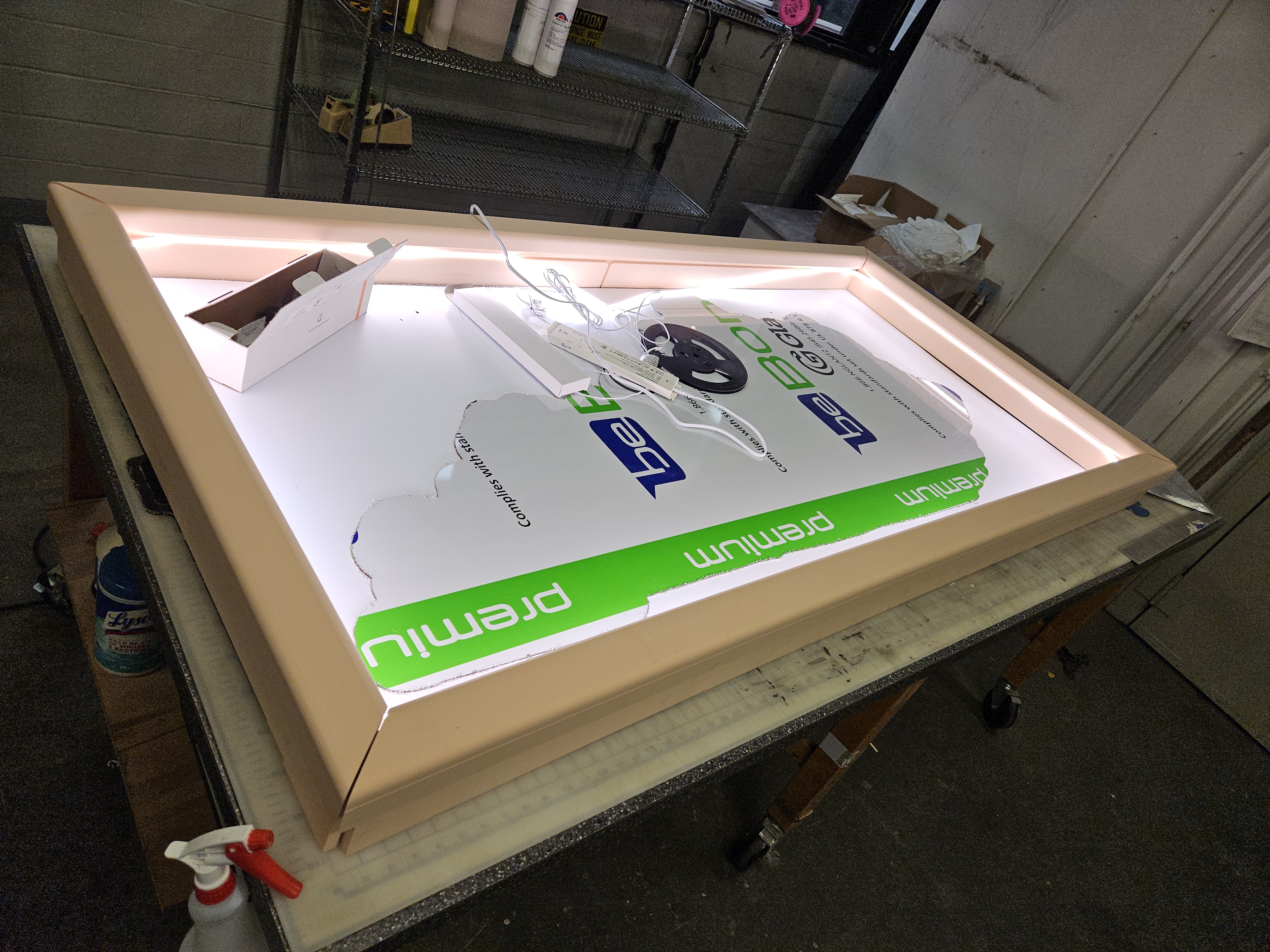

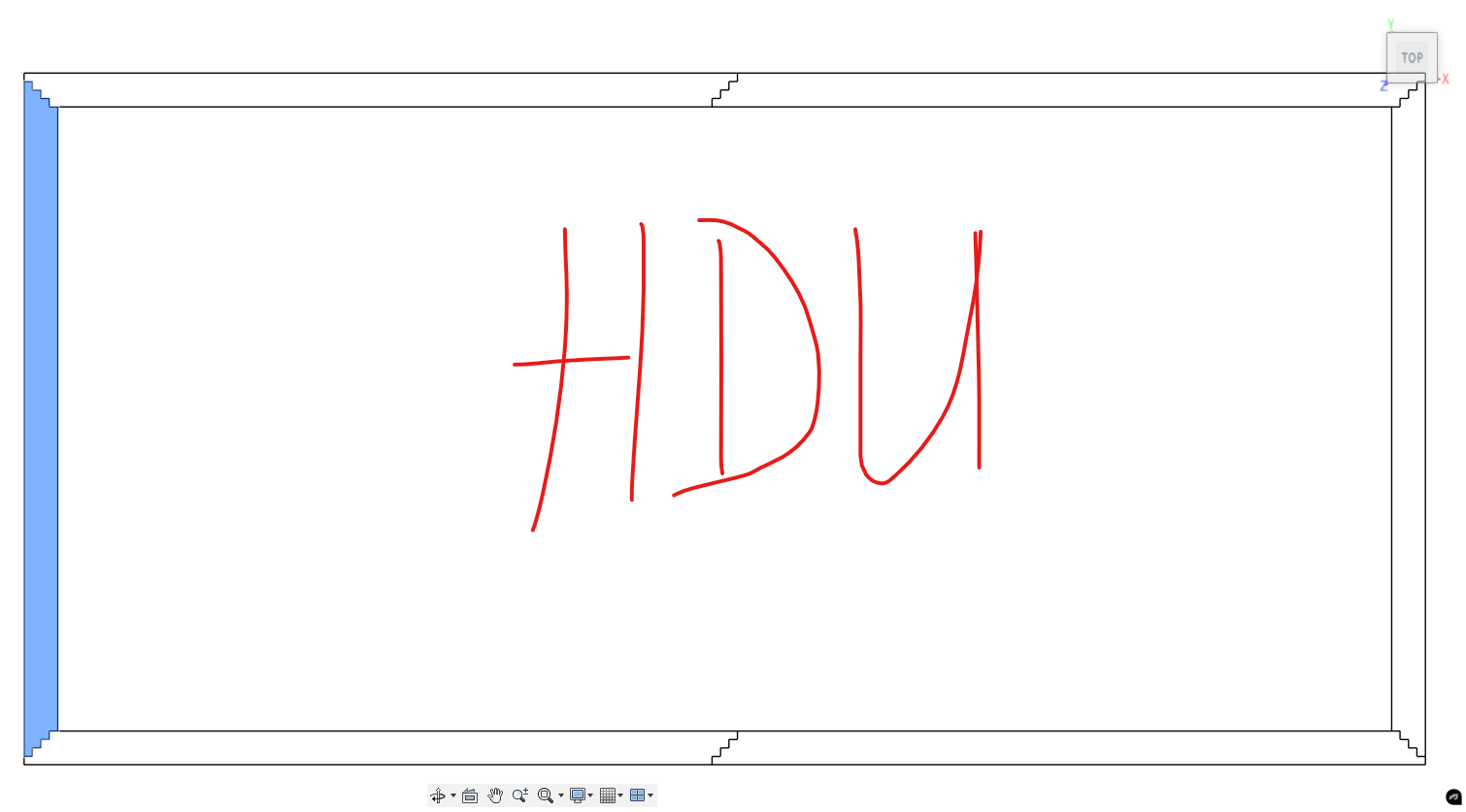

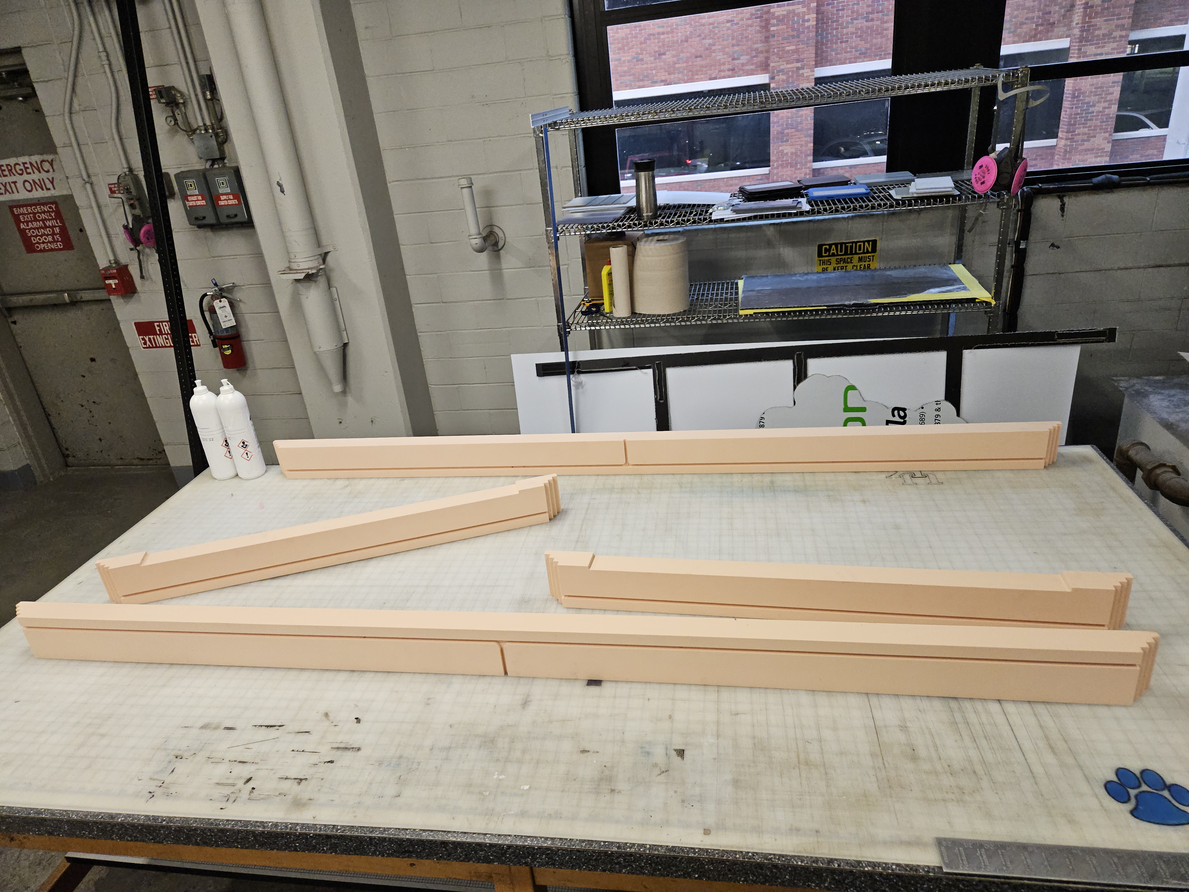

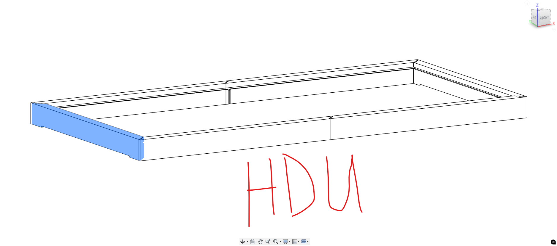

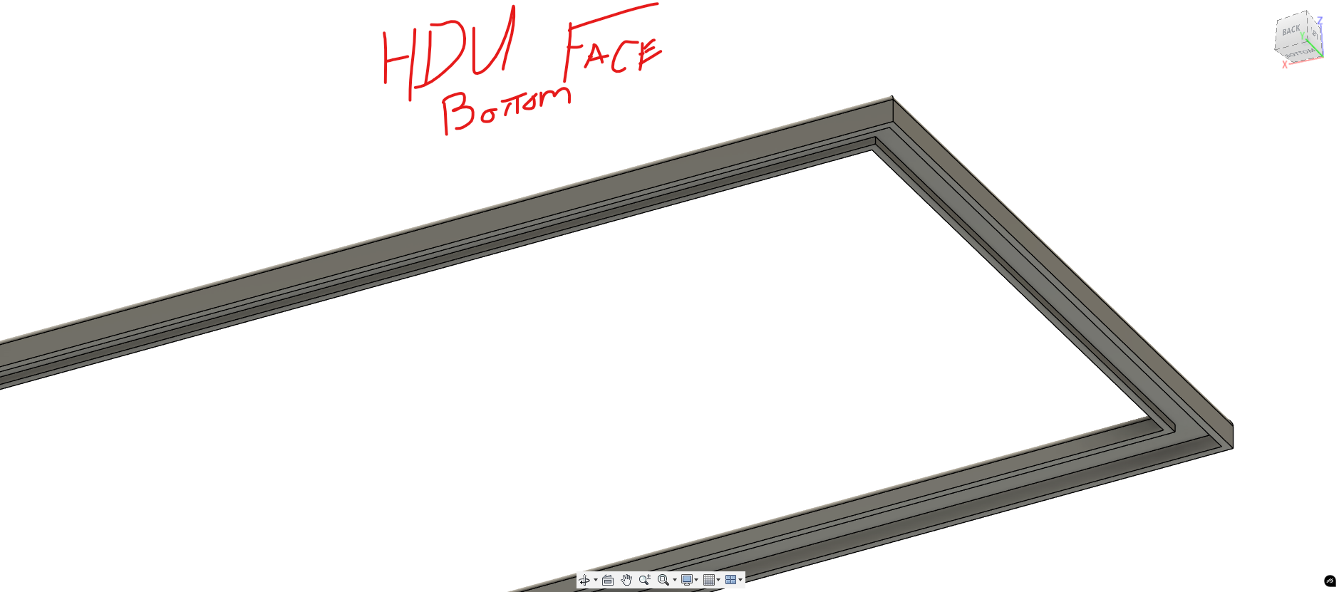

I've been assigned a very unfortunate job by someone extremely high up at the place where I work. The assignment, a 42" x 84" shadow box from 20# HDU. I've designed all internal elements to be attached to the wall separately, so the HDU frame will only be supporting a piece of .25" acrylic that weighs roughly 40 lbs., plus the weight of the HDU frame. I'm going to reinforce the frame with 3mm ACM from the rear, and then it will be primed, painted, clear coated, and wrapped in 3M DI-NOC vinyl. My questions are as follows:
• Once the ACM is glued to the HDU, will that be strong enough to support the 40 lbs. of acrylic and roughly 30 lbs. of HDU that makes up the frame?
• Can I mount French cleats to the ACM after the finishing work is complete?
• I'm assuming a point setter won't work in HDU, so is there anything else I can easily use to secure the acrylic in the HDU frame?
This frame needs to be easily removed from the wall to service the internal LED lighting in the HDU frame, as well as updating the printed map that will be behind the acrylic. TIA
