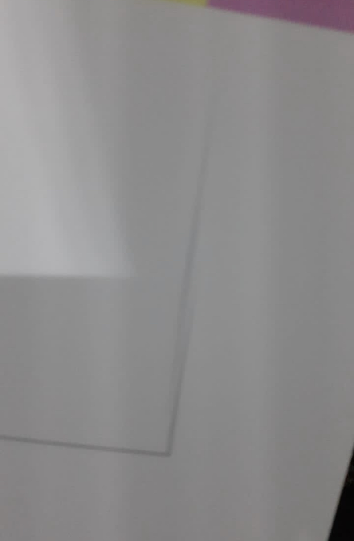

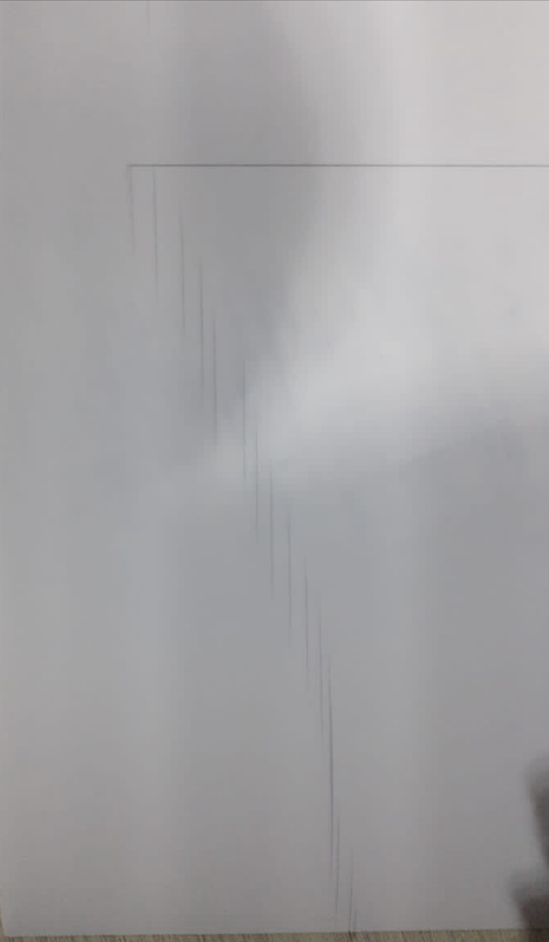

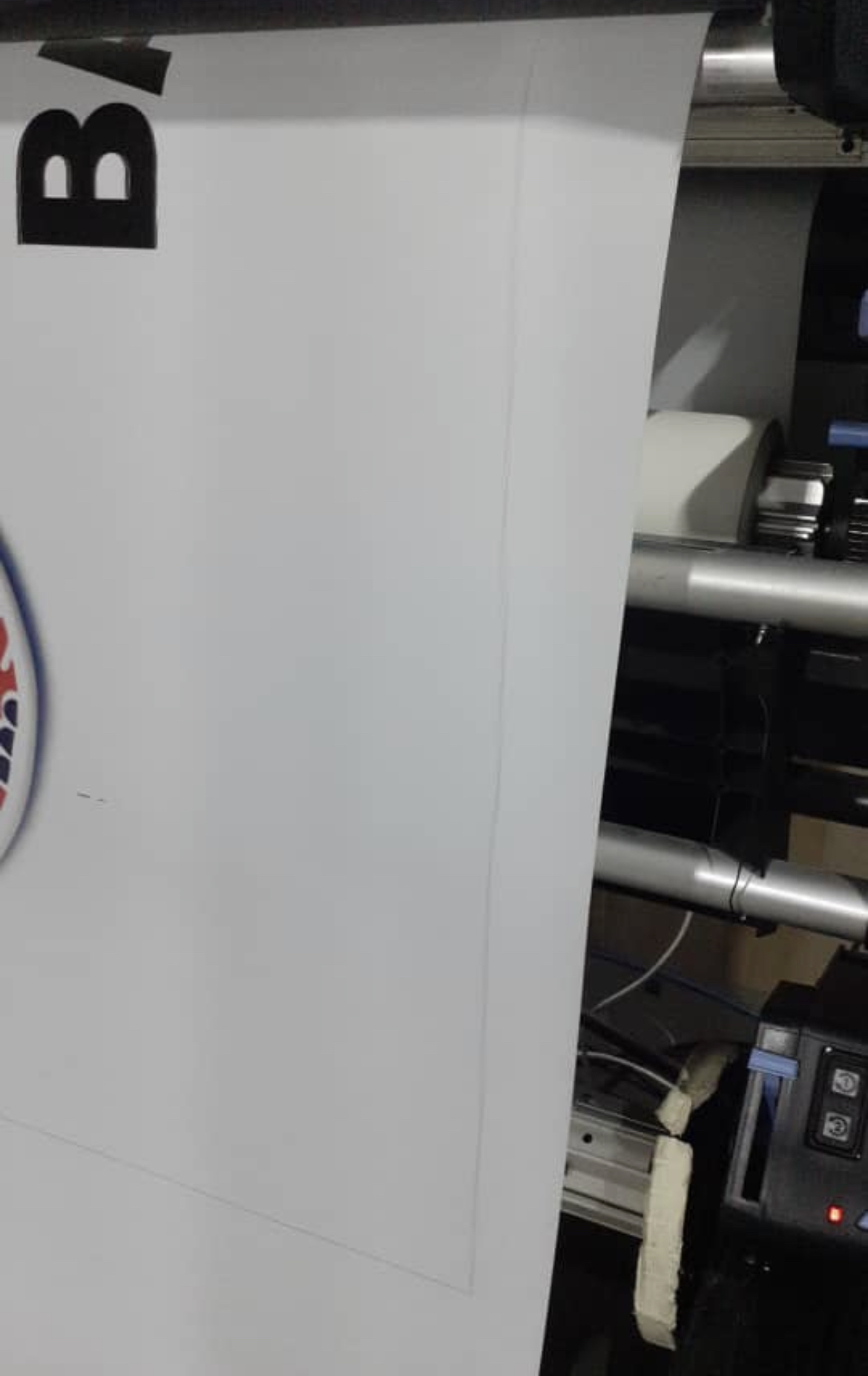

Hello my dear friends
I have problem with my hp latex 360. It prints very dissapointed me. It is printing in not correct line and tend to go right. For information, I use onyx postershop 11 as RIP. I had have cleaned enconder strip..but the problem doesnt solved
