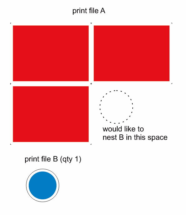

We have several designers dropping multiple print files into a hot folder for the print tech to print thru his RIP station using Flexi Production Manager. Is there any way to nest any of the files into the white "dead" space of other print files? i.e. three pre-nested 18 x 24's from one designer will have an empty space but Flexi won't allow use of that space for any smaller files. Kind of a pia to do manually from a designer.

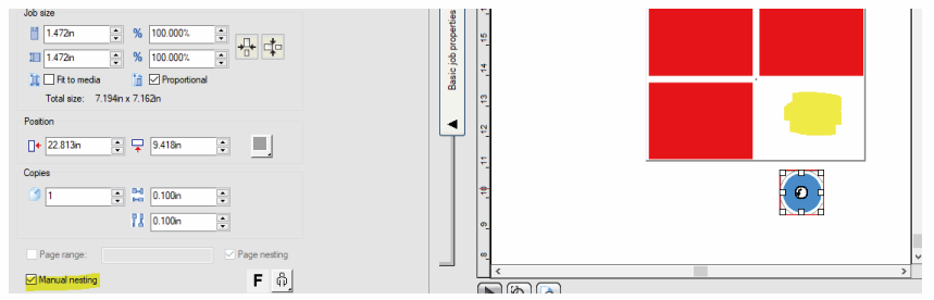

There is a check box on the bottom left corner of the layout window that is labeled, "Manual nesting". Make sure that is checked and you should be able to move them freely. It doesn't let you overlap though.

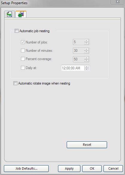

bannertime
So we haven't experimented with this yet, but you could try the Auto Nest in the Setup Properties. It should only nest jobs that have the same presets, but no promises. Not sure how big your setup is, but you could "Duplicate Setup" and have them designated for banner, sav, etc. Each duplicate can have it's own hot folder. Then auto nest would for sure nest similar jobs.

Just as I suspected, he's already using that method. Won't allow it. It would be nice to have an option to "ignore white space" or something to that effect.

Yeah I wish they would add the feature to the RIP layout screen instead of having to do it in designer. If those red squares are able to be sent as single jobs and then nested it should work the way you want it. If they can't be sent separately, you're out of luck.
