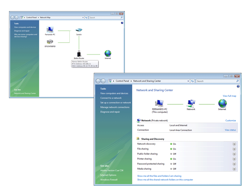

You will now have a new ipaddress. If that does not resolve the ip issue or network mask issue then you may want to make sure you can see the network device and the shared setting in the control panel. Here is an example attached screen shots from the Control Panel.
