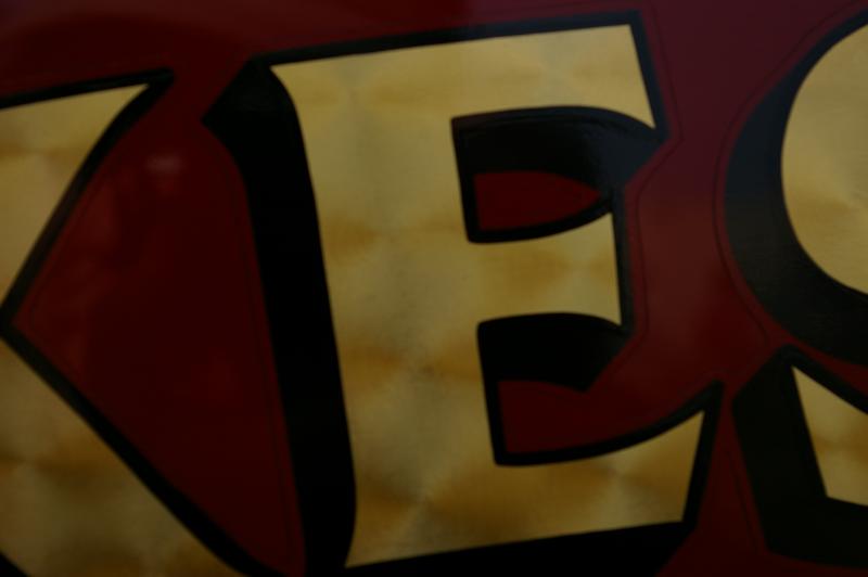

So, I get called to one of the local ambulance groups to quote redoing a couple of their vehicles. They are merging, so the graphics will be much more basic - black and gold reflective. Boring, I know. But, I have to strip the existing stuff which I thought was going to be a problem. It was done by a well known local who has the corner on fire departments for his hand done gold work, and this appeared to be no exception - hand spun gold with a black drop shadow and a clear coat. Or is it??

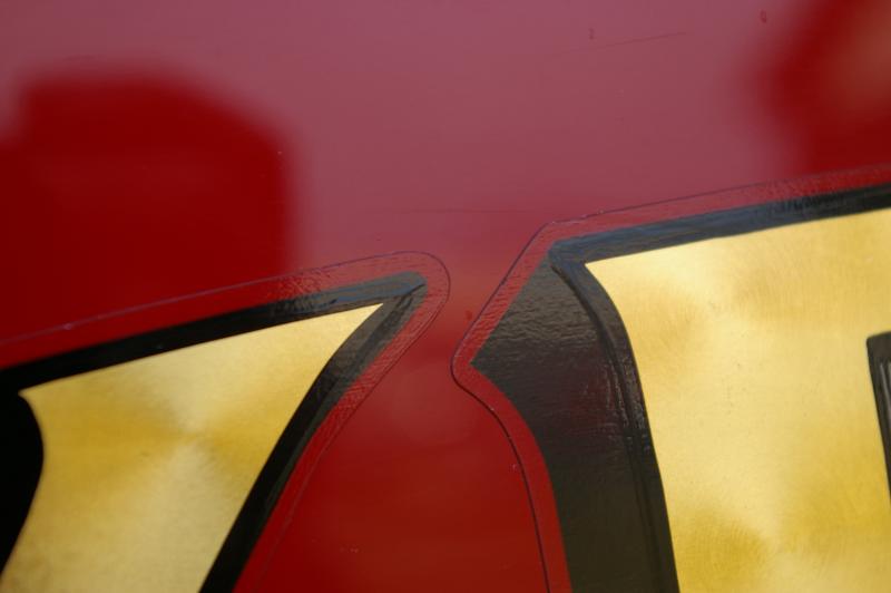

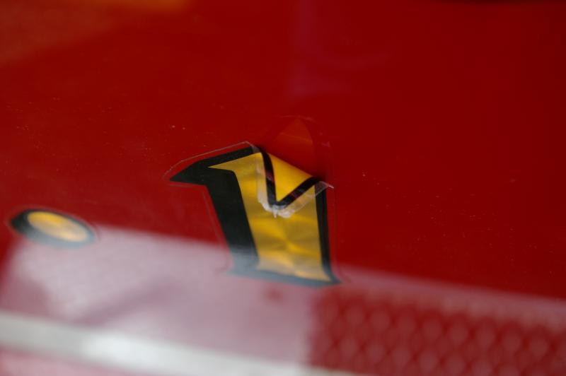

The gold is clearly the real deal, hand spun. The rest, though, is a mystery. What I thought was a brushed clear over the copy turns out to be computer cut clear vinyl, with the gold and the black reversed on the backside:
It's very weird. Under the clear I can see where he touched up some edges with some black paint or ink, but other than that there is no visible edge to either the gold or the black under the clear. I can't figure out how it's done, and I can't dissect one of the letters until I get the job. Anyone have any ideas of how this may have been achieved? It's something I'd like to offer - it's very classy and looks way better than using the SignGold (which this is not).
