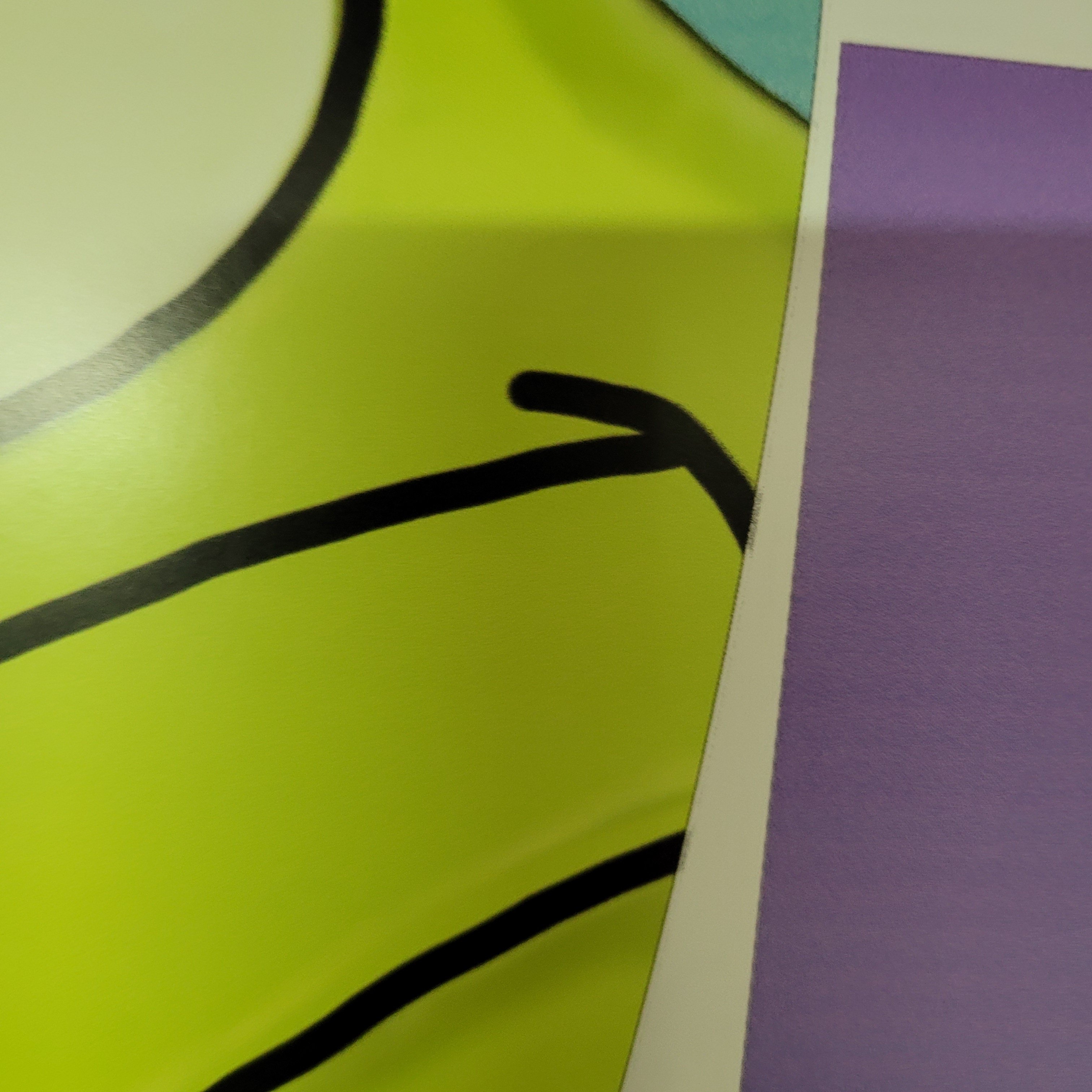

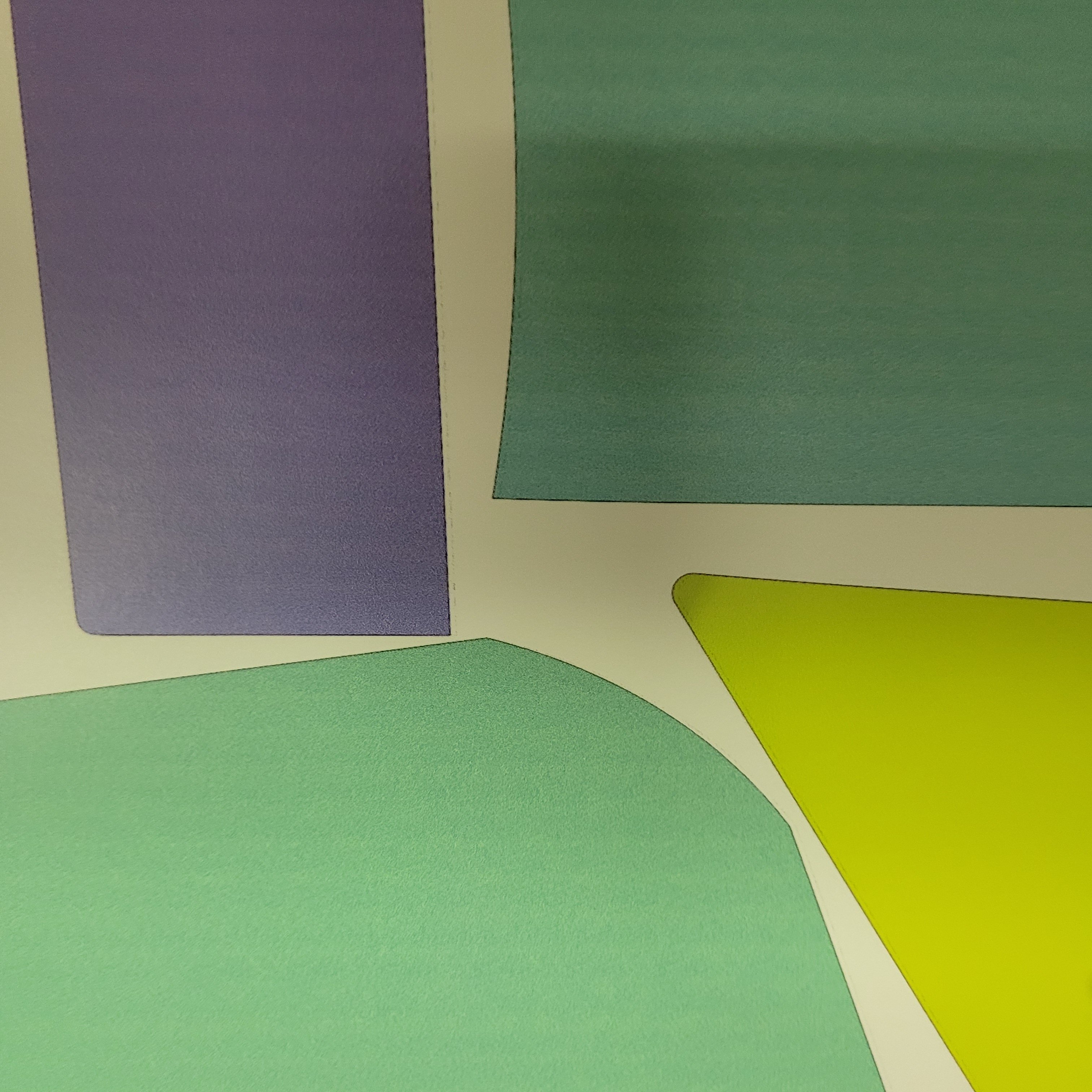

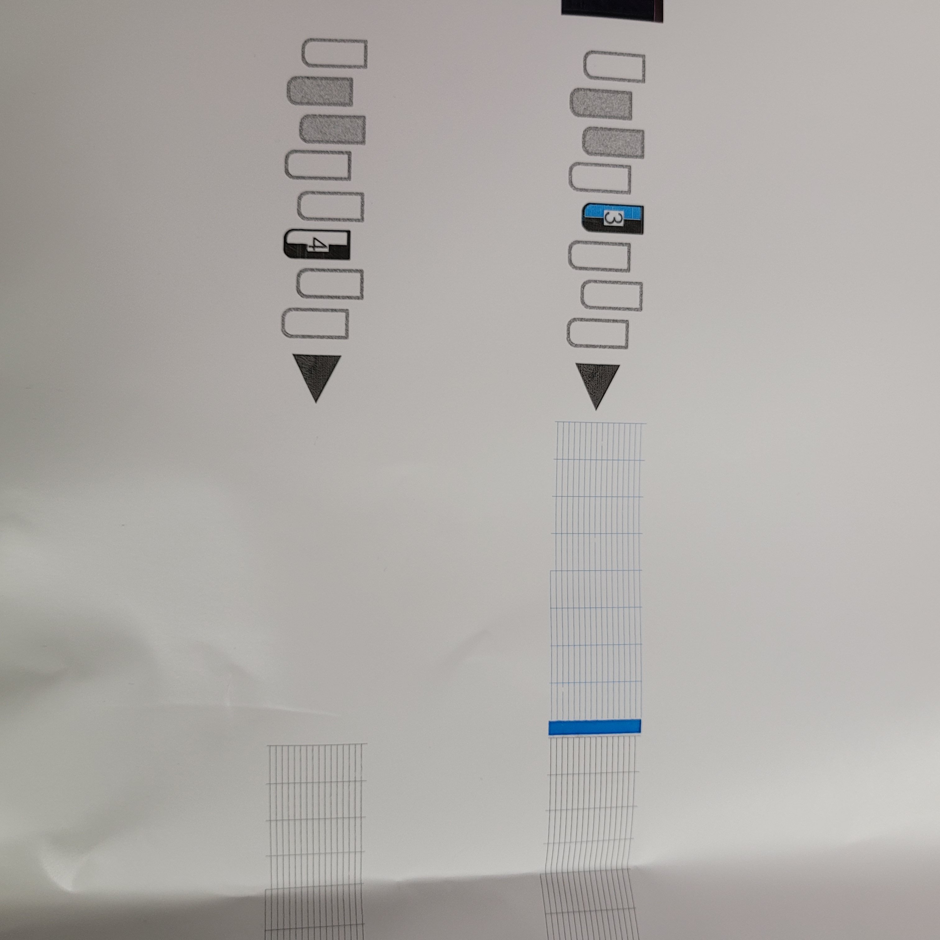

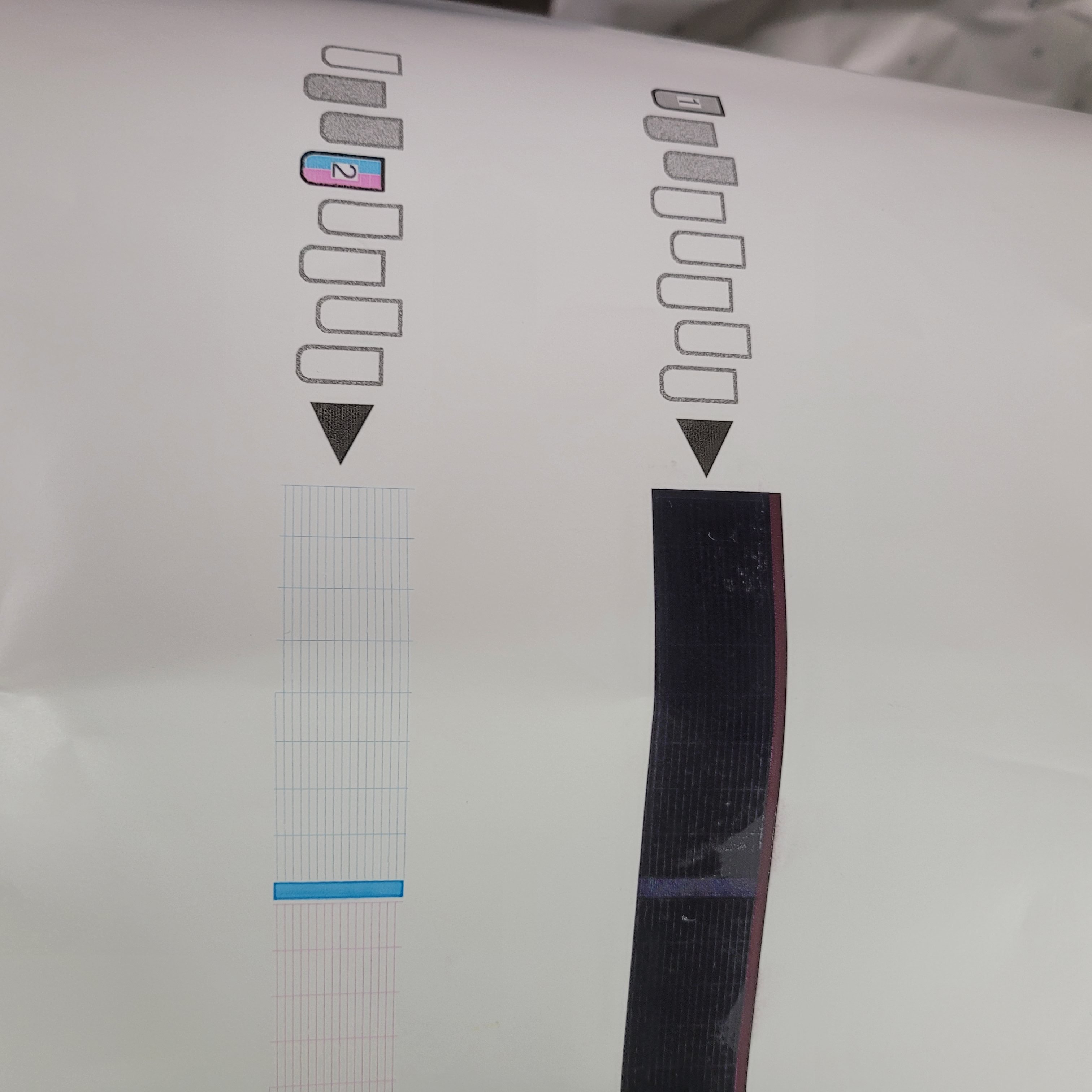

Not sure why but certain colors have developed a banding issue. I did the nozzle check plot and replaced 2 heads although they weren't really bad. Aligned heads and tests plots seem fine. Cleaned mulriple times. This may have started after replacing the cyan cartridge last week. Could it be a bad cart? HP 360 printer.

Take a look at your head 4. Now compare it to 3. Both should look the same.
4 is completely missing cyan...
Yikes, It was so clean i didn't even notice it. If maybe there was a little cyan showing it would have seen it! I replaced this am and its 90% there. Still some slight banding after head cleanings and alignments. Just odd how brand new printheads still show some bad nozzles in the service screen. Thanks
