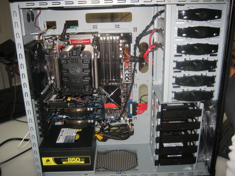

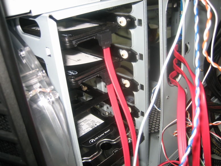

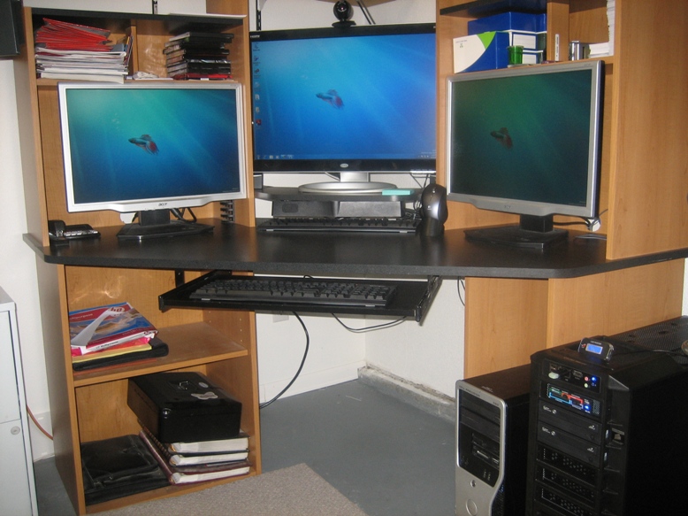

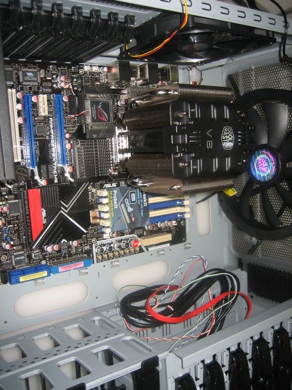

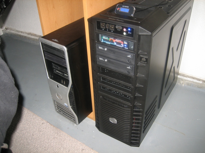

I changed a couple of items from the above list for the final build, here's what I used...
CoolerMaster Full size tower
Corsair 850w power supply
Intel I7 920 CPU
CoolerMaster V-8 CPU cooler
ASUS Rampage II extreme motherboard
Corsair Dominator DDR3 ram (12gb)
2 - Envidia 9500GT GPU's
2 - Intel x25m 80 gb SSD's in Raid 0
1 - Western Digital 1tb 7200 rpm drive
2 - DVD rw drives
1 - Multi card reader
1 - 26" monitor
2 - 22" monitors
Windows 7 64 bit (beta)
The build went good, turned out very nice, with clean wiring. The cost went up a little from the initial also...it was $2650 without monitors. This case has massive cooling fans, and tons of room inside. Once I get comfortable with it, we're going to do a little overclocking to see what kind of performance improvements it will make. See attached pics of the build...

choucove
Very nice computer setup, I like the monitors too.
I think your pictures led me to an idea of creating a "Post Pictures of your Machine" thread to show off what you are rocking for your main system. Might be a fun thing to share in the general chat.

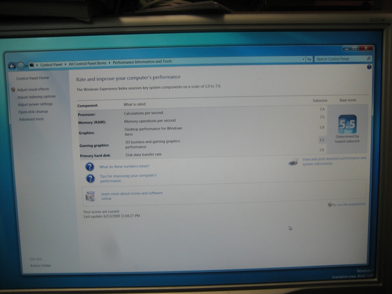

I do plan on using this for graphic design, photoshop, flexi work. I'd like to play with the overclocking a bit just for the experience mostly. From what I understand, the I7 920 can be overclocked a reasonable amount without sacraficing reliability...This being said, I'm not dumping my heart and soul into this as my "official" business computer, with the beta Windows 7 64 bit and all, until it's been tested, and working good. Can't be much worse than waiting on the old system to load all 7000 fonts , and multiple photoshop plugins in Flexi, not to mention having it crator every time I try to modify a 250mb file...
First test so far was the time it takes to open Flexisign 8.5, it was 62 seconds on the old Dell with a Quad core processor, and 4 gb ram. it's 10.2 seconds on the new build!
