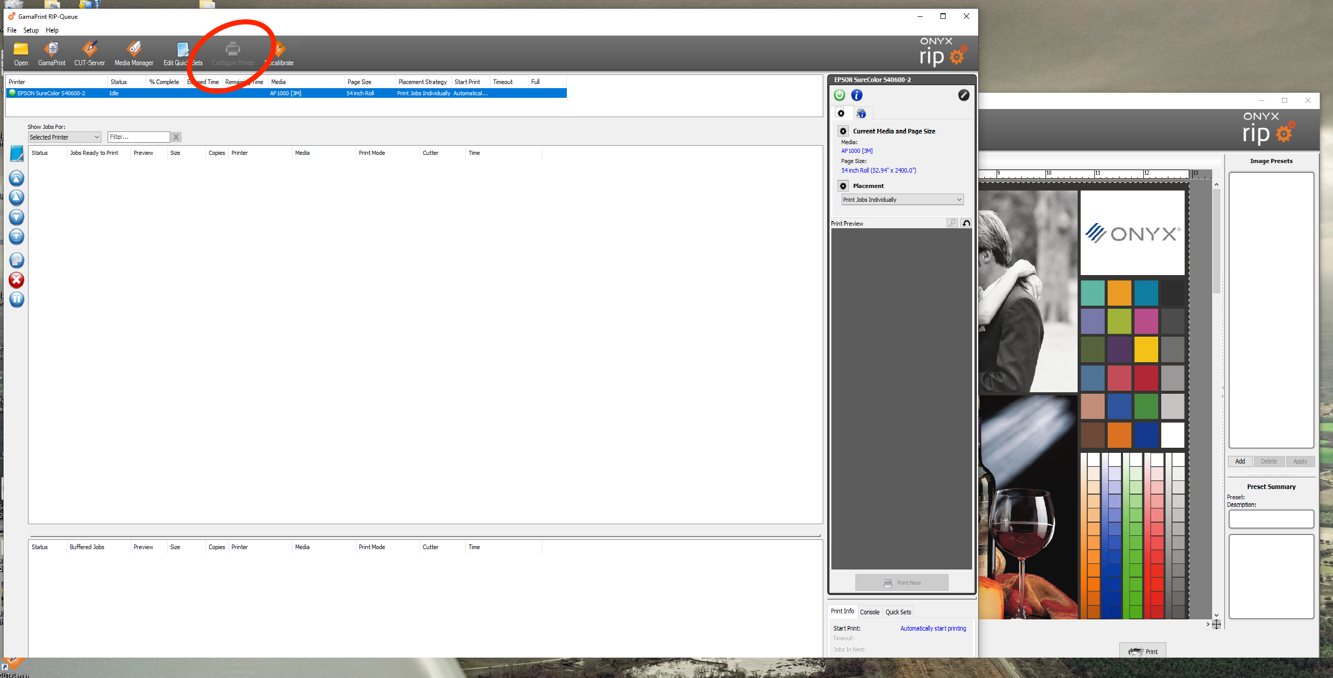

Hi, we just purchased a new Epson S40, and Onyx Gamaprint 22 was bundled with it; I'm coming from a Mutoh/FlexiPro combo for about 13 years, so I feel like a total newbie again now, lol...

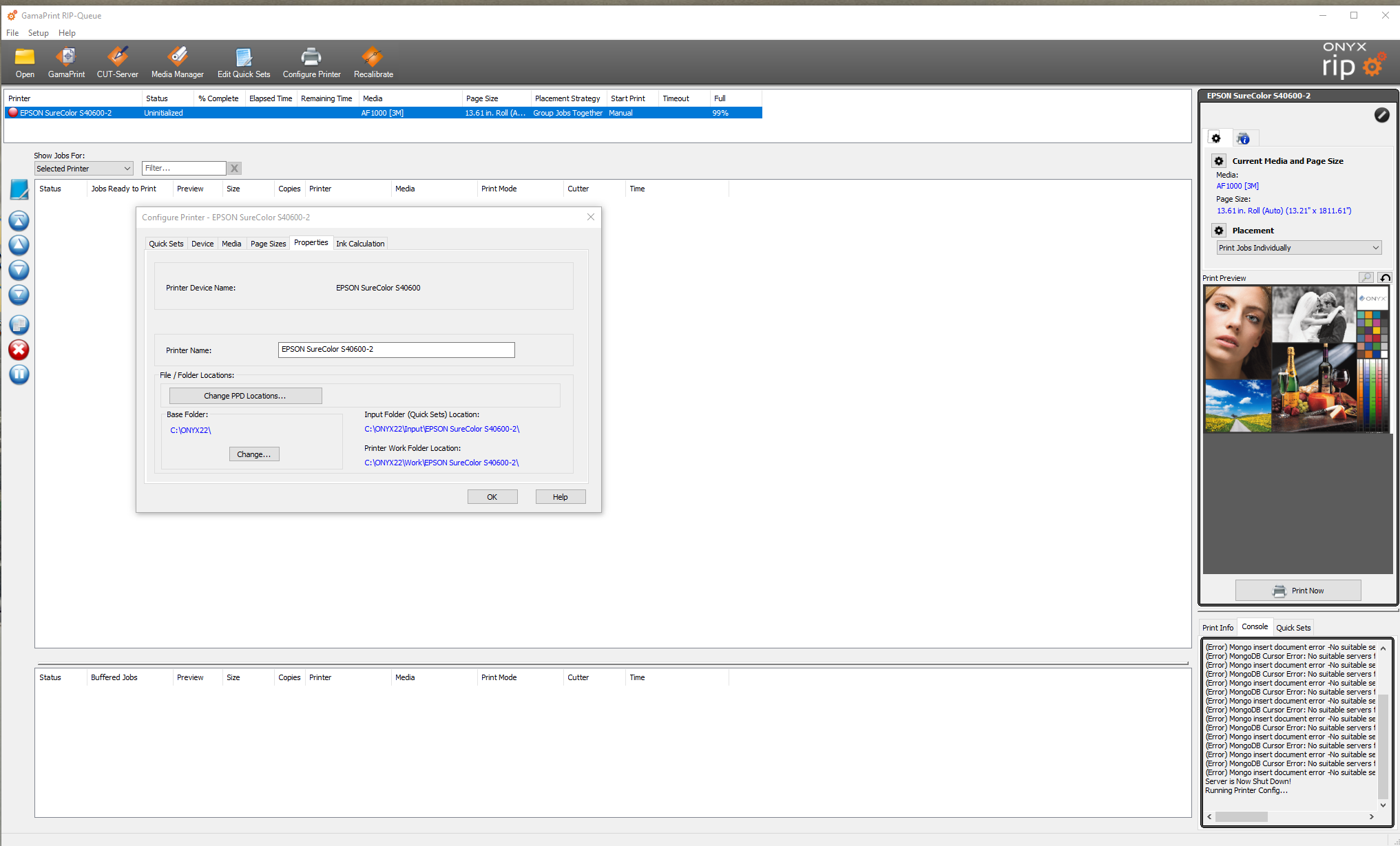

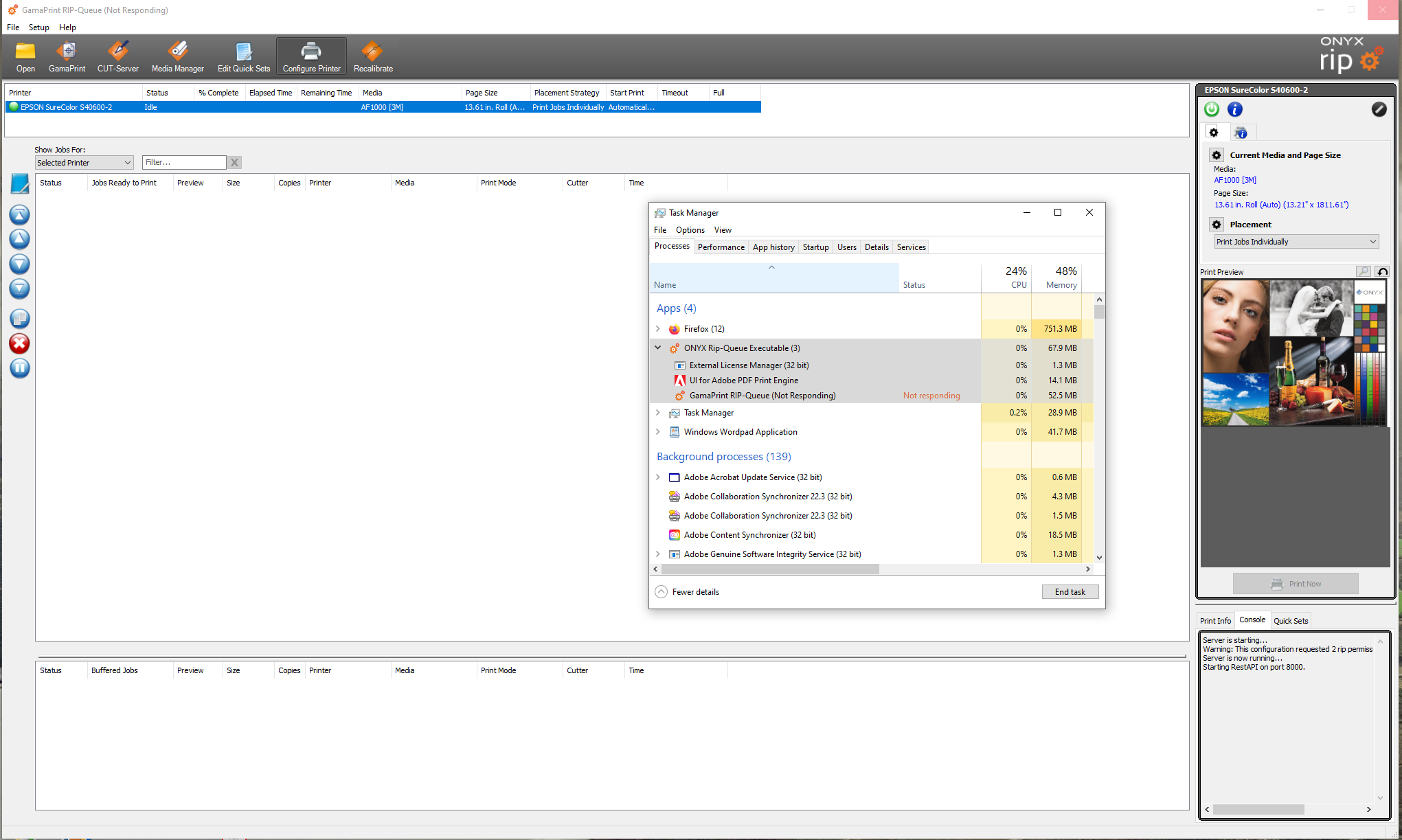

I followed installation instructions best I could (somewhat vague / didn't match up) and the printer IS connected to the computer, is being recognized and communicating in both Epson's Edge Dashboard, and in Onxy's printer setup; however when the RIP/Queue program opens, it is functional for about 15+/- seconds or so, up UNTIL the "configure printer" (see screenies) button comes alive, then the program locks up and/or crashes. In those seconds I can also try to open a file to print, but it doesn't add it to the queue or open it.
I realize I may have missed something important, or bad program....? I uninstalled/reinstalled, and explored everything I could see. Running Win10 Pro, 64bit so should be compatible.

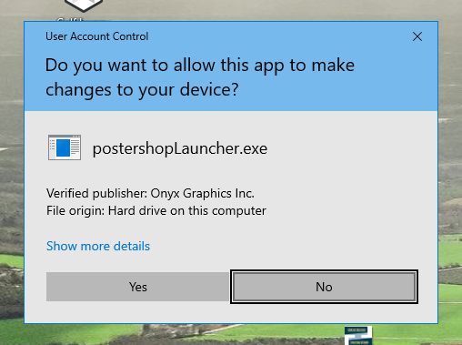

It also pops up Windows UAC warning box on every open, which is odd.
I'll see if I can round up some tech support tomorrow but thought maybe someone else has had the same issue in the meantime.
I'd love to continue using all 10+ previous years of Flexi files for this printer but am not seeing it in SAI's list....which isn't huge and I don't mind learning a new program, but would be nice to stick with a familiar program for now (even though it still sucks as much as ever :D).

Always hit "Yes" on the UAC warning and set it up to always "run as administrator".

Yes I press “yes” otherwise it doesn’t start, and I have run it both ways as Administrator and “regular”.

Console before Configure Printer comes up...
Server is starting...
Warning: This configuration requested 2 rip permissions. There are only 1 available.
Server is now running...
After Configure Printer comes up (and locks)...
Starting RestAPI on port 8000.
meltsner
Testing some more, I can actually wait about 30 sec. till it actually "unlocks" and I can click any button only one time (then it locks up again...grays out / spinning icon) but whatver I click actually DOES come up about 30 seconds later, such as the Configure Printer button. It's a whole new set of errors too.
