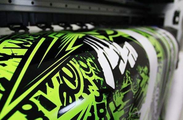

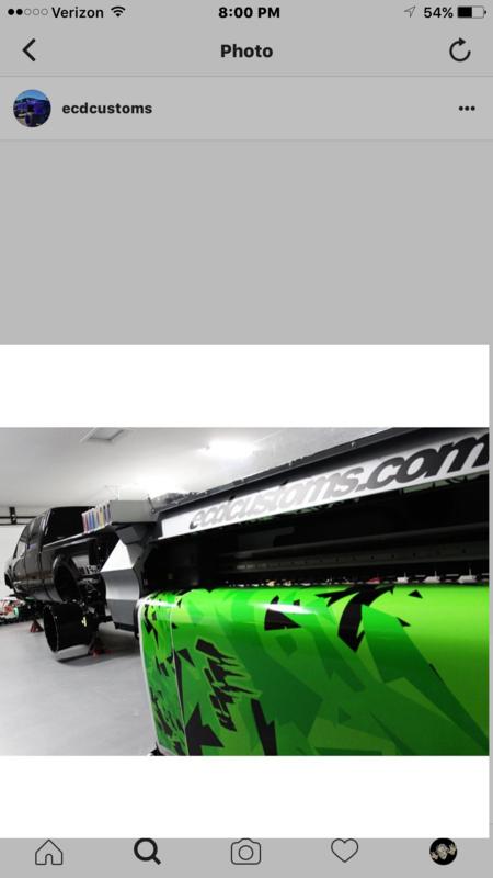

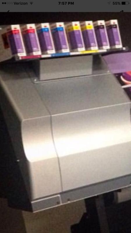

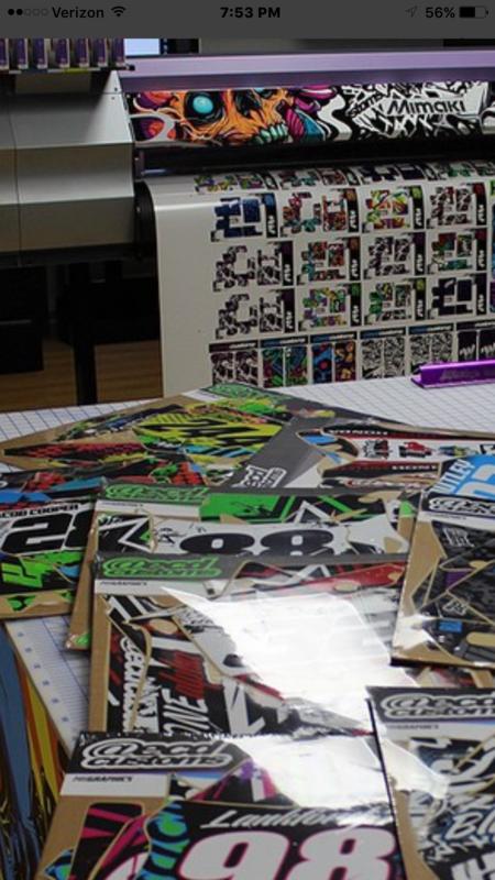

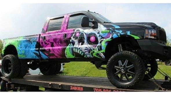

Yes you are very correct on the hard time making a decision. Dropping cash on a full shop setup st one time should be hard for anyone to make a decision on. The issue I come to is color. I know as soon as i say all this I am going to have color management people tell me it's all about profile. Ow I do understand that but you will. It get the colors out of any Roland or mutoh or any other printer for that matter if it doesn't have the same color combination. The company uses 2 mimaka I think that's right. Both set up with dual cmyk????!?
We have a very dull color market around here. You never see anything bright or anything that really stands out more than the rest. Now it may be profiles, it may be printers and it may simply be the designers but there is a huge market for brighter and bolder here. I will attach a couple pictures that I fell in love with a while back simply because of the colors. There is a demand for it but hardly no one does it.

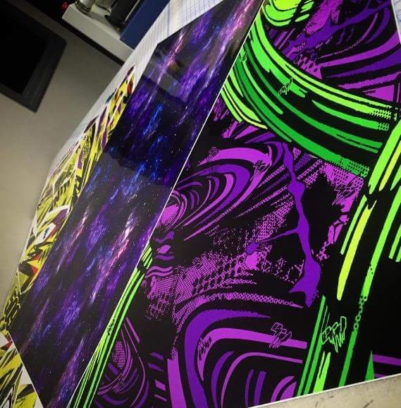

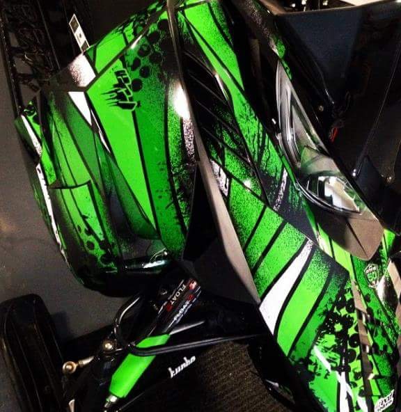

Company is out of canada so I don't mind their name here is so I'll remove pics. The greens they get at out of this world. Yes I may be picky and thinking above what can happen but someone is doing it??? I looked to see if I could find the printer on Mimaki site but did not. Thanks again for all the help everyone.

Yes, it is all about combination of ink, substrate, profile and designers ability. I think most important thing is ink itself. Higher the pigment load in it easier to get bright colors, but the other hand it creates problems to the printer like clogged nozzles, build-ups in pumps and lines etc. If number of colors less (like 4 colors) easier to get bright solid colors but difficult to get gradients, in other hand 8 colors or more have more color gamut good for photorealistic images but difficult to get extreme brights. I'm not saying it is not achievable but you might need help from specialists to make profile correctly. For example, if you need red color on 4 color printer you play only with M and Y, but 10 color printer you need to adjust M, Y, Lm, and R. I had Mimaki's JV3, JV4 and JV5. But don't mislead by this pictures, it has increased contrast.

Keep in mind that if these happen to come off of Instagram, they could easily have a filter done to them to make them look super bright!
altereddezignz
The pics i posted on here yes are off Instagram. WE looked at several of his wraps in Florida last year at a show and i have seen many of his builds at Sema. They are just as bring in person as they are online i promise you.
I have sent a message just asking a couple simple questions hoping they might give me a little incite as since they are no in the us, But you never know. I just know i have never seen prints like this in the us from a printer using CMYK Eco solvents. If there are some i have not found them yet.

Im a mimaki user and can tell you my machine can not come close to hitting the same colors as an s80600

Well after this comment i am simply at a loss. I mean am i looking for something that doesnt exist?
I mean is there a way to run like a bright green and orange on the Mimaki printers to acheive what they are? Like a CMYK Green, Orange or something like that?
