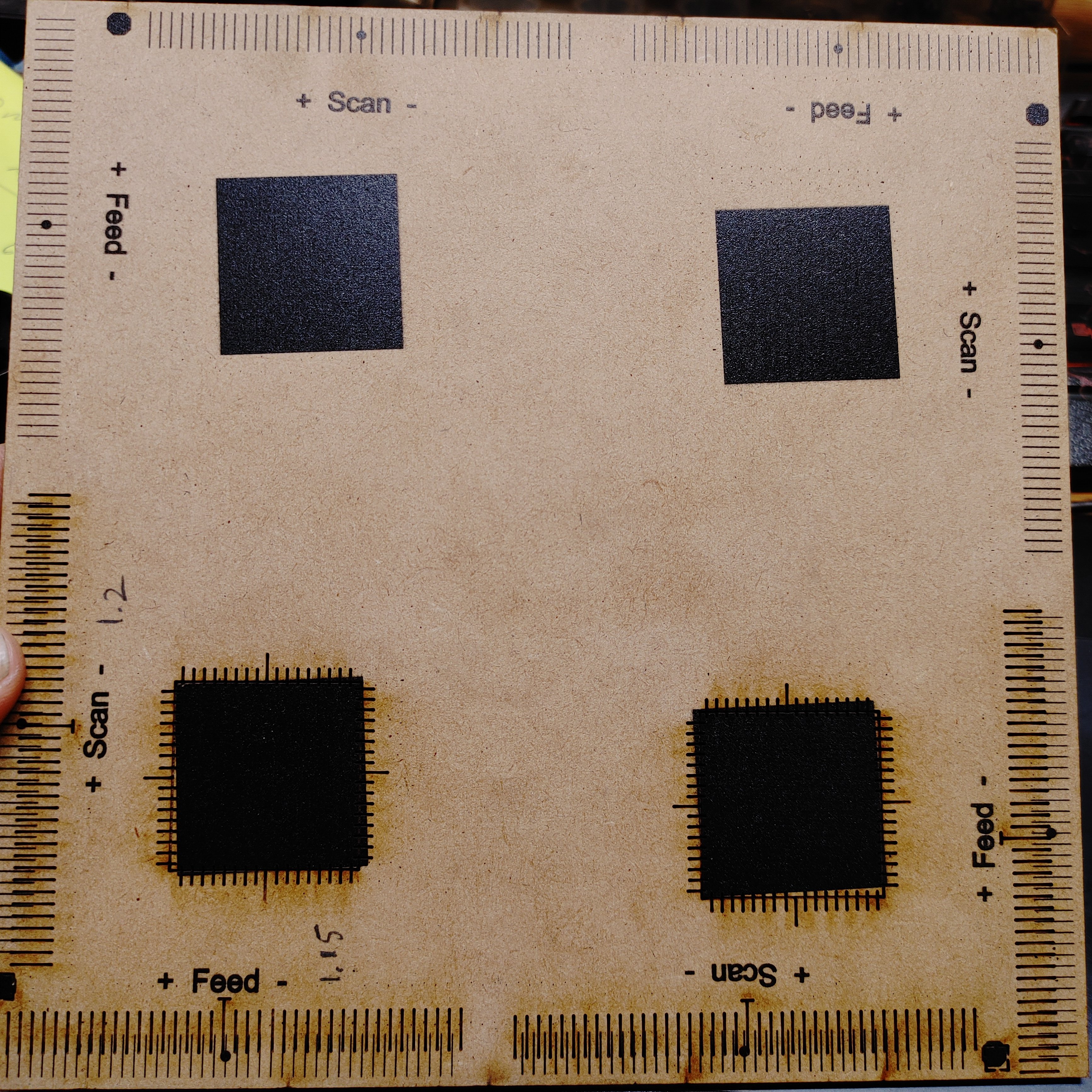

Making jigs can be a little annoying but certainly are worth the time. We tend to use 3mm mdf as it's cheap and as long as it's kept flat works pretty well. We also use lasers in our shop and one thing that we figured out pretty early on the zero point on the lasers and the zero point on the printer where not only on opposite ends of the unit but there was a few millimeter offset. My boss came up with the idea to make an alignment ruler where the feed and scan lines can be printed in 0.1mm intervals and then that same file has twin cut file you can run on the laser and compare marks and adjust the printer file to match the lasers. I'll try to attach a picture of it

Thanks, NathanR for the attachment, it seems pretty cool. We will check this as we also noticed a little offset that can cause problems.
