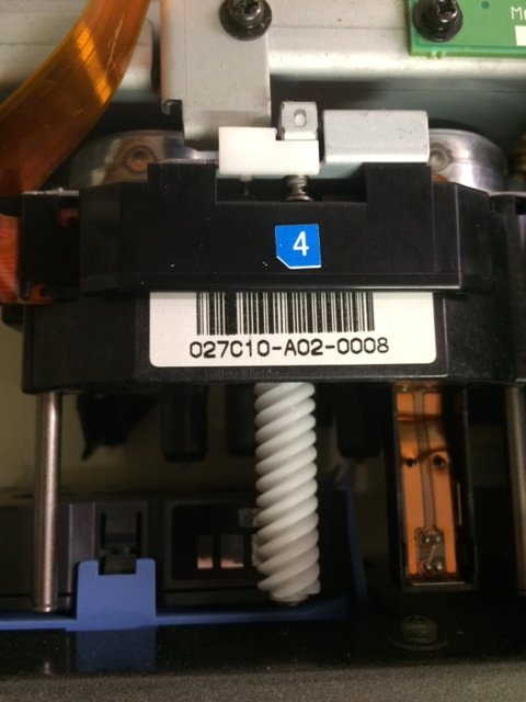

Hello There, please tell me what model of printhead and I look for the TEI File on my PC files
Otherwise, look well the printhead? Could you put any pic from it?

Roland PC600 print head
Hi College Freshman, Thank you attached a a picture of the new print head. That would be great if you have the file for it.
Thanks in advance.

Hello there, sorry but I have not any TEI file for that Print Head Serial Number, the supplier has not any information about of the Voltage?
