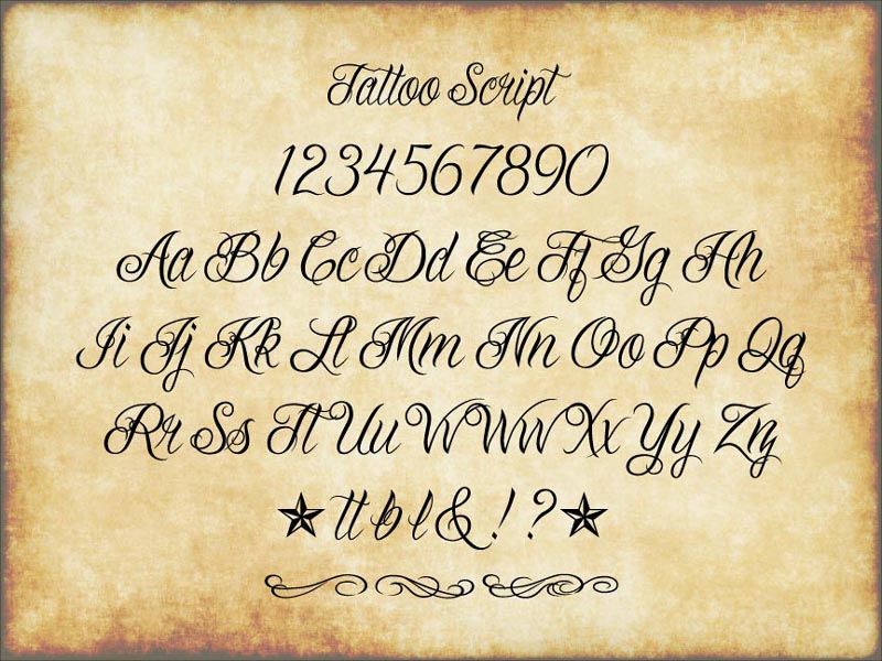

New script font/s I'm working on.
I started working on this Tattoo style script about 2 months ago. I still have a lot of tweaking to do, but it's close to completion. I'm pretty excited as it's the first script font I've worked on and it took a lot of work to even get to this point. Having been a tattoo artist, I find it frustrating to try to find an authentic tattoo style script font, so I decided to create one. Let me know what I can improve on and anything that doesn't jive and I will take your ideas into consideration.
Once I'm completely happy with this, I plan on doing one or two modified versions. I also plan on adding a few more ligatures and flourishes to finish it off, but I'm still trying to figure out how I want to set up the flourishes. So far I used characters such as /,\,and | to place the flourishes under the main copy without adding additional space between letters, but I may just create it as a clipart style font so flourishes can just be moved around and placed manually under the copy wherever desired.

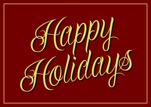

That is really nice. I like the Christmas one.
If I could make a suggestion, I would like the choice of using the lower case "n" you have, or an additional lower case "n" with the first stroke flaring to the left at the bottom instead of the right. But I would like both options.
Again, really well done!
Thanks.That's a good suggestion. Maybe a lower case r that ascends all the way to the baseline wouldn't hurt either.

I would also like every lower case letter with an extra fancy bit, a second version that is simpler, without the tail. Like the lower case a. I could also edit what I want as I go, but it would be nice for me to be able to choose between fancy and plain.
Or maybe it is 2 separate fonts that I could mix and match.
I also think the number 0 looks too round, and perhaps not quite symmetrical. Or you may have it the way you want it.
The a is different in your samples than the font set?

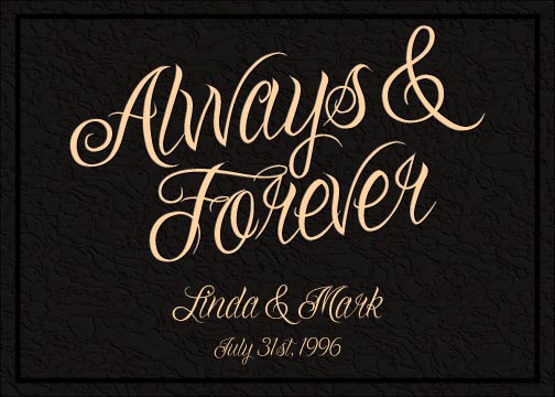

It is a really nice font. I like how the people's names look. Very classy.

The software that I use allows individual kerning pairs and has a test feature with several default phrases such as pangrams, latin and english phrases and also your own editable text. But individual kerning pairs on a script font with connecting letterforms is typically unecessary for reasons I won't bother to get into. I will say that kerning becomes more geometric than it becomes a matter of negative/positive space relationships, similar to monospaced type.
The number 0 is just plain wonky like a few of the other characters that haven't yet received enough attention to detail.
I'm not sure why the a looks different in the samples. My business partner looked at them and thought he saw the same thing until he looked again and realized that they are the same...or at least he agreed with me to agree with me. I'm not entirely sure he was convinced, but no...the sample letterforms have not been adulterated in any way aside from adding a fading contour on the tattoo sample to make it look more natural like a tattoo. you both may be seeing some sort of optical illusion but they all look the same to me. Are you referring to the uppercase or lowercase a?

After close examination, the lower case a is the same. I think the shading and different colours make it look more open at the right side by the ascender.
striper14
looking good...still a bit of work to do tho...only really obvious flaws i saw were the uppercase C which is too vertical & the zero is too fat imho...great work tho
