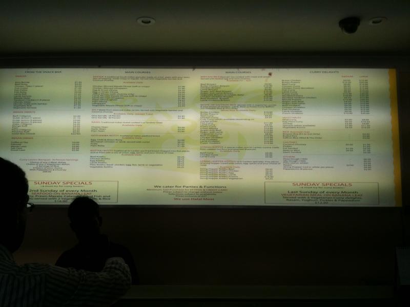

Hi Guys, greetings from Sydney, Australia. This is my first post. My business has expanded from embroidery to vinyl decals and am now getting requests for larger signage work. My question is about a backlit menu board in a restaurant. The client wants to update the pricing/menu information, he will be providing the new artwork. It seems to be a full colour print, so I will farm the job out (as my roland cutter will not do for this). My question is (and please remember i'm a complete newb to this), how easy is it to install the new graphic in the lightbox. The pic I have provided is not the best quality (apologies). Is it along the lines of unscrewing the face and replacing the graphic? Is it actually an adhesive? I'm guessing it's hard to tell from the pic what type of system this is, but maybe I can get some advice on how to check the lightbox and see what i'm dealing with. Thank you :)

first thing, is whomever did it before did it wrong! the bulbs should NEVER create hot spots on face when illuminated.
the easiest will be to get a new blank face and install the backlit printed vinyl to that.
removing the old vinyl usually takes more time and hassle than it would be to buy a new blank piece and start from there.
Why can't you use your plotter? granted there will be LOTS of weeding.
from the image there is only 2 colors, or is there more colors off image?

Thanks or the response. Much appreciated. When you say 'blank face' are you talking Perspex/acrylic sheet? Is there anything I should know about what type to get?, and i'm assuming I will find screws on the box where the face comes loose.
Also when sticking the backlit printed vinyl, is it stuck on external or internal of blank face?
Yeh, I considered using the plotter, I guess it's possible. In the centre of the image there is a light green motif pattern behind everything, which I thought might be tricky.

really hard to give you any good info based on those pics. cant tell anything about it really as far as the construction of the sign

Most of your questions will be answered by performing a standard site survey. Visit the site, bring some tools, see how the sign is manufactured, how it comes apart, etc. Measure the size of the face and as mentioned, sell them a new face with new graphics.

Some backlit prints slip in between a piece of opal and clear acrylic sheets, and others stick onto the front of opal.
You won't know unless you go there and pull it out.
Which you'll want to do to get the exact right size.
If you're just quoting at this stage try and get the owner to do it since they may only be price shopping.
